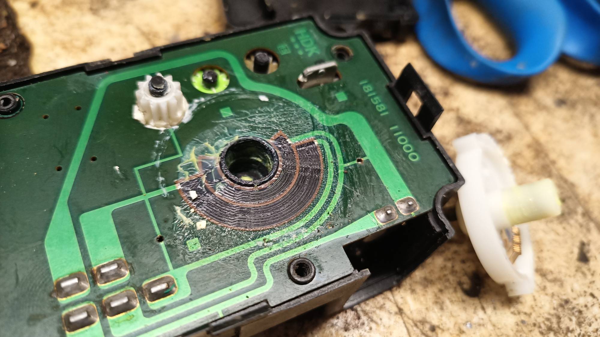

I removed the passenger motor and confirmed it wasn't turning. I took it apart, cleaned the old dialectic grease off the resistor area and checked it over. I coated the area with DeOxIt and reinstalled. It moved a few times and stopped. Not sure where to go from here.
Not sure if it's just the unit not sending the correct feedback signal or the climate control unit. I guess I'll have to keep poking around.

I found a newer obdii adapter and was able to do...something...with the motors after cleaning them internally. I don't know if any of the motor adjustment functions ever actually did anything, as the function always got stuck at 80%. But, I got everything working somehow.

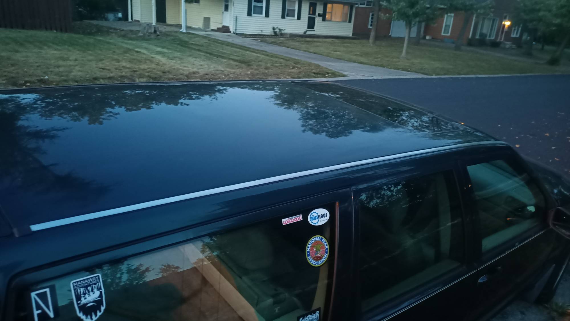

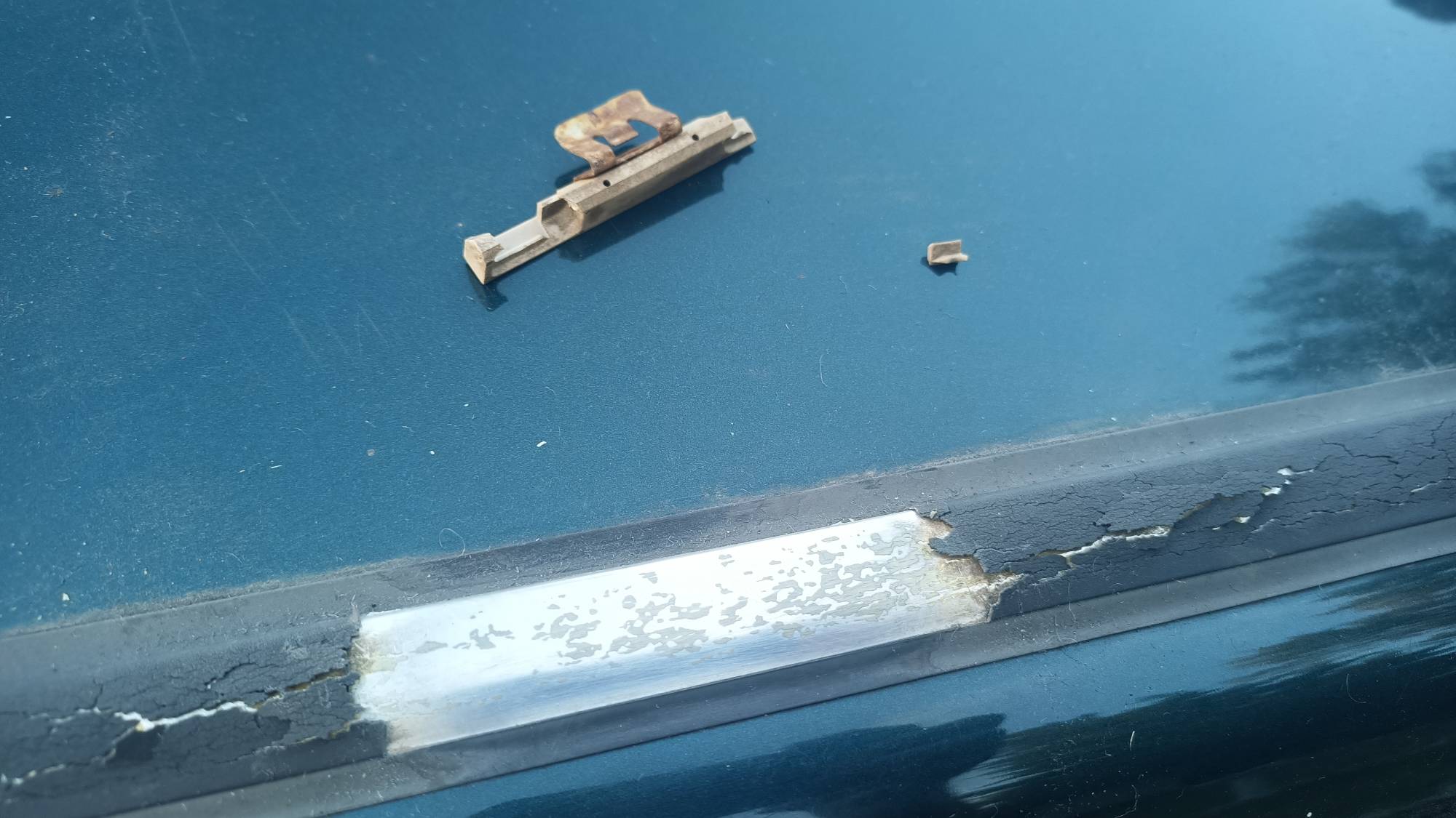

In other news, I got the cruise control working by "adjusting" the brake pedal switch / valve, and tinkered with the peeling plastic coating on the roof trim and replaced one of the clips.
Not sure if I'll paint these or leave them bare.
