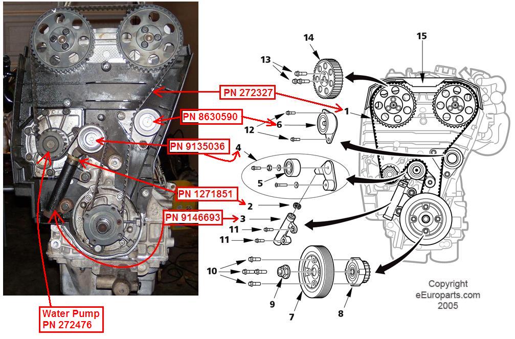

Post by cn90 »
Thanks for the excellent DIY. I am adding this picture of the Timing Belt layout for reference:
VolvoTiming Belt01.jpg (134.81 KiB) Viewed 3560 times
