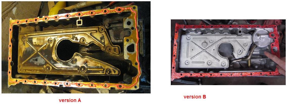

Question for the sealant guru: do you apply a bead (version A) or use a paint roller (version B)?
Also: how long do you let the sealant sit in open air before installing the oil sump back in the car?

Version B but there is way more on there than necessary. It doesn't matter how long you let it sit, it will do nothing at all while it sits in the open air. You can put it on instantly, or wait an hour.

Having used version B a couple of times, successfully, on the camshaft cap that was my inclination on the sump, as well. But the tech support at Permatex recommended a bead which was seconded by the O'Reilly clerk who also does car repair. Against my better judgment, I used the bead on the pan. I know there's way more on there than needed, but so far (very few miles after repair) there aren't any leaks and I don't expect any because all gaps should definitely be filled and bead surrounded all bolt holes. We'll see.
If I do this again, I will definitely use the foam roller approach because it's neater, evenly covers the complete surface and doesn't needlessly waste sealant.
