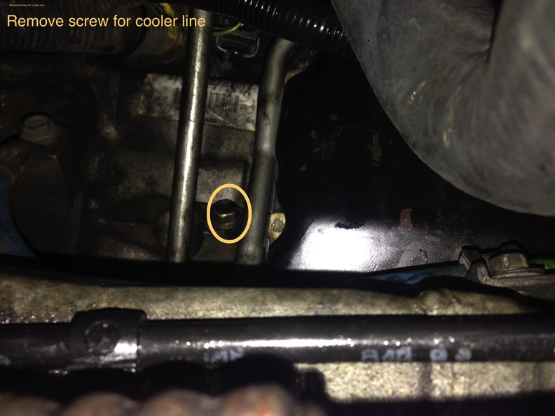

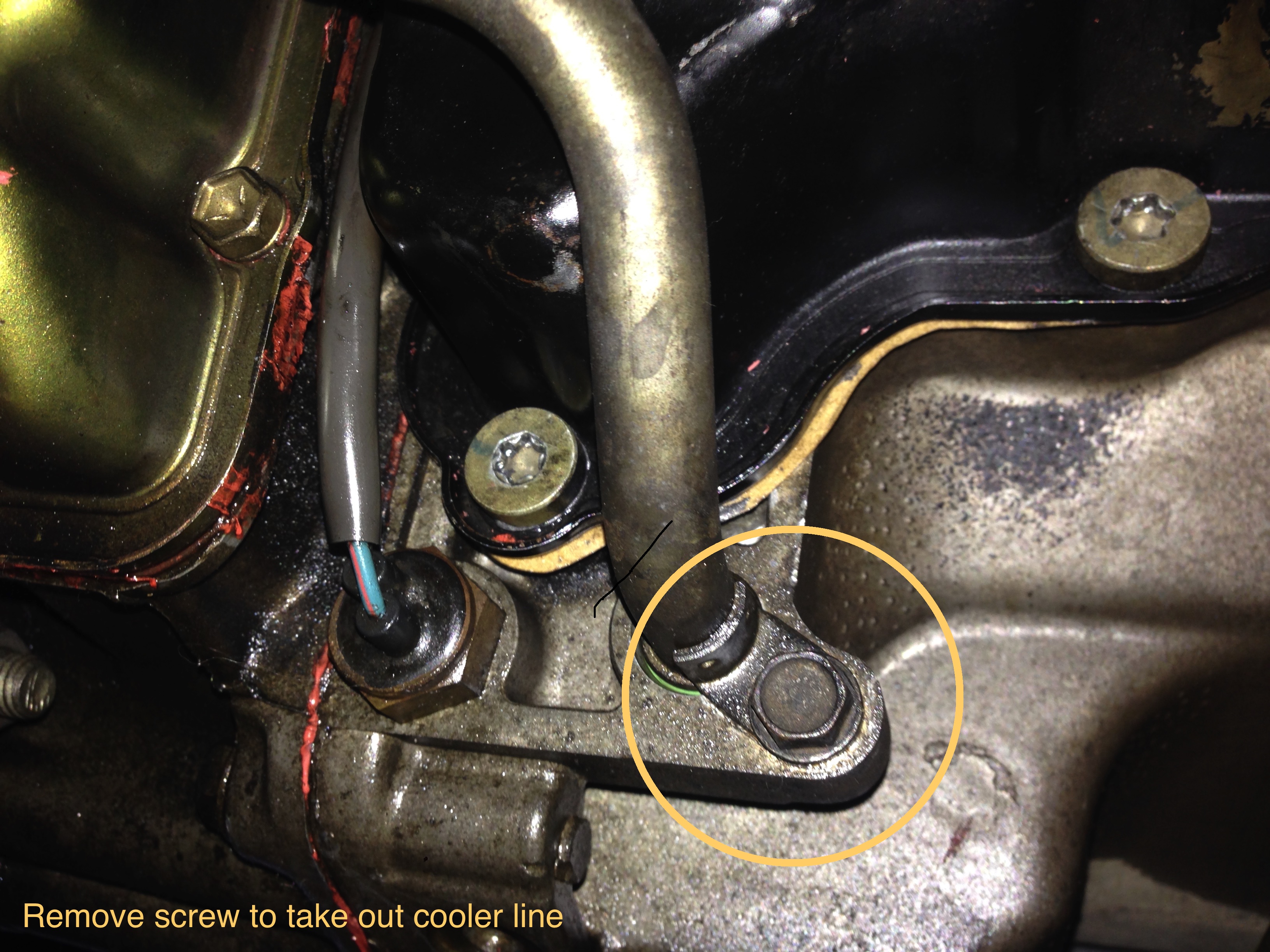

Cooler line: I actually had to remove this totally. There was no way I could get to 2 of the screws without taking it off. To take it off there are 2 screws. The first one is shown in picture 4, it is where the line goes into the transmission. The second is shown in picture 3, to see this bolt I had to remove the plastic air guide ( held in place with 2 nuts) at the bottom front of the car. Once I took this off, I could easily see the second screw to remove the cooler line. The cooler line on mine had a green o-ring where it goes into the transmission. Once the screws are out, just pull it out.

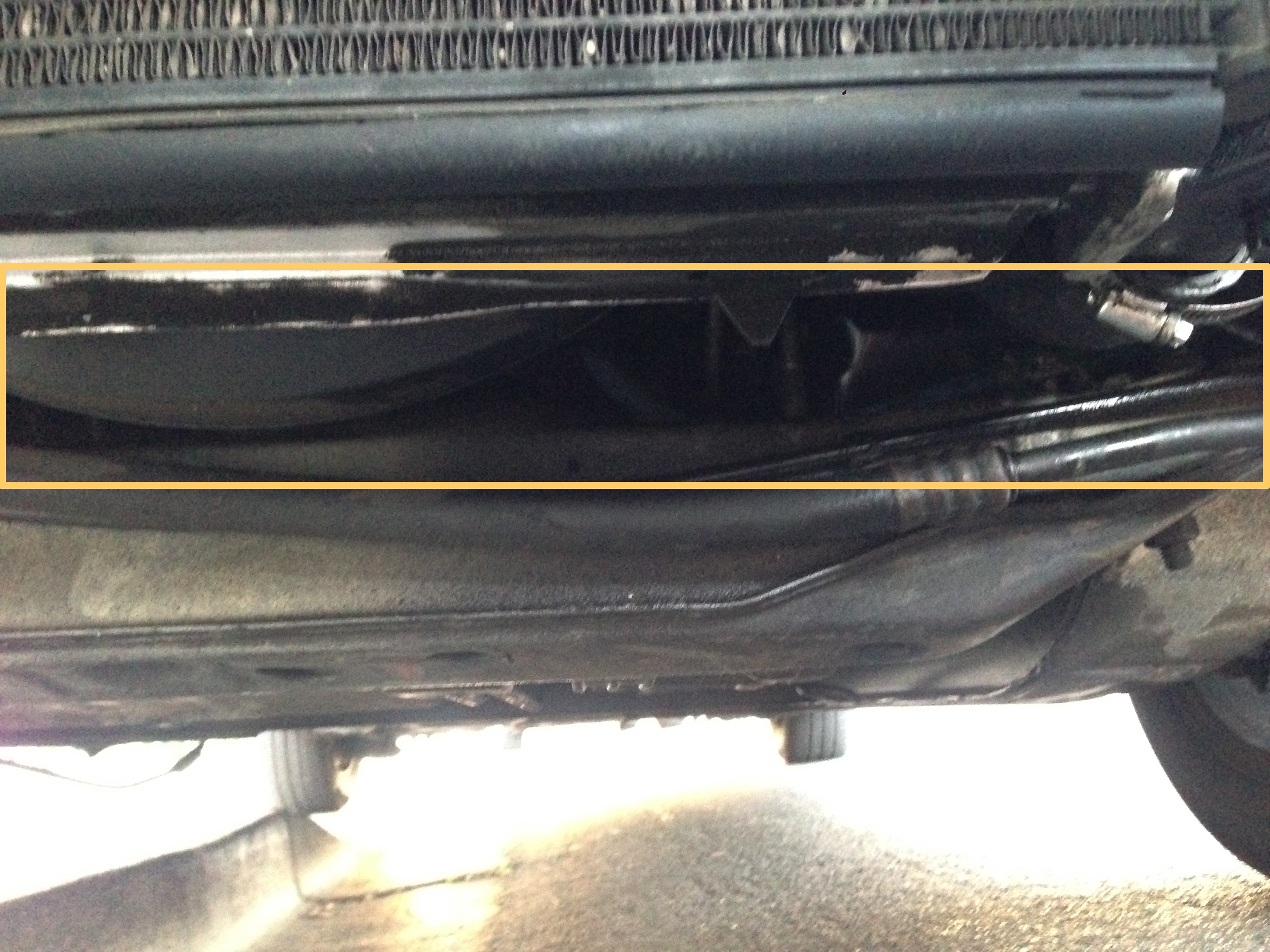

Also when you remove this bottom plastic air guide plate, you can get a good view of one of the hard to reach T40 screws, I used a long socket extension to take this screw out, from this angle it was very easy.
So one of the 2 hard to see T40 screws can be seen when you remove the bottom air guide plate. There is one more hard to see screw which is on the left side, the lower one of the 2 left side T40 screws is the one that gave me the most trouble. I had a T40 screw driver in an L shape which is what I used to get this out, while under the car.

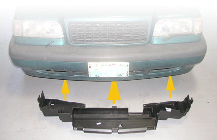

Picture 2 is the view you have when you take out the bottom air guide plate. The yellow rectangle is the opening you get.
Picture 1 is the bottom air guide plate I am talking about.

I knew there must be some way to remove that cooler line. I knew about the bottom 10mm bolt I couldn't see that 2nd bolt though so thanks for the tip.
