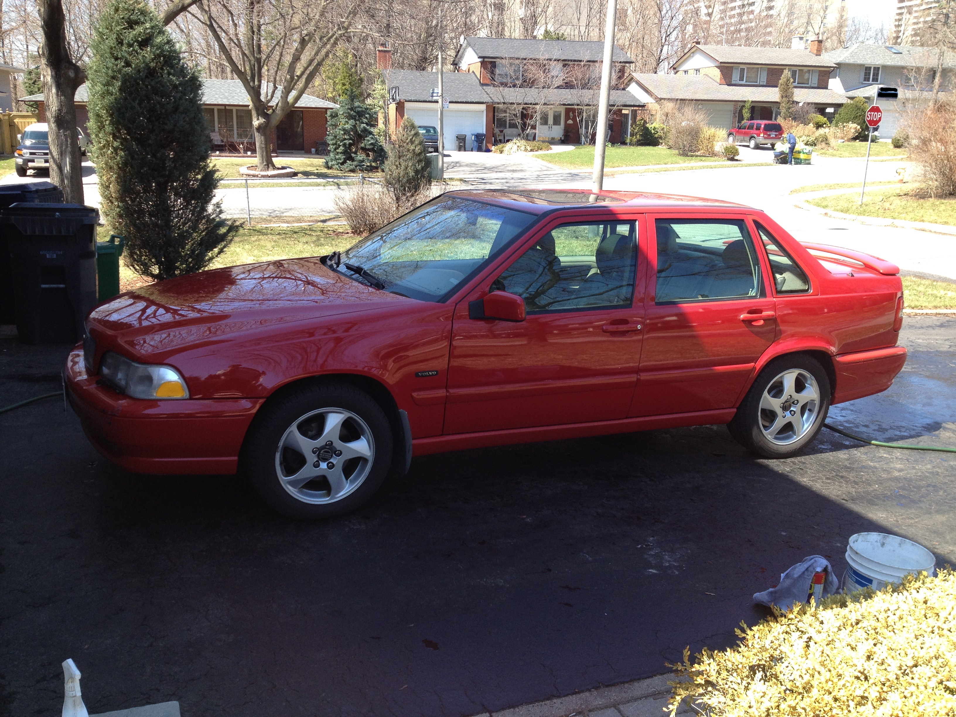

I finally got around to changing the fuel filter to complete Stage 0. I was busy installing a new garage door opener, the old one crapped out and with life in general. I was also not really eager as I rarely expect much from a simple filter change.
How I was wrong, this was the single most performance gain from all the Stage 0 work besides the transmission fluid change. It was a bit of dog in city driving and I attributed it to turbo lag at first but I can say the car feels much peppier. The filter must have been really clogged, it looked like the original as it had some undercoating on it. I used a Bosch filter. I plan to cut it apart with a Sawzsall once it dries out and I flush some water in it.
Here is a pic of her after her first car wash.

I'm glad you were able to turn over a new Maple Leaf with your car...
Welcome aboard!
