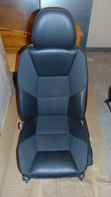

I had a chance buying good conditioned V70 front seat, but no built-in seat heater and phone speaker in the headrest. So the challange was not only the replacement, but carbon heater pad installation and wiring the old headrest as well.
Photo series starts here: https://picasaweb.google.com/1105164004 ... 2523989314
Good write-ups:
http://www.volvoforums.org.uk/showthread.php?t=192883
https://www.matthewsvolvosite.com/forums ... 11&t=43997
Successfully connected the heater pads to the original heater switch in the dashboard.
EDIT: the red and black cables from the OEM switch has always power ON (ignition switch in position 2)- independently the setting on the switch. So I had to install the aftermarket button also.

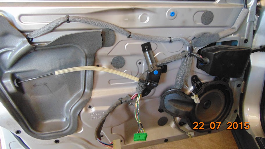

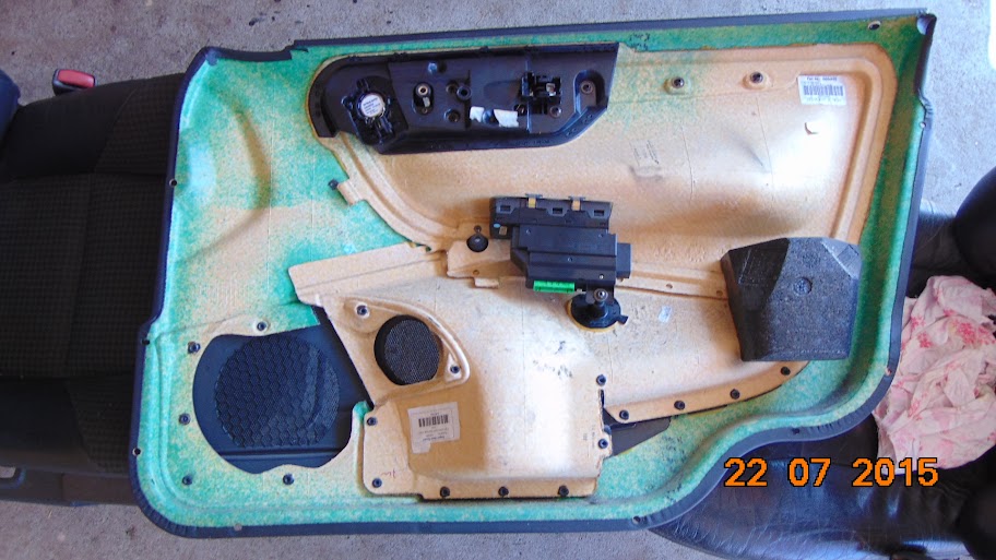

Realized some contact failure in the big speaker and the in tweeter: working after some knocks.
Reason found: some minor corrosion/deposit in the connectors successfully removed by spray WD40.

The thermometer display in the dashboard getting to be useless for a week: showing +2°C (and snowflake) at hot Summer time (+37°C here). After some research good hint found: typical contact failure in the green connector (passenger side door: behind the tweeter). WD40 solved the problem, again!

The passenger side footwellligjht was not working: no connector/wires found above the light unit, so wiring created from the other side (green connector on the photo).
