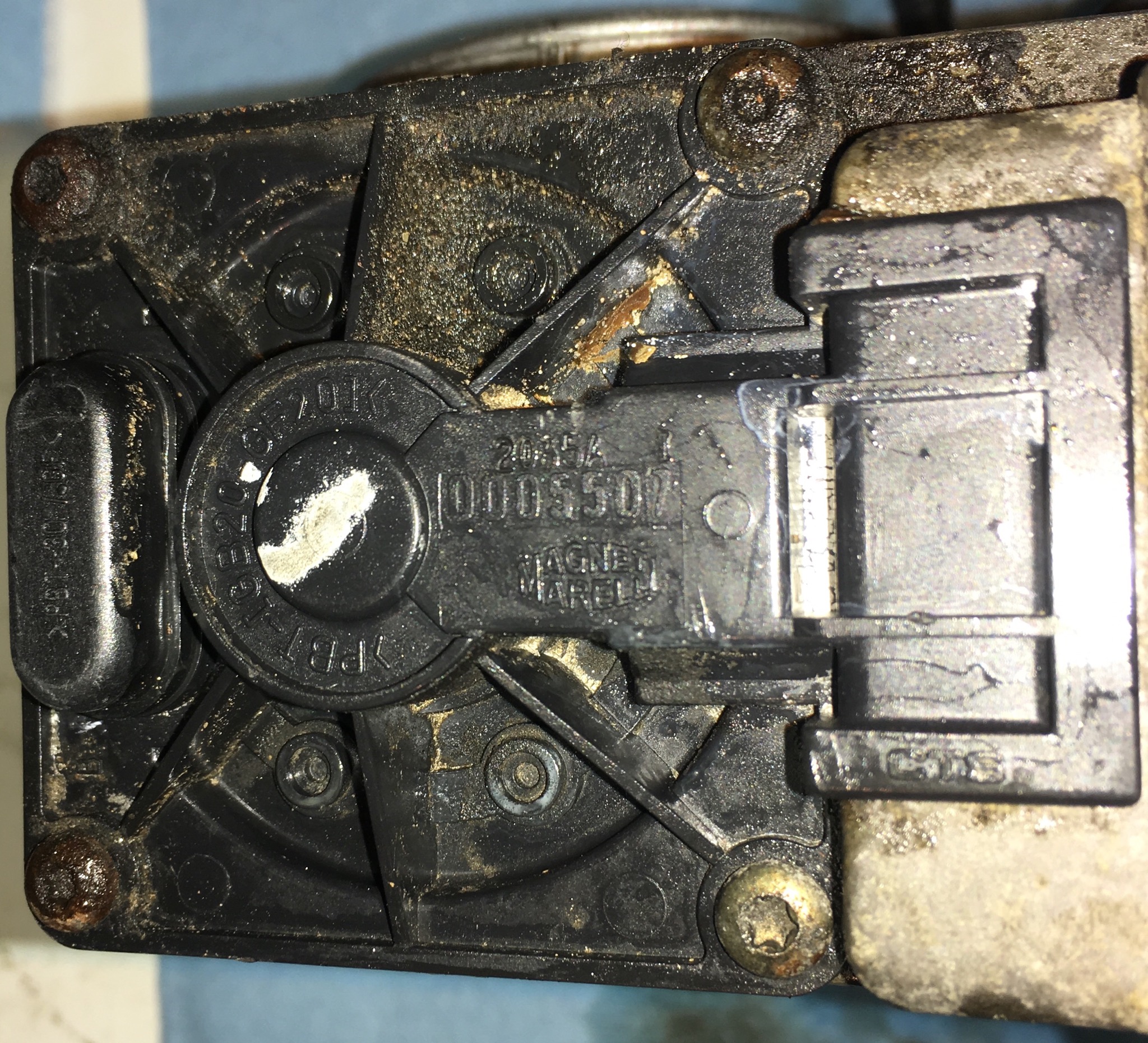

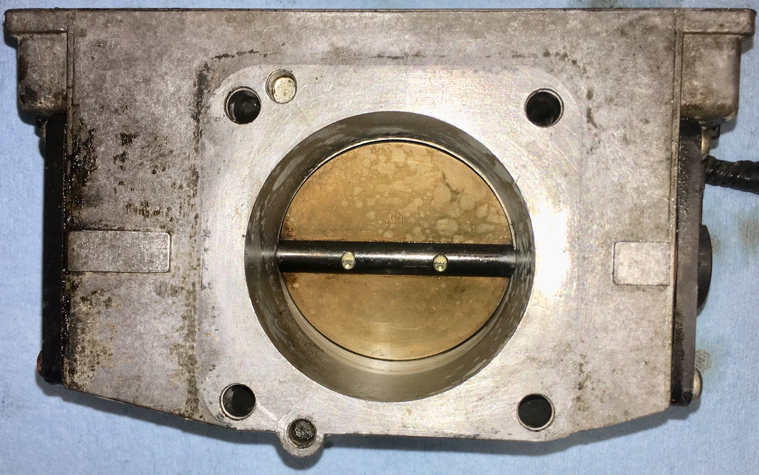

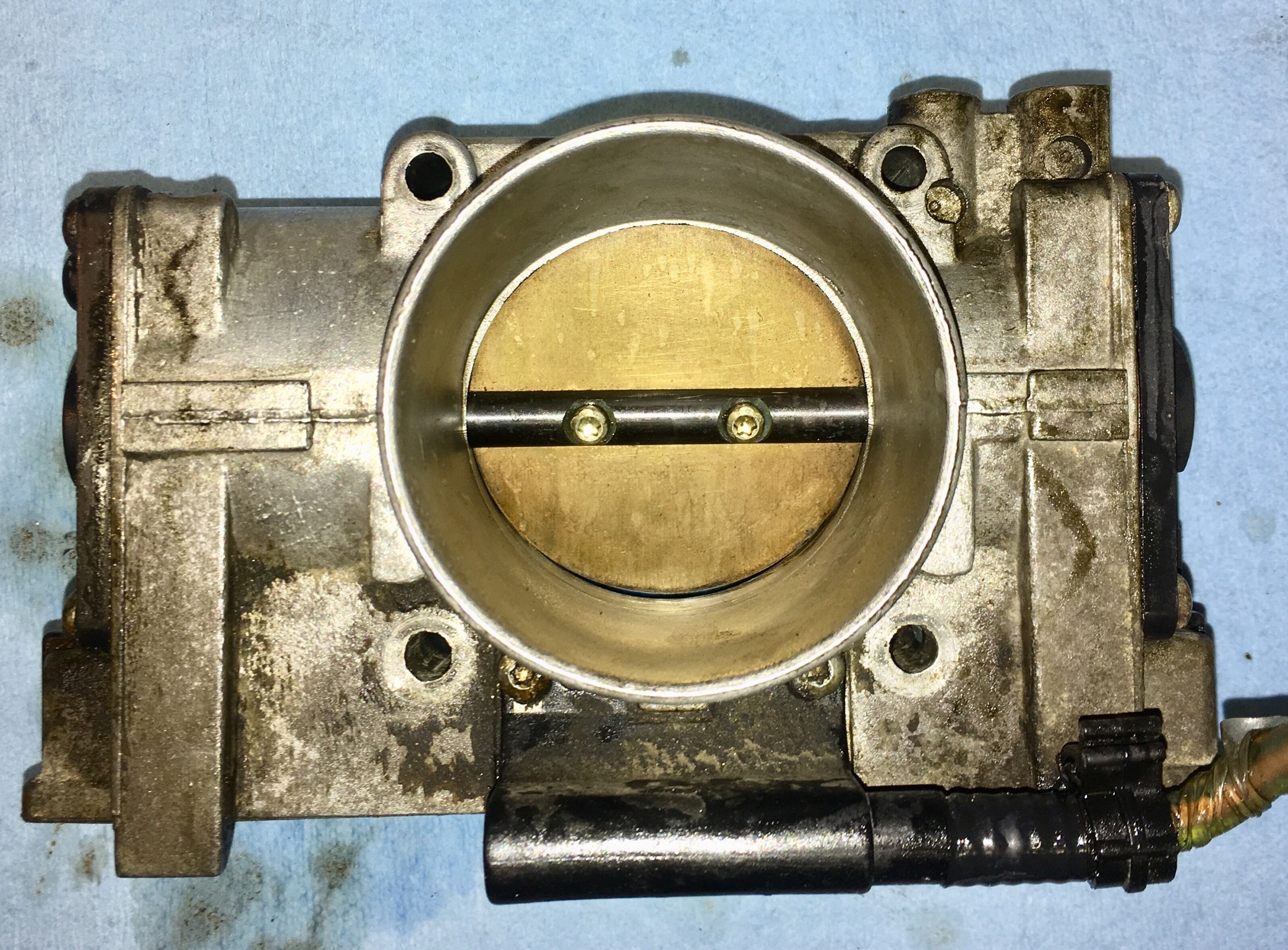

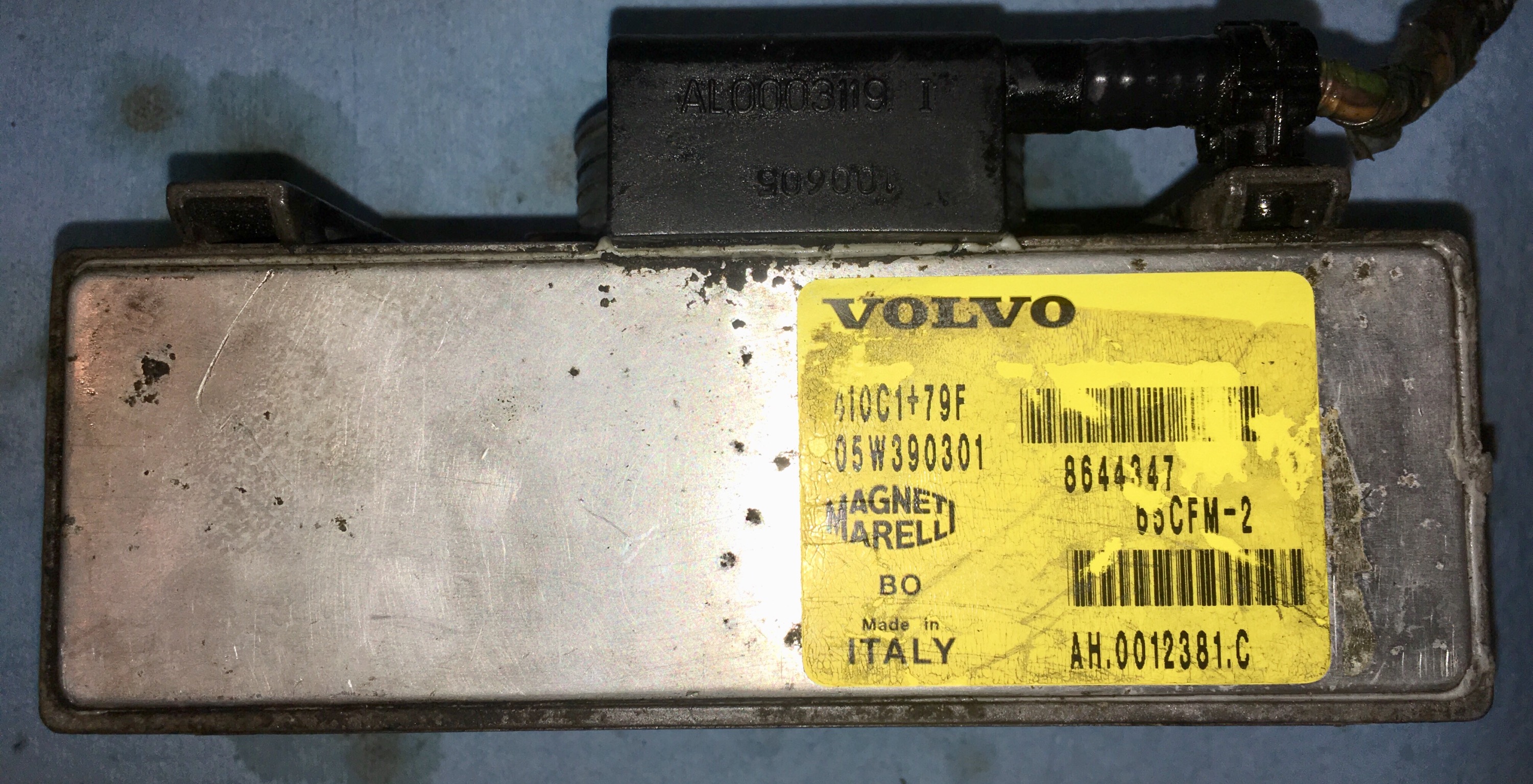

I took a few close up pictures of the unit as well. Not sure if they’re any use for diagnosis or if the condition is an indication of any other problems.

I had to download the video because it wouldn't view however after viewing the footage it looks perfectly normal and doesn't look like it's binding (a push of the throttle flap manually by hand back and forth while it's asleep will tell more than a video will about binding)
P0121 is a sensor one failure and an internal clean can't get rid of this in the pic (you'll need a contactless kit or another wiper film)
