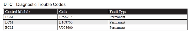

I found the service bulletin (Technical Journal if you prefer) from Volvo.
The codes listed in the TJ are
I Just checked the history for my S80
P1087 Not permanent (Resolved on its own)
P2568 Not permanent (Resolved on its own)
And here is the actual TJ
TSB_RTD.pdf
(2.11 MiB) Downloaded 850 times

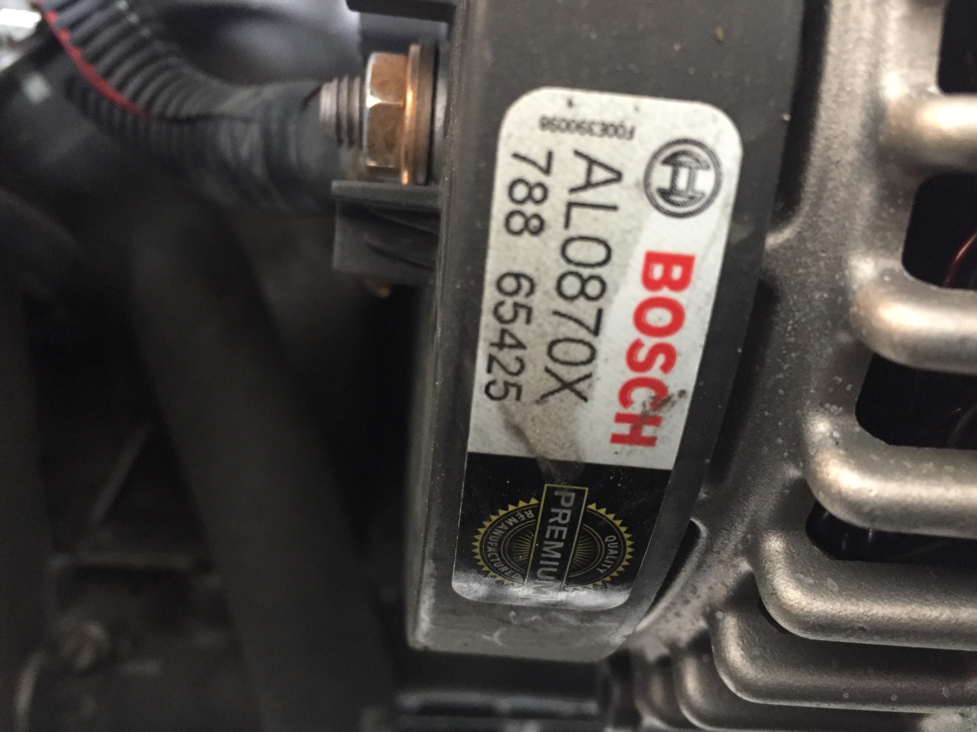

I wanted to share something that I found that was a nice surprise on my 2010 S80 3.2.
I didn't notice when I bought the S80 that the Alternator had been replaced.
I was planning on rebuilding the Alternator or at least replacing the Over Drive pulley, I replaced this pulley on my Land Rover 3.2 and it was seized after 12 years of service.
Now that I know the Alternator was replaced (likely after the 4 year warranty expired in 2014) the replacement part looks aftermarket from BOSCH not a Volvo Factory supplied part. (Let me know if I am wrong about this)
So for now I am not worried about Brushes, Bearing or the Overdrive clutch for the next 5 or 6 years.
I just wanted to share the good things that I find as well as the bad.
Thanks
Paul

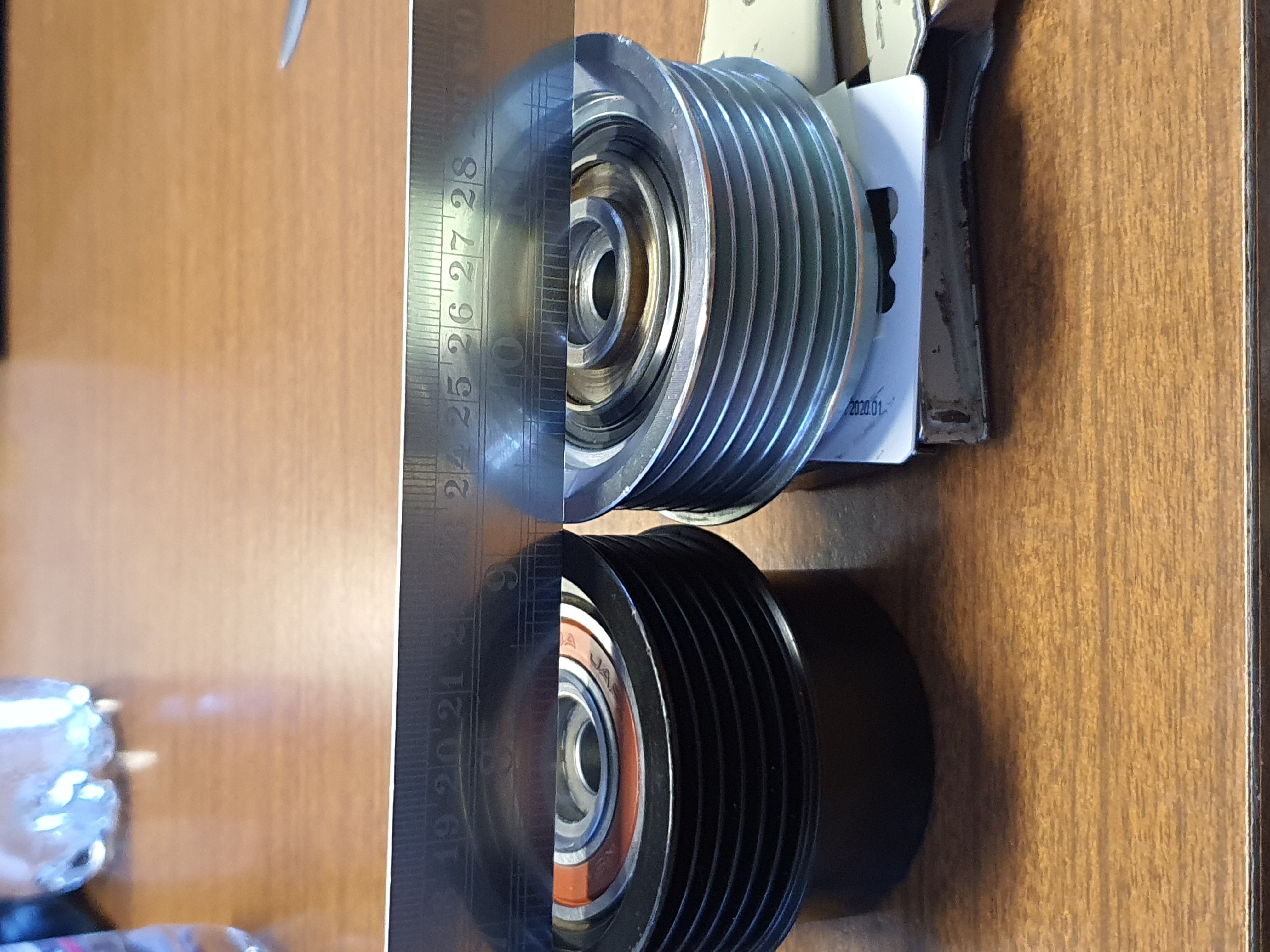

Hi Paul, what's your opinion about the overdrive pulley OAP instead of original decoupler ?
I've both FL2 and Volvo S80 with 3.2 engine and for some reason my Volvo comes with a strange unique OAP metal finish pulley with a different offset because of 3mm shorter shaft :shock: :shock:

Luca17as wrote: 28 Aug 2020, 11:54 Hi Paul, what's your opinion about the overdrive pulley OAP instead of original decoupler ?
Luca,
I also have a FL2 and the S80 both 3.2's (you likely know this if you read all of this thread)
I did replace the OAD with an OAP for both of my 3.2s
I am very happy with OAP.
The big difference is that the OAP doesn't dampen vibrations in the belt but the OAD will. The tensioner for the belt also will dampen vibration in the belt it is designed to do this. I have this setup on my Audi 2.0T and it works fine. For the Audi when the tensioner stopped dampening effectively the belt was bouncing a bit. I wasn't sure if it was the tensioner or the OAP so I replaced both on the Audi but the tensioner fixed the problem not the OAP (OAP was working fine).
One last difference between OAP and OAD. The OAP is a simpler design. Its been my experience that simpler parts last longer.
Don't worry about the difference in length in your picture, The extra length is likely needed to fit the extra parts needed for OAD. The belt will be in the same position for both.
Don't worry about this difference.
One last thing to think about for the Alternator the belt is tiny and rigid. For that side I would only use the OAD style. The pulley has to do all the work and the more complicated part is justified.
