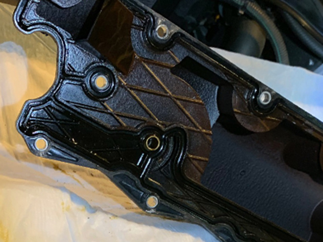

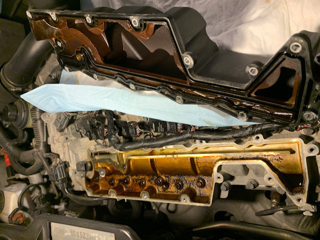

Cleaning and replacing original crankcase. It is held down with 14 T30 screws; be careful with removing the female connector housing clipped on to the unit.

Post by pgill »
XHEART,
it does look like you have a little oil in the passage way near cylinder #6.
This small area (its very clean) is on the far side of the diaphragm so at idle it sees engine vacuum.
A lot of oil in this area indicates a problem but you have a small amount.
Be careful cleaning I cut my hand severely on the sharp edges
Thanks
Paul

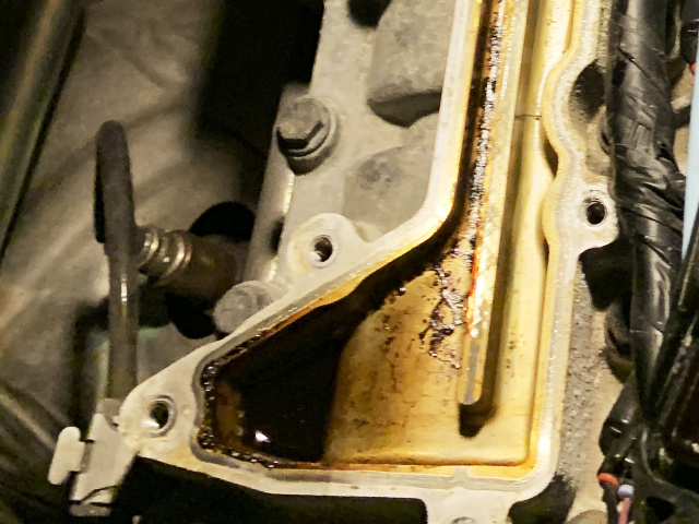

Post by xHeart »
It is sharp, even the fingernail can find a slit if not careful.
A tablespoon full of oil, thick like honey, was in the corner pit.
pgill
Posts: 813
Joined: 27 Aug 2018, 17:42
Year and Model: 2010 S80, 2008 LR2
Location: California
Has thanked: 120 times
Been thanked: 189 times
Post by pgill »
My apologies for the bad explanation.
The concern is the oil at the other end of the cylinder head.
If the Diaphragm isn't working well then oil will pool in the port at the back of the engine. Note: the concern is the oil that is being burned by the engine.
Take care
Paul
