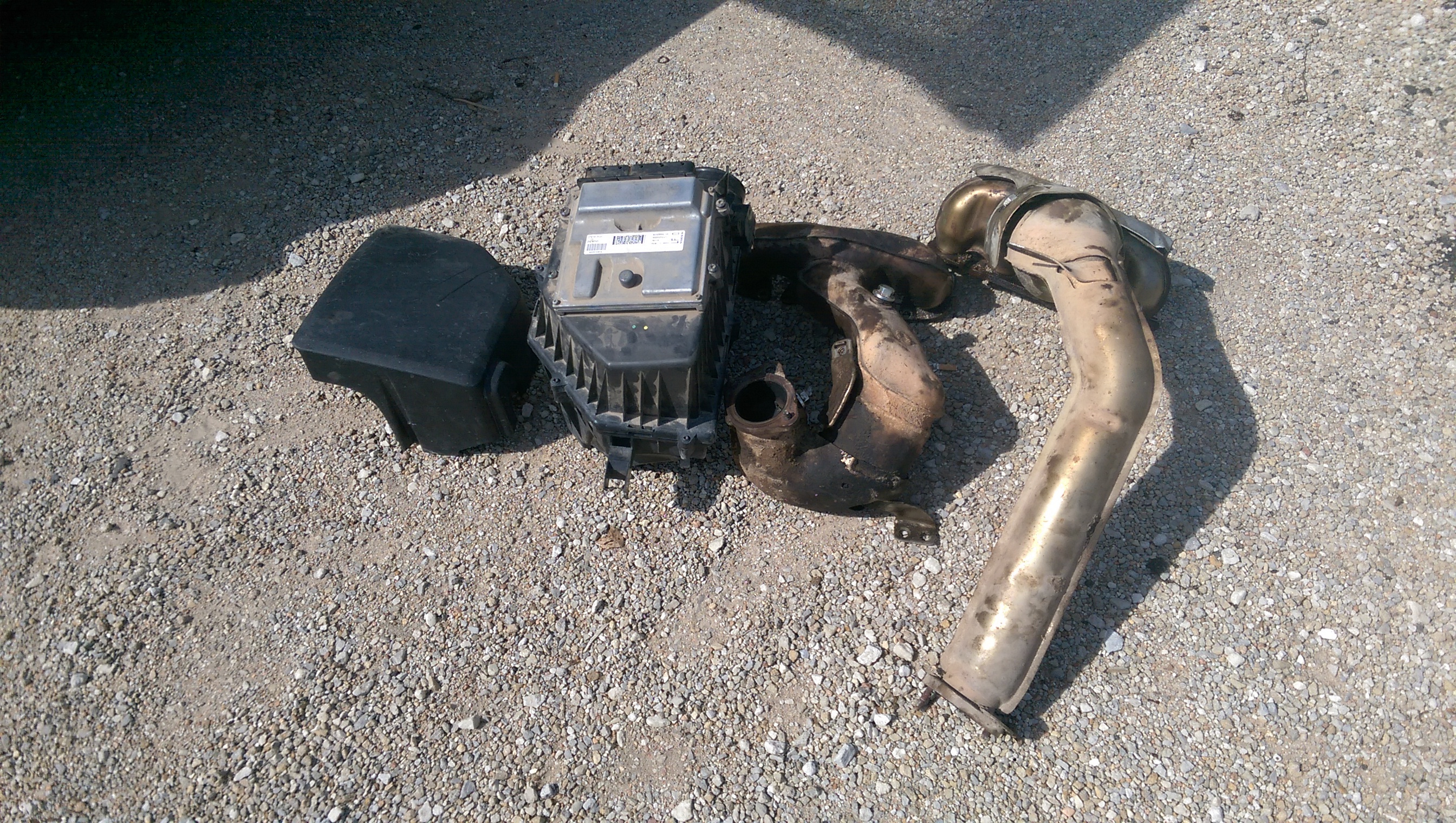

Located and acquired a ECM and a Air cleaner box.
Located both exhaust manifolds with cats still on the leash. Will try to acquire them tomorrow.

Crises over. I scored everything over the last two days.
Air box, MAF & ECM came to $60.00 total.
Manifolds with Cats came to $75.00 total.
Total ------------------------------$135.00
I'm really glad I found the Manifolds with Cats.
Was looking at:
$800.00 for Bosal ,
$1600.00 for Magnaflow,
$3000.00 for Volvo.
The B8444S came with four cats. Four Cats and VVT was Yamaha's solution to the Ultra-low-emission vehicle (ULEV II) standard. I can get the rear cats for as low as $135. Magnaflow is about $550 - $600 for the pair. I'm debating if I need them. My buddy's argument is I don't need them and I would get better flow without them. The two rear cats do not have O2 sensors.
