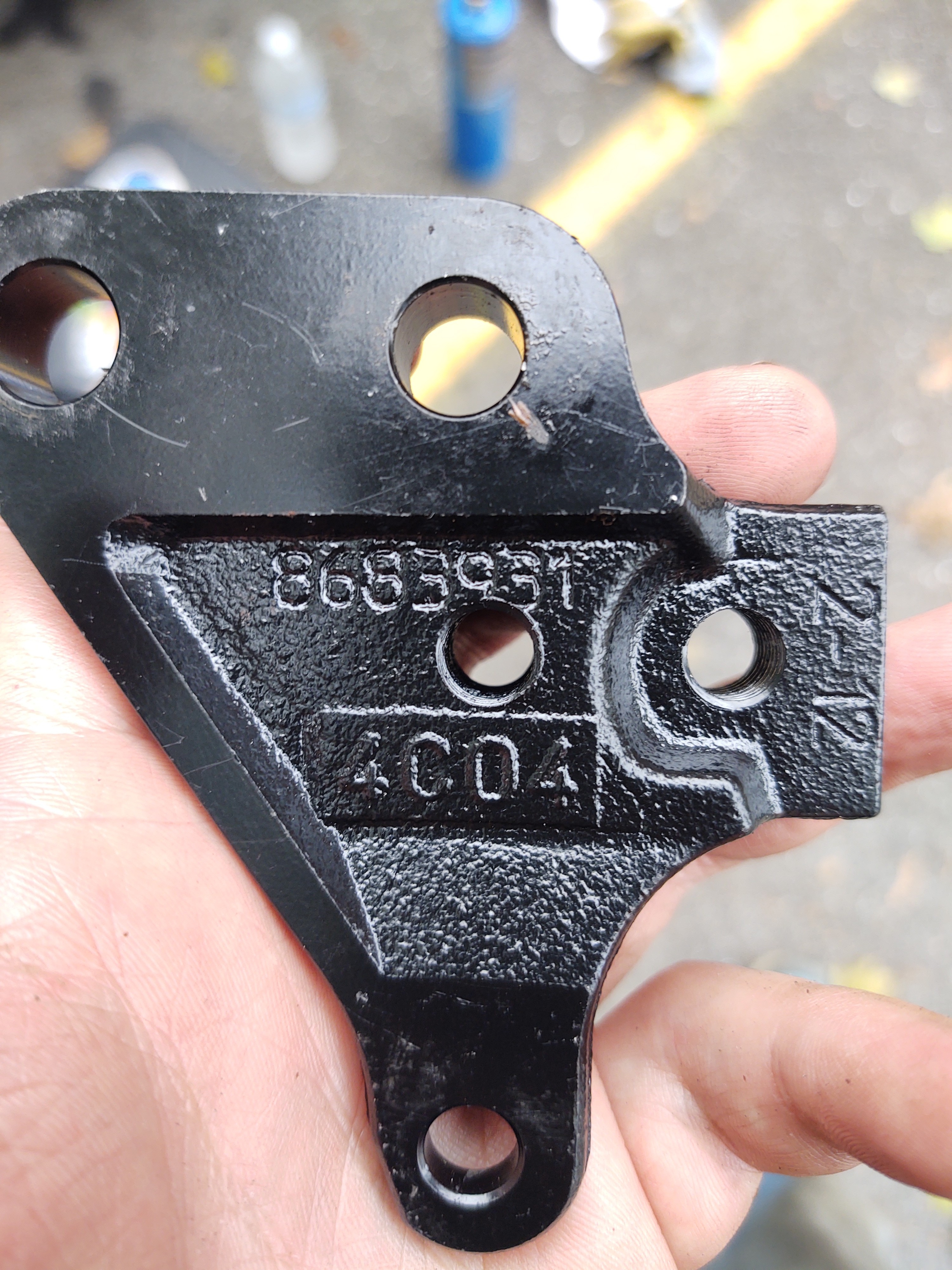

Please post up the part numbers on the inner engine mount so we can document the part change, and VIN BREAK

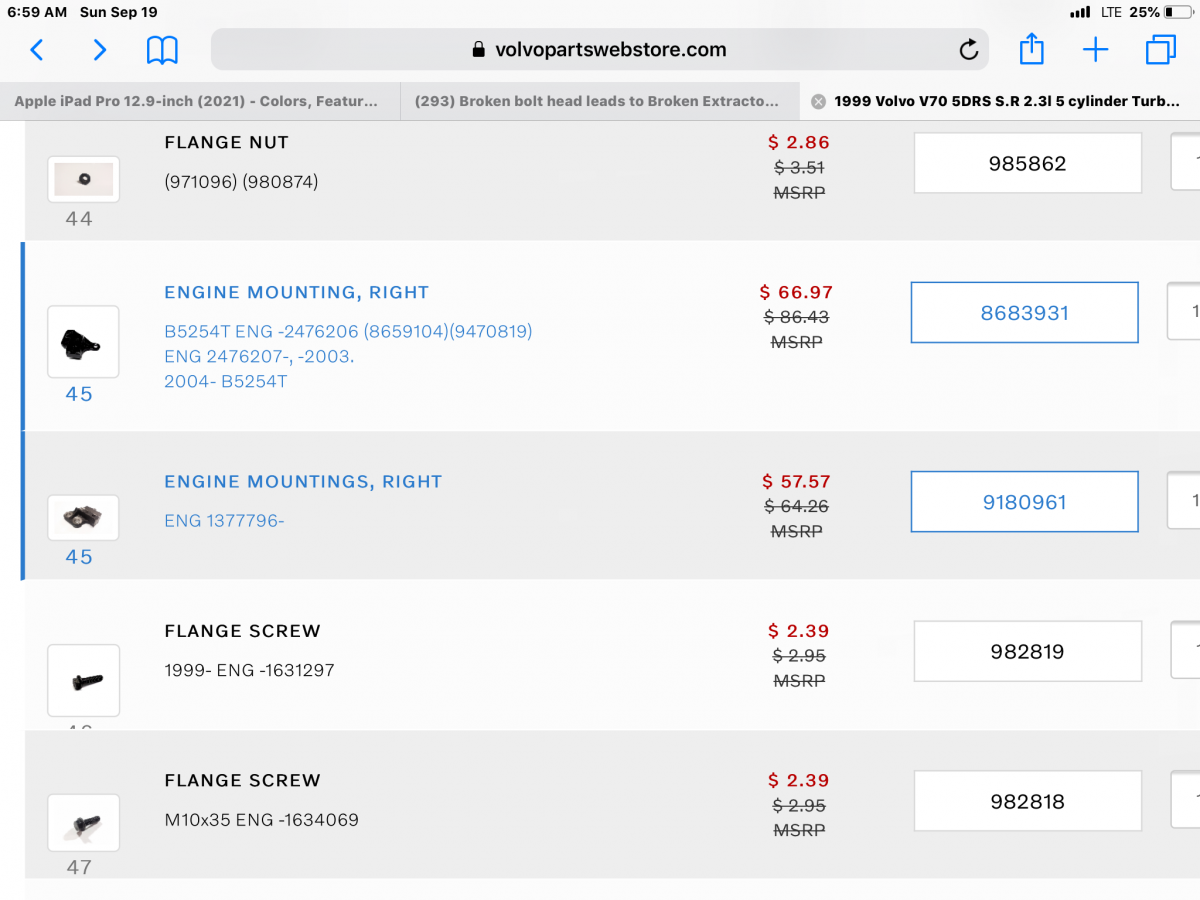

Argh, oooof. Here is some info from Volvowebstore
https://www.volvopartswebstore.com/prod ... 83931.html

868391
Is the part number that worked for my car. 1999 GLT FWD Automatic
Engine: B5254T
I was originally prescribed 9180961
It's an odd thing, often when I give my VIN for parts I get a person asking if my car is AWD.
I know this engine was used in the AWD of this year is this just a Volvo part number issue with 1999's?
Engine: B5254T

There is some funkiness in the 1999s part structure
Parking brake shoes
Same from -1998
In 1999, FWD use P80s shoes, and AWD use P2 shoes
But they both use P80 hardware to mount
Pm you my phone if you get stuck
You need to arm yourself with VIN AND engine number when buying parts
Parking brake shoes
Same from -1998

Yeah man,
I don't know if the guy at the dealership just made a mistake, he is normally an ace, but I gave him VIN And Serial.

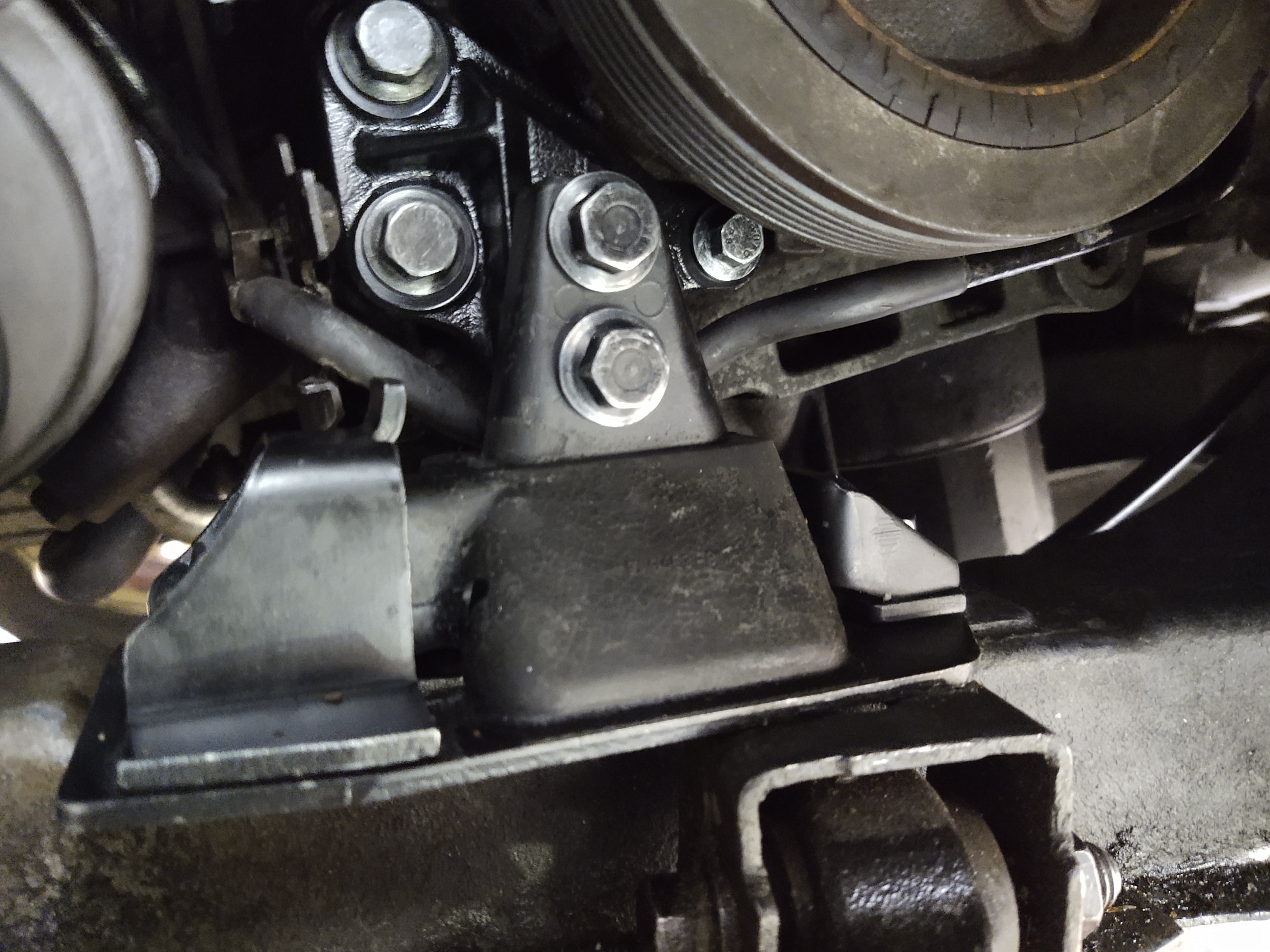

Now that the right bracket is on and the mount is secure, do you think it would be safe to try and drive it just to test if the cv is still over articulated - or 'crunching' ?
I am wondering if the engine bracket and mount being held on with a bolt each respectively could have contributed to the noise/feel?
Is there a chance I could make the situation worse or is it what it is at this point and a trip around the block won't make it worse?
Or leave it alone until I can get it looked at.

Good morning.
Ok so- with the new engine mount bracket and lower pad engine mount securely on, I decided to go for a short test drive.
Crunching in between gear and when turning is gone.
But.
There is definitely significant vibration when the car is in gear- fwd or reverse and I have the brake on. I don't notice a thing when driving up to 40mph on my short drive down the road but it is there at idle in gear.
What do make of that, seems to be leaning towards over articulation?
This is a link to a recording of the car in gear with e-brake on. Apologies for the lack of clear sound and obviously bad camera work
but the vibration is especially there at the end. I am sure you will recognize it.
https://photos.app.goo.gl/hxcp6swnPPKJgbqKA
Next steps would be pulling the axle?
Thanks!
But.
Thanks!
