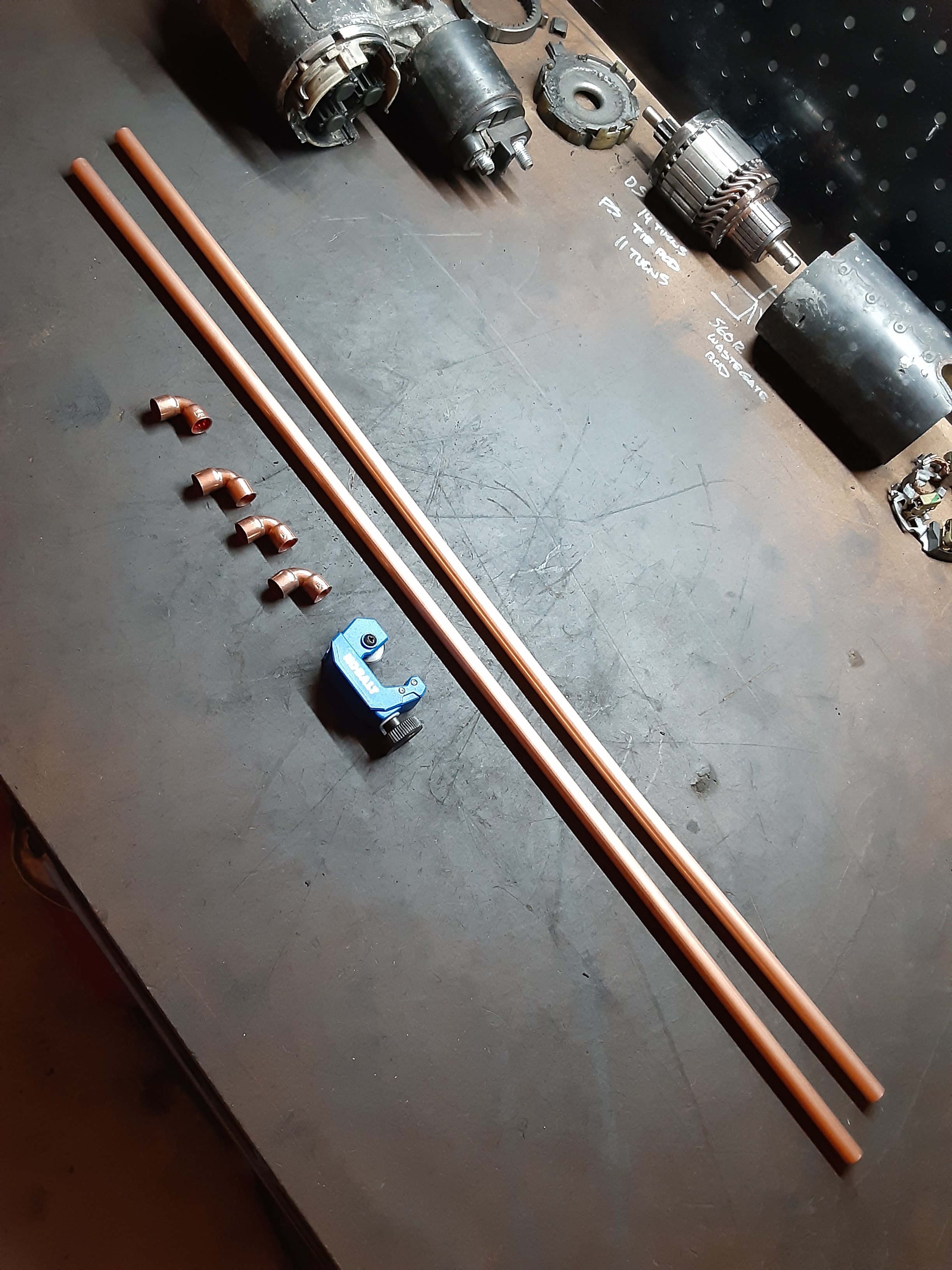

So I just need a couple of lines, one of which can handle moderately-hot liquid. Okay, I can do that. Lowe's plumbing section to the rescue.

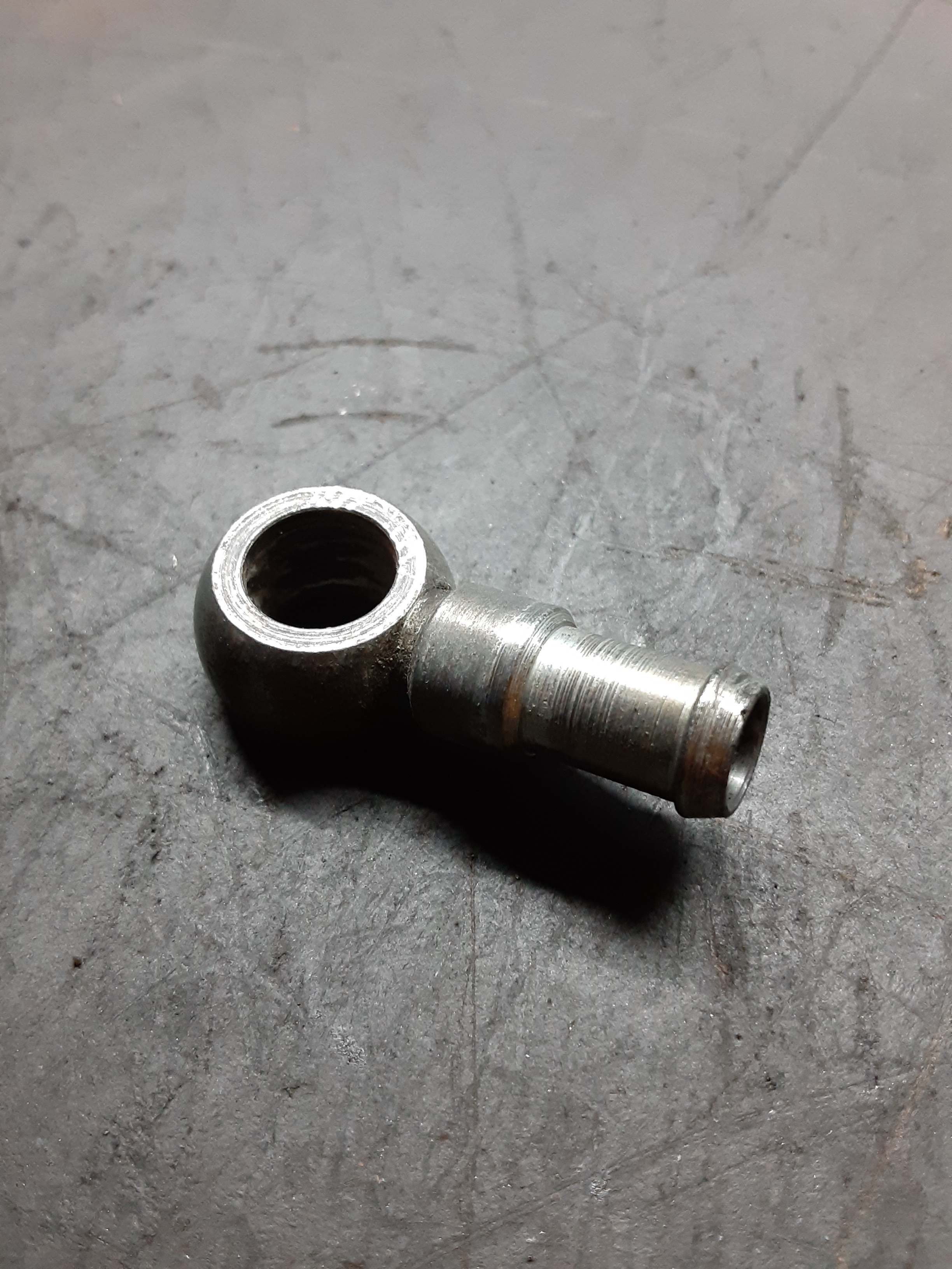

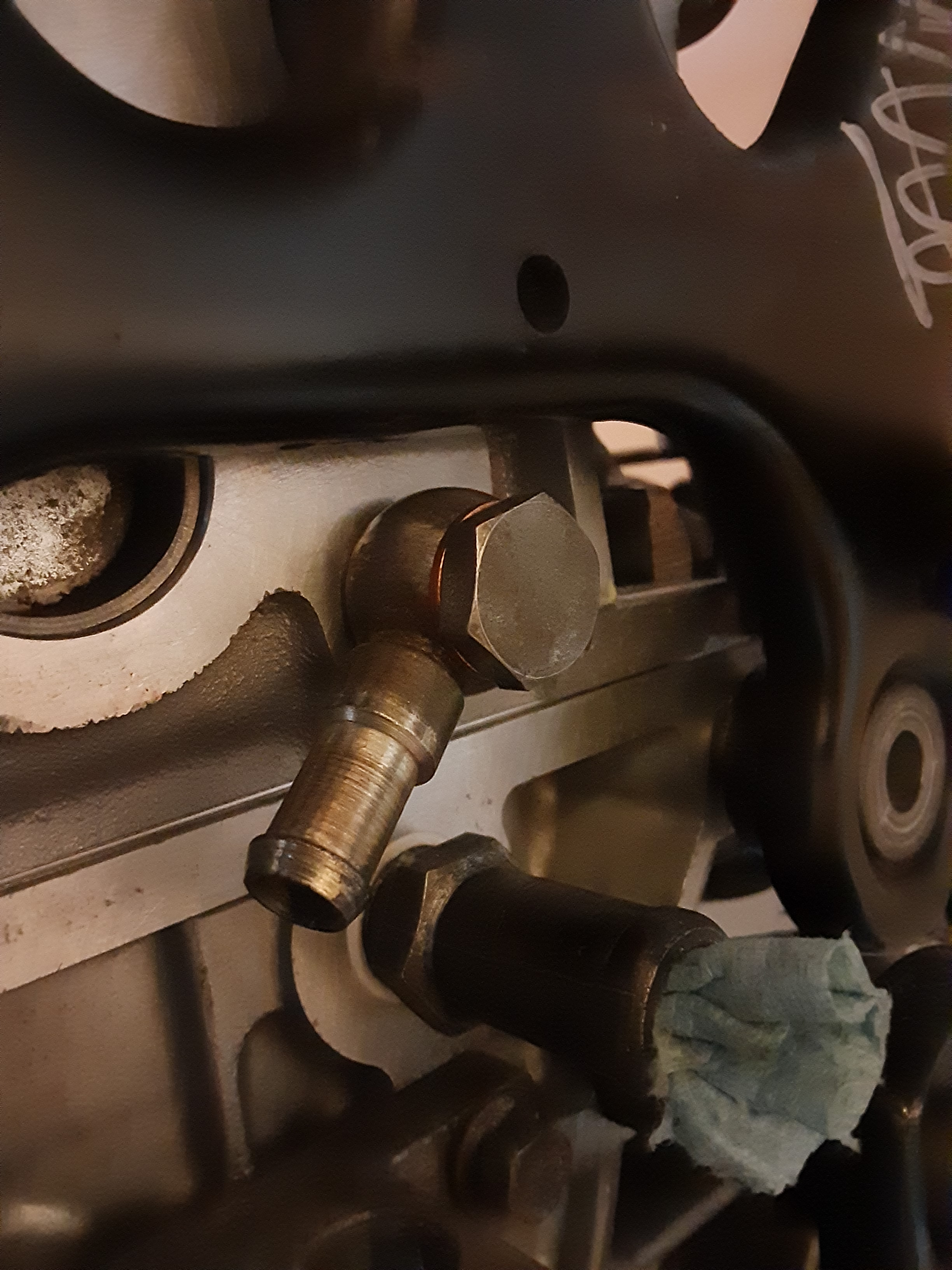

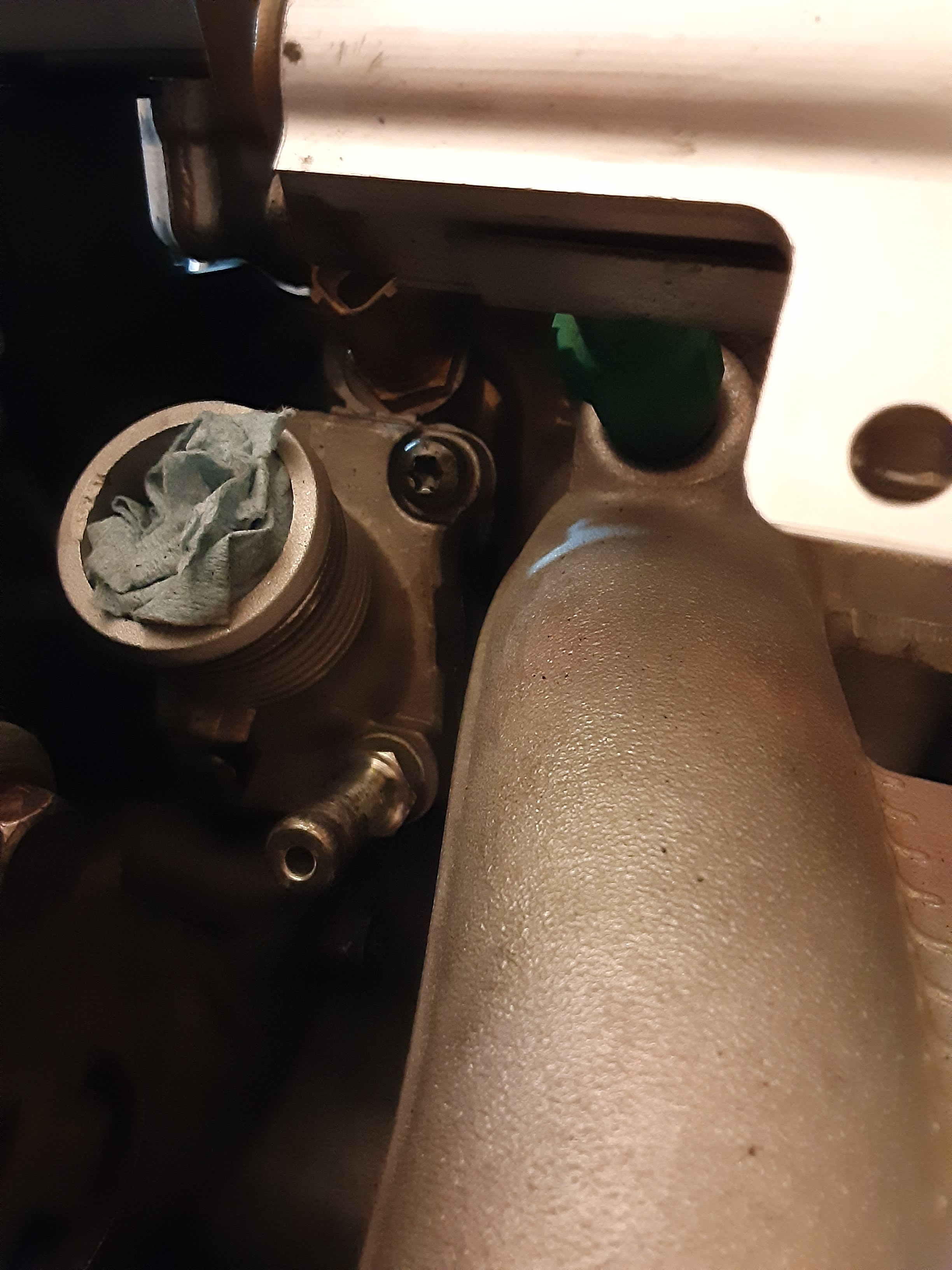

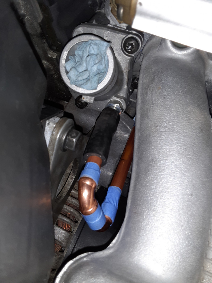

This line has to run from this nipple on the thermostat housing to this banjo fitting (not shown) on the back of the head.
I'll flare the ends of the resulting line, blast it with some high-temp clearcoat and join it to the fittings with rad hose. Simple. Throw a couple of insulated clamps on it to hold it in place and done. I'm not sure about the air line yet. I'll probably see what McMaster-Carr has in the way of plastic line. So for probably $70-$90 bucks, I've solved the problem.

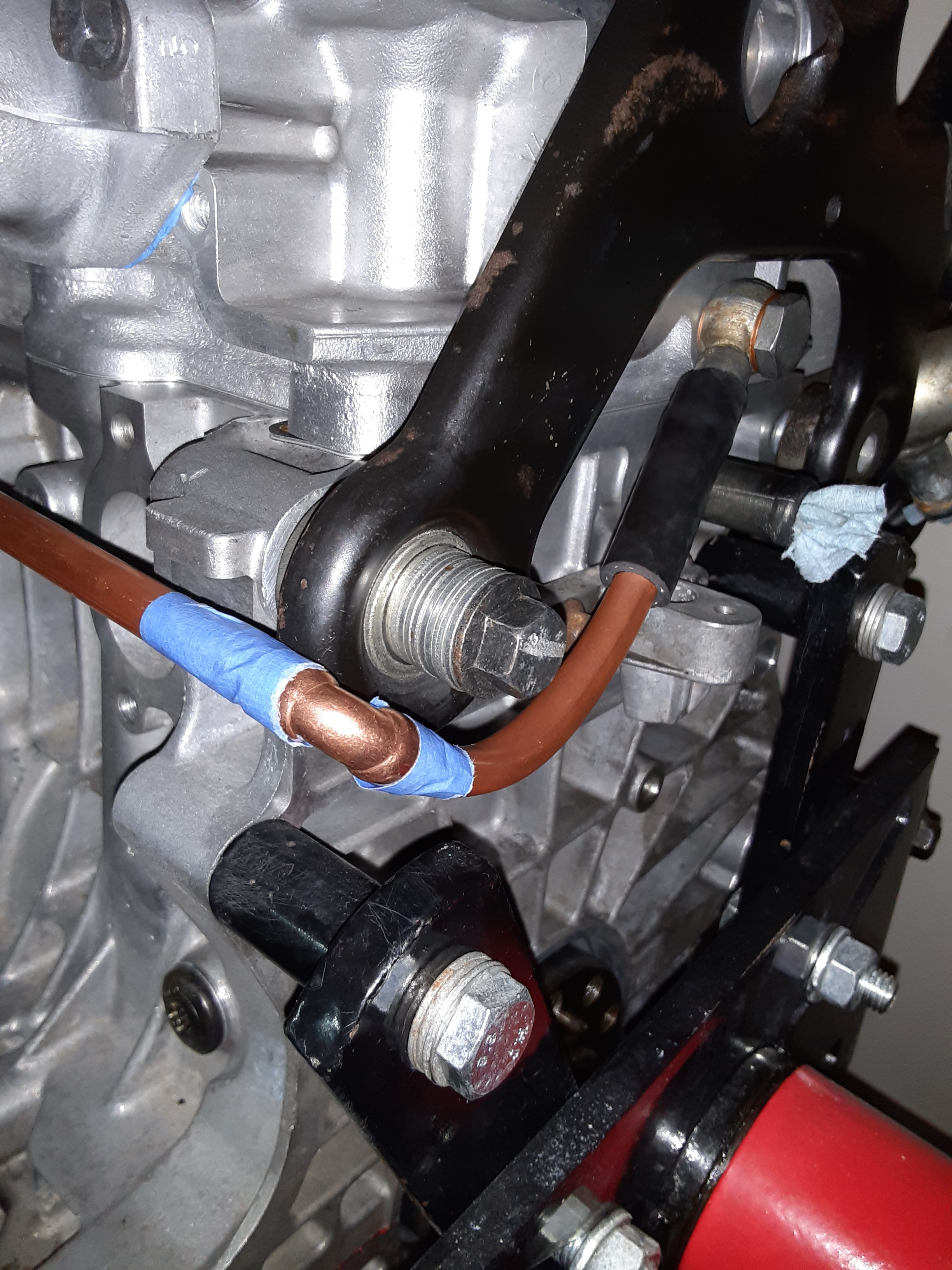

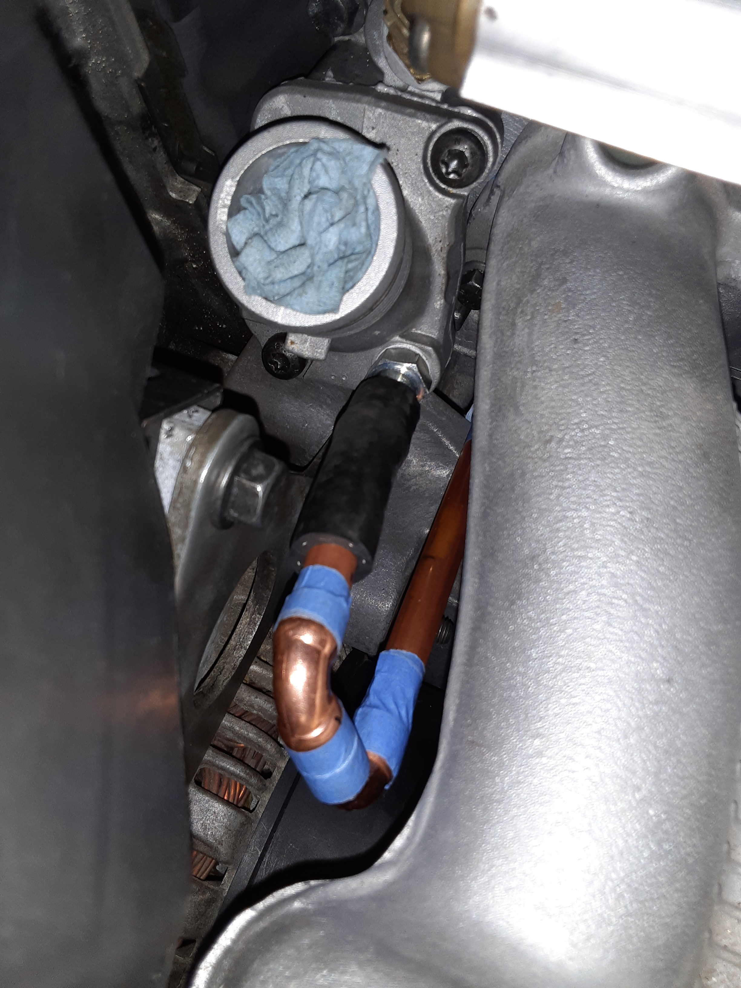

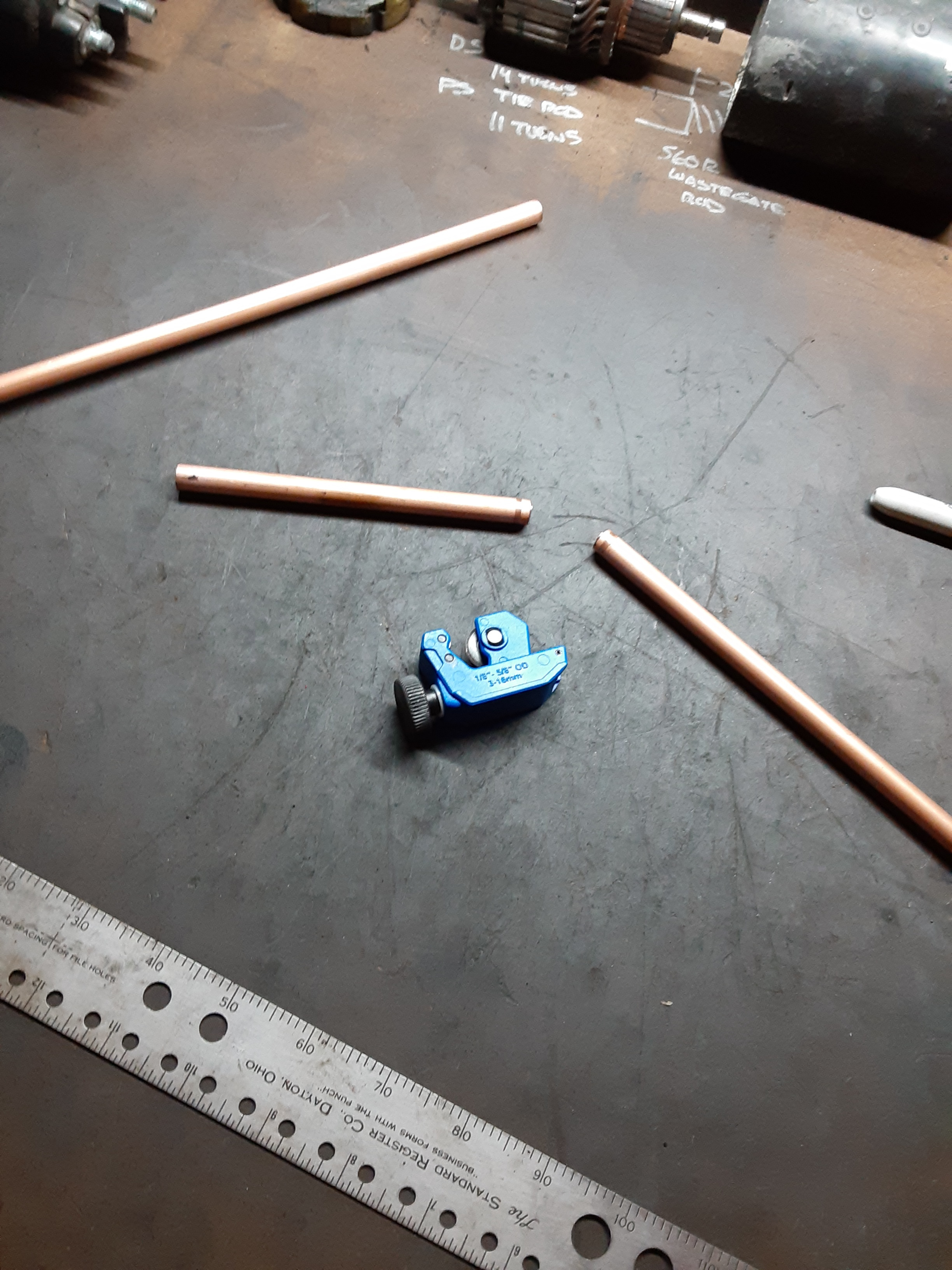

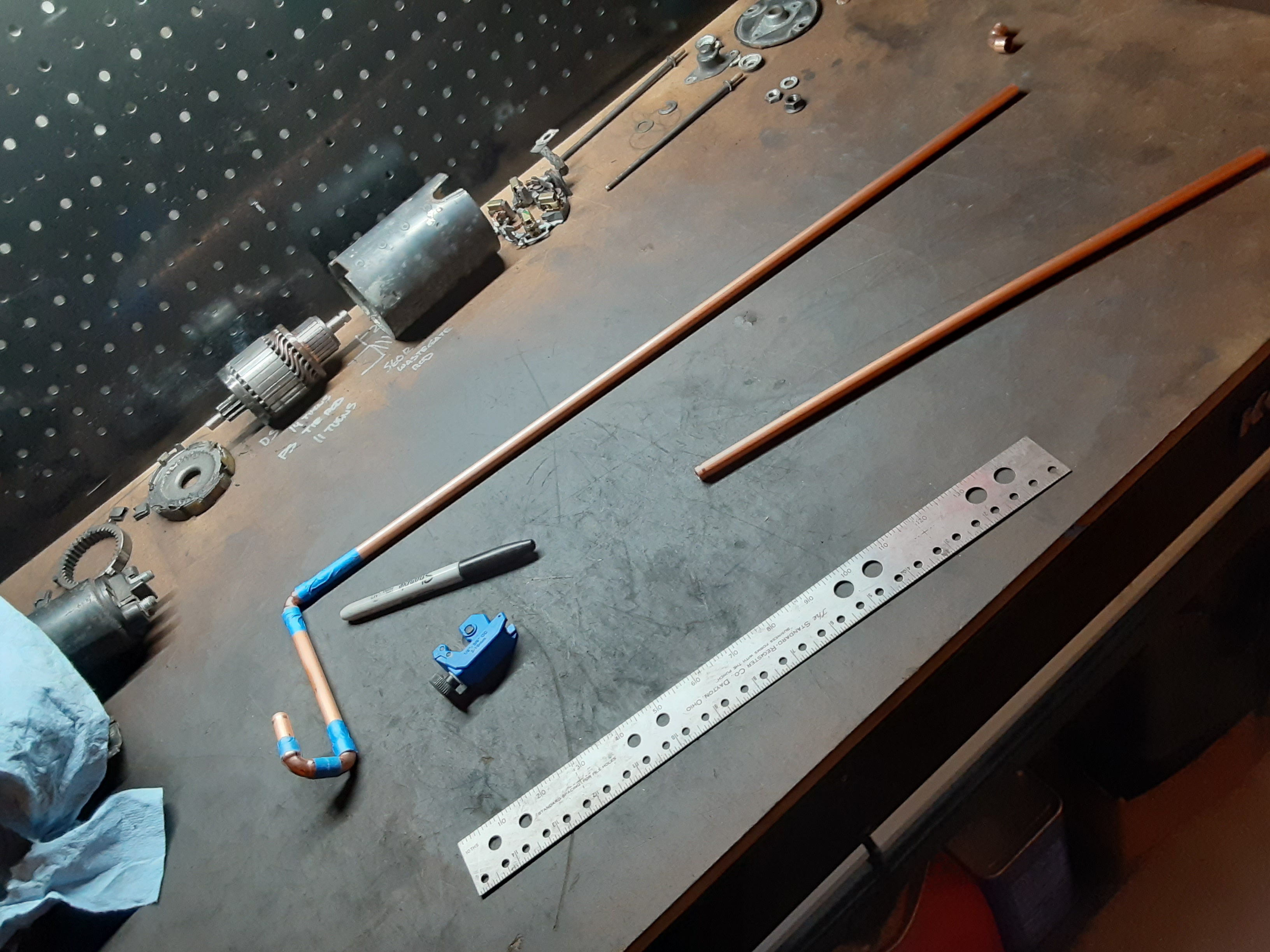

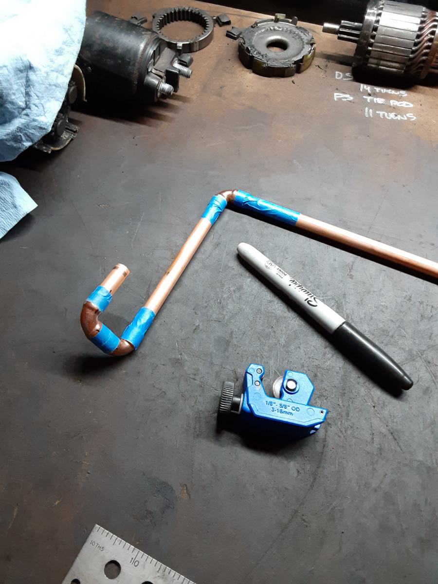

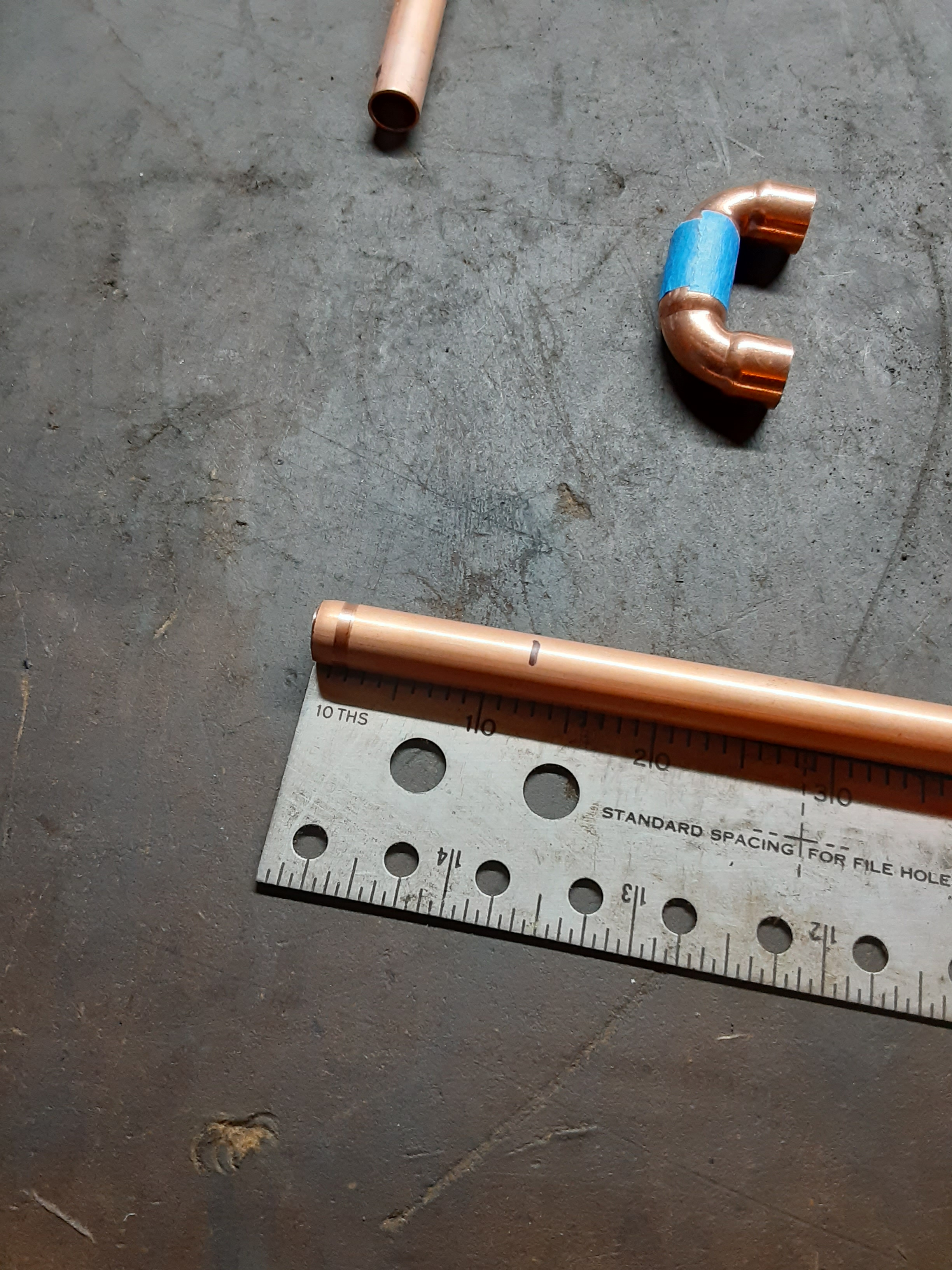

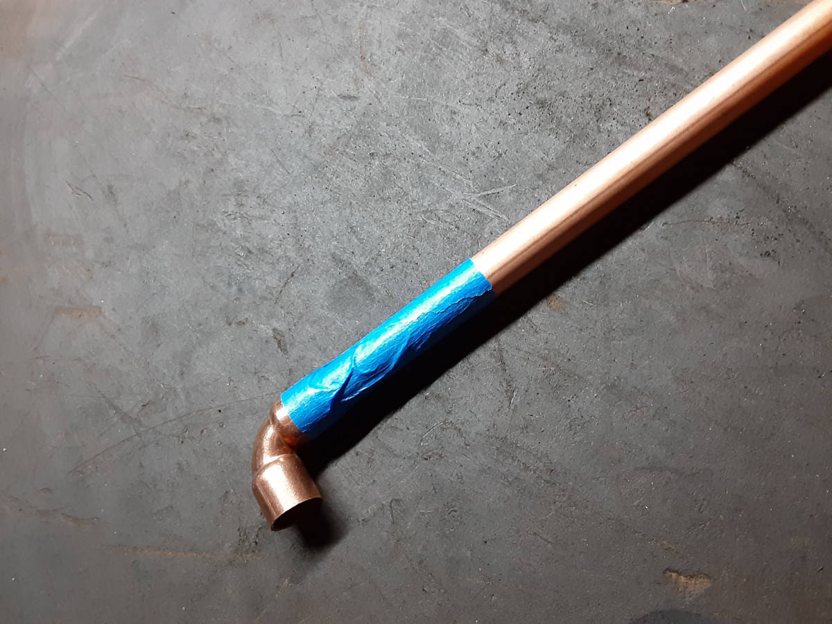

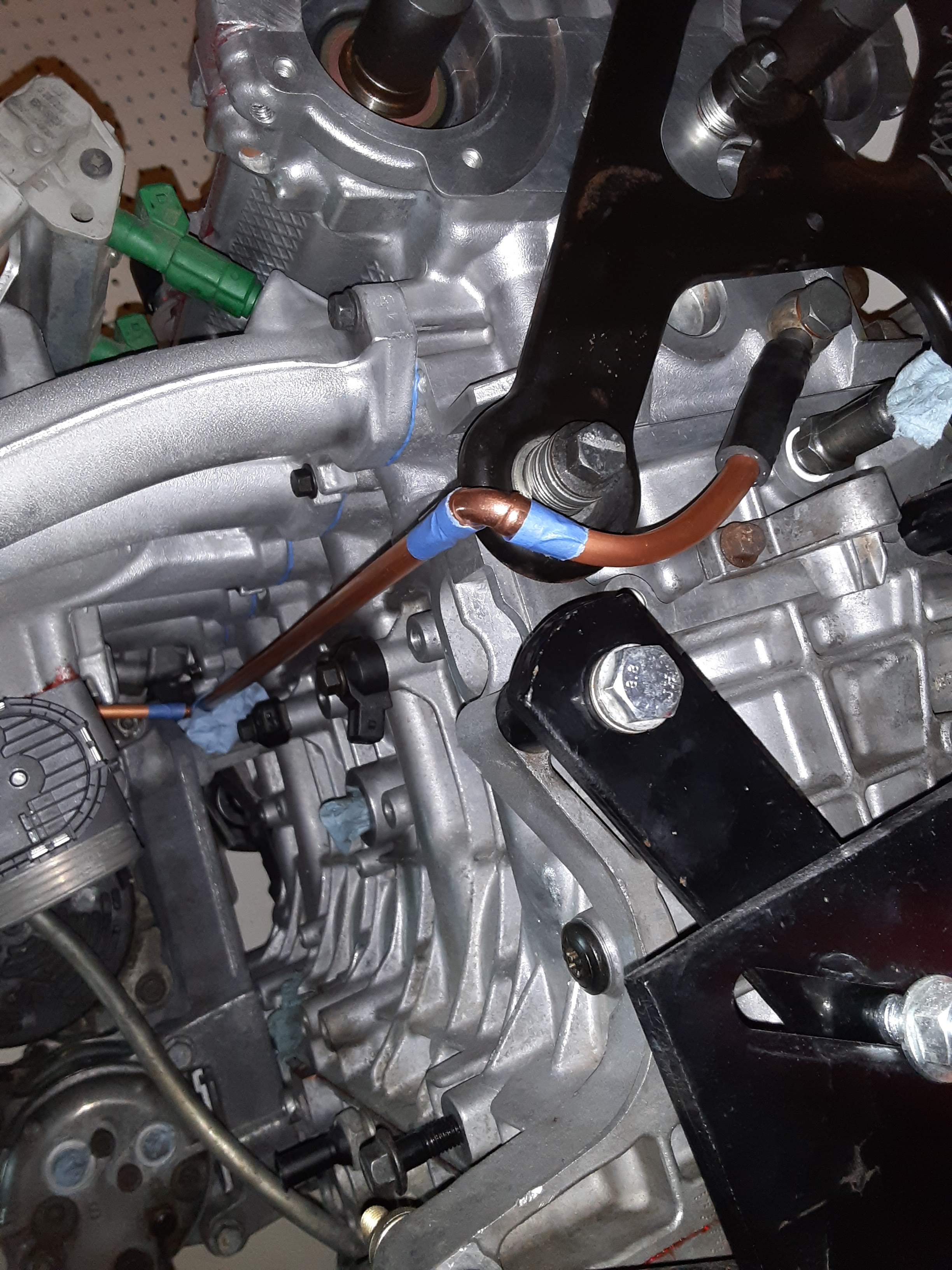

Moving on to the coolant bypass line.

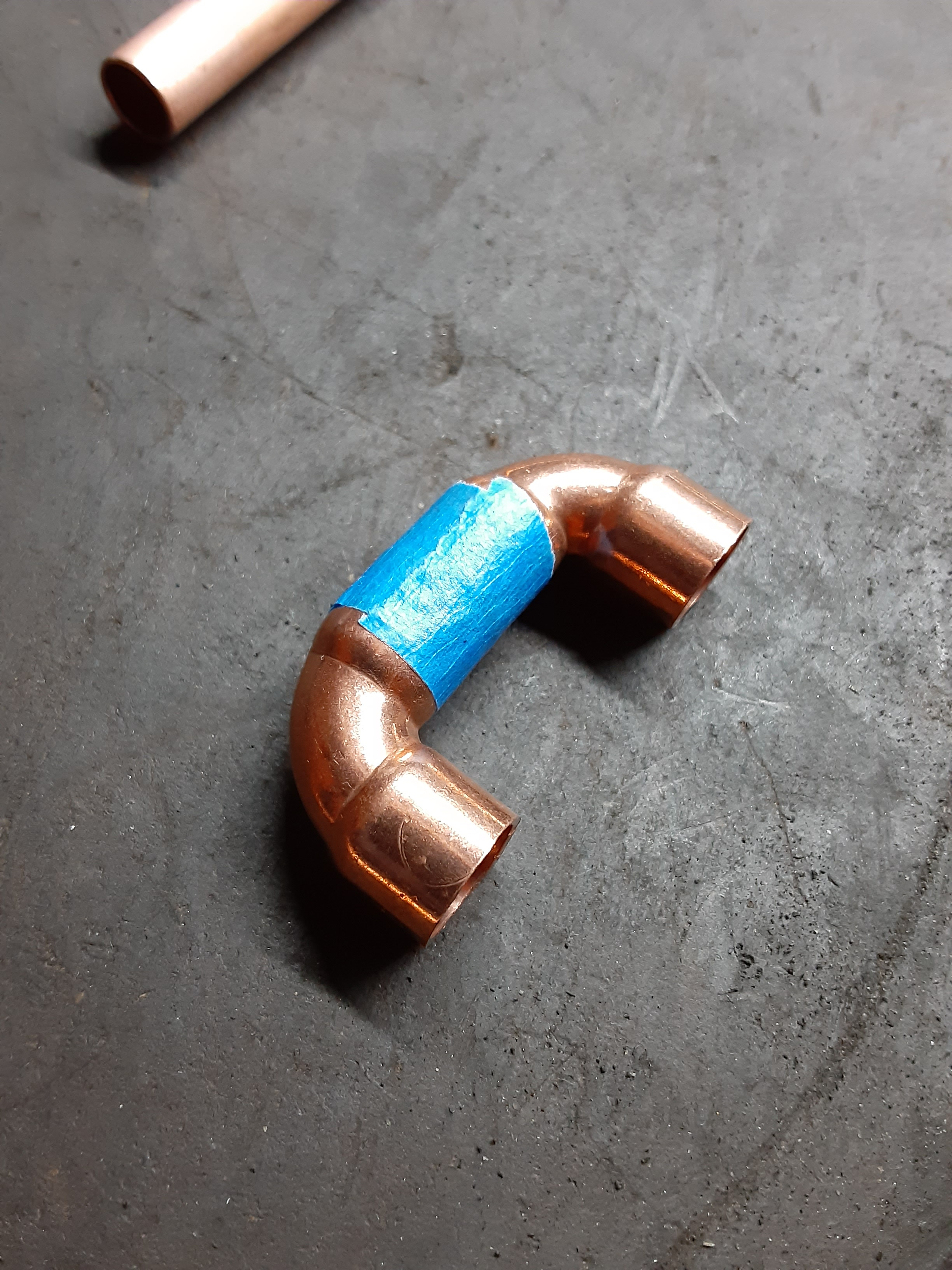

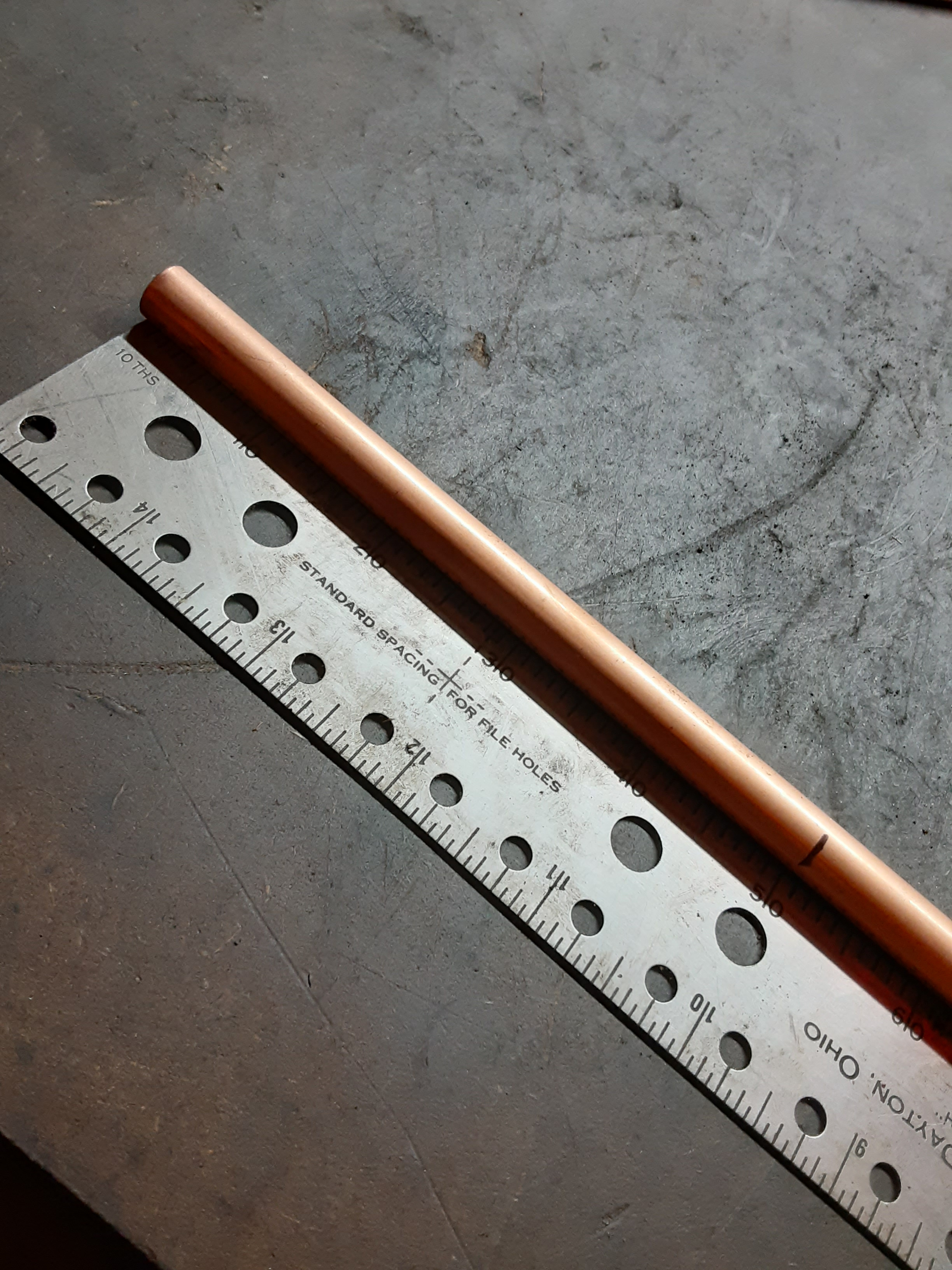

I measured the tubing, cut it to length and taped it. Obviously this is just the mockup. I still have to solder the lines together, flare the ends and get some insulated brackets to hold the line securely.

You just introduced a big surface area of Cu into your Aluminum cooling system. I wonder where the more chemically active Aluminum will erode??

Nice work! That hose is outrageously priced, and that's one reason we don't typically replace those with the PCV job on these '99+ engines. They usually don't fail, being aluminum hoses. That certainly doesn't mean they can't be clogged though.

In the thin, expensive parts of the radiator?abscate wrote: 17 Oct 2021, 16:29 You just introduced a big surface area of Cu into your Aluminum cooling system. I wonder where the more chemically active Aluminum will erode??
- Posts: 36151
- Been thanked: 4068 times
I really don’t know but dissimilar metals in hot conductive Electrolyte can create a battery of potential problems
- Nevada1906
- Posts: 273
- Joined: 07 Sep 2011, 18:01
- Year and Model: 1995 850 Turbo
- Location: Virginia
- Been thanked: 30 times
abscate wrote: 17 Oct 2021, 18:15 I really don’t know but dissimilar metals in hot conductive Electrolyte can create a battery of potential problems
Maybe I can coat the inside of the line with something.
"Maturity is when you realize that the overbearing high school principal or villainous college dean from your favorite 80s movie is actually the hero of the story."
1995 860R (854 + B5254T4 + M56)
- Posts: 6510
- Joined: 19 Jan 2014, 09:51
- Has thanked: 987 times
- Been thanked: 1075 times
This is the same reason you do not want to use a galvanized pipe in a copper or brass piping system. It may take years, but a leak will form.abscate wrote: 17 Oct 2021, 18:15 I really don’t know but dissimilar metals in hot conductive Electrolyte can create a battery of potential problems
