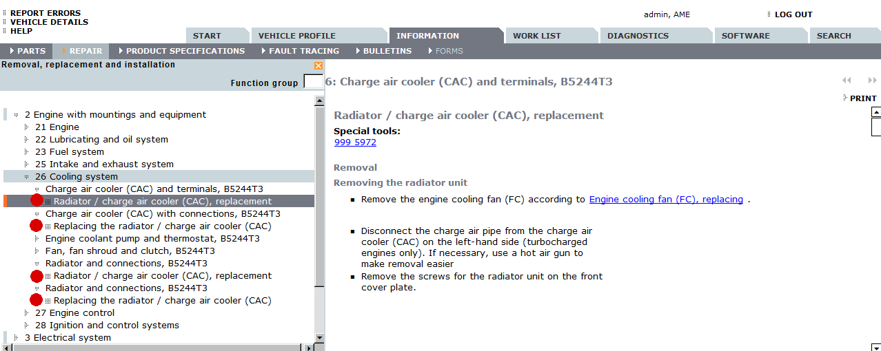

Going over the VIDA radiator replacement instructions again (yup... if you recall, this ALL started because of replacing the voltage regulator
)... there are FOUR different entries for this procedure. The text and graphics are ALMOST identical on all four of them, but there seem to be a few very slight wording differences. LOL. I guess they have it listed that way so that it will come up in their search function regardless of how a technician searches for the procedure, or whether they're searching for radiator or charge air cooler.

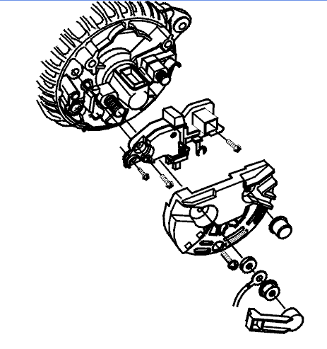

Another random thing I found while perusing VIDA. There was a brief instruction for replacing the voltage regulator (or "governor" as VIDA calls it), which are pretty straightforward, but the interesting bit was what I noticed in this diagram:
Notice the positioning of the main alternator cable - from bottom to top it goes regulator, cover plate, washer, cable connector, nut, plastic cover. The cable connector is sandwiched between the washer and the nut. I have it installed with the cable connector directly against the cover plate, and the washer and nut sitting on top of it. Do you think that makes any difference?

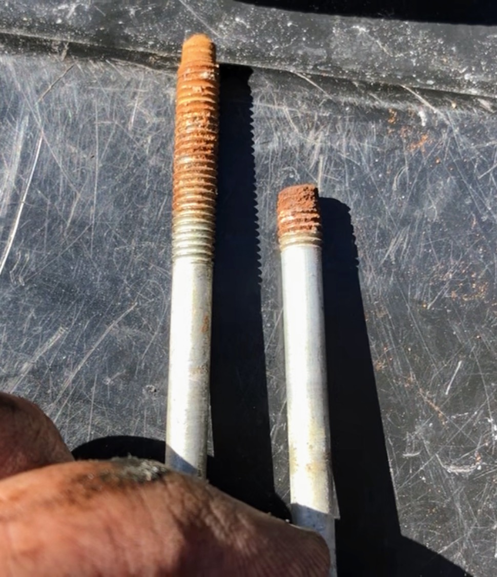

Ok… this time around one of the lower screws gave out - it snapped off at the point where the radiator and intercooler meet, so the radiator is loose but the intercooler and condenser are still attached by a rusty screw. So now I’ve got to drill it out and find a nut/bolt set to replace it. Taking a lunch break to clear my head and energize before moving on…
