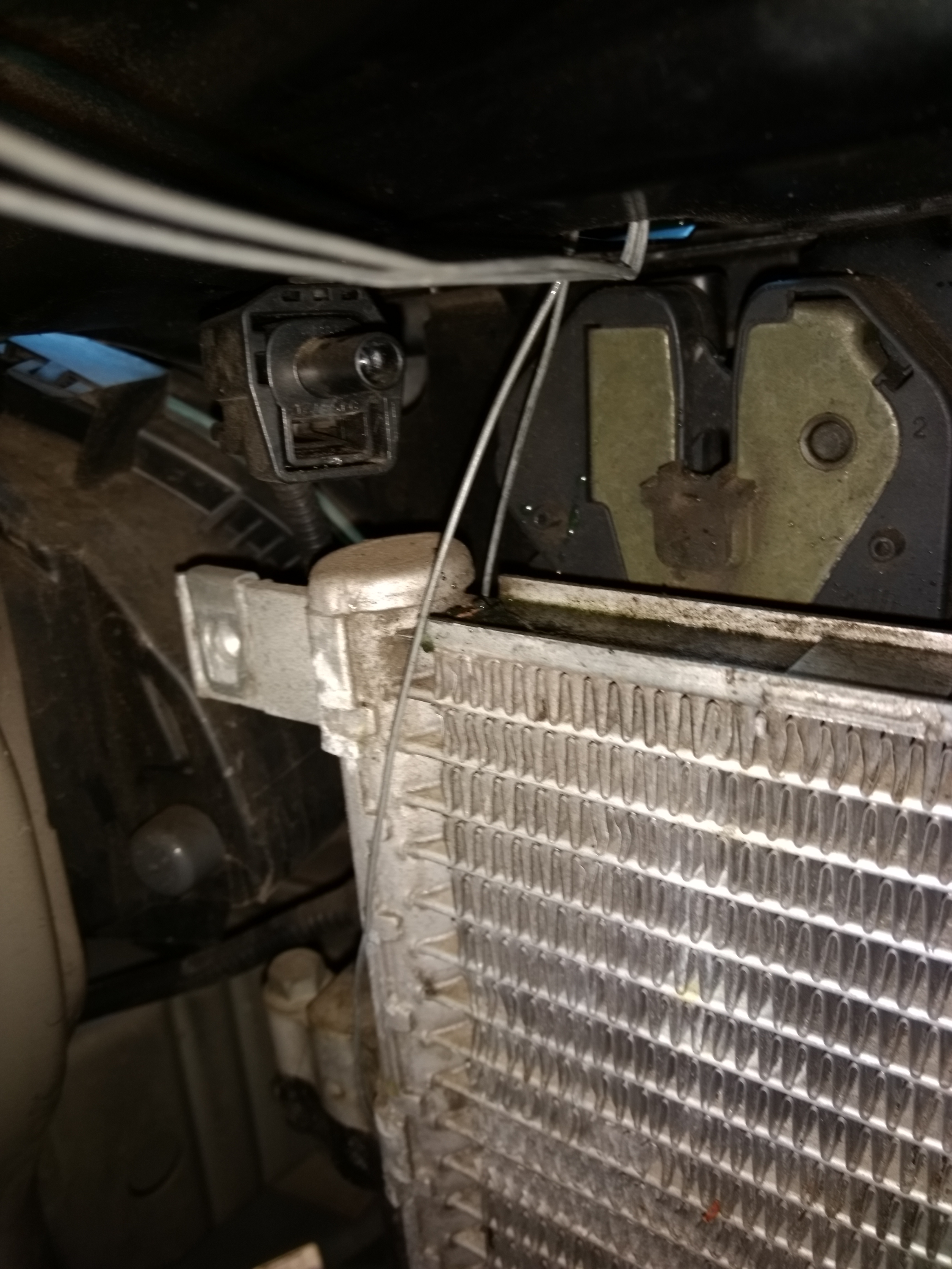

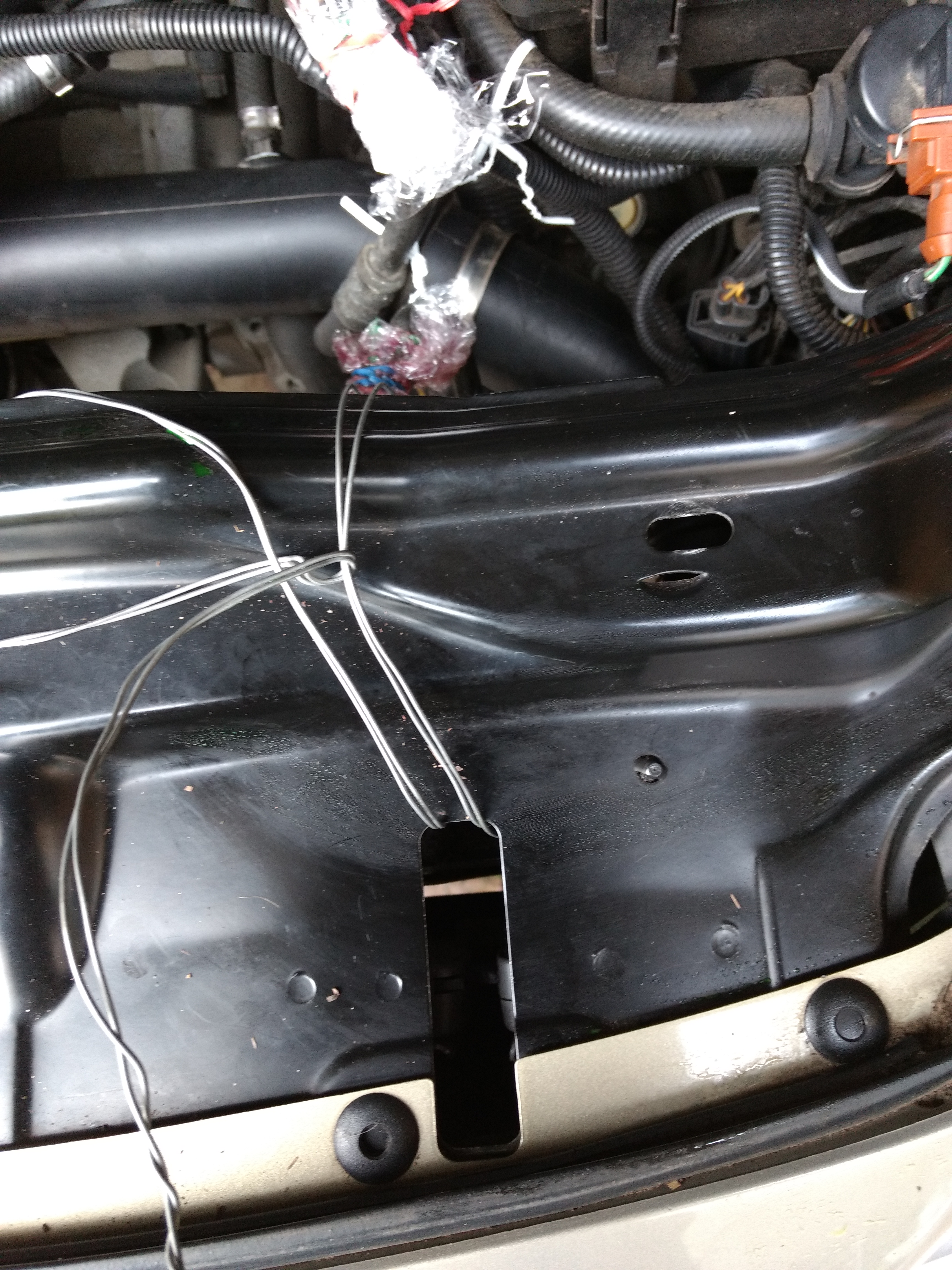

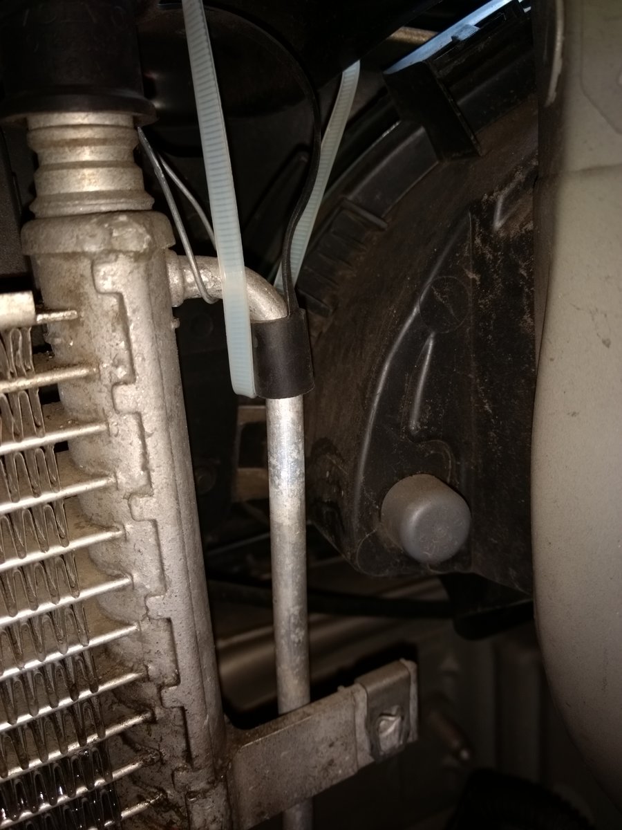

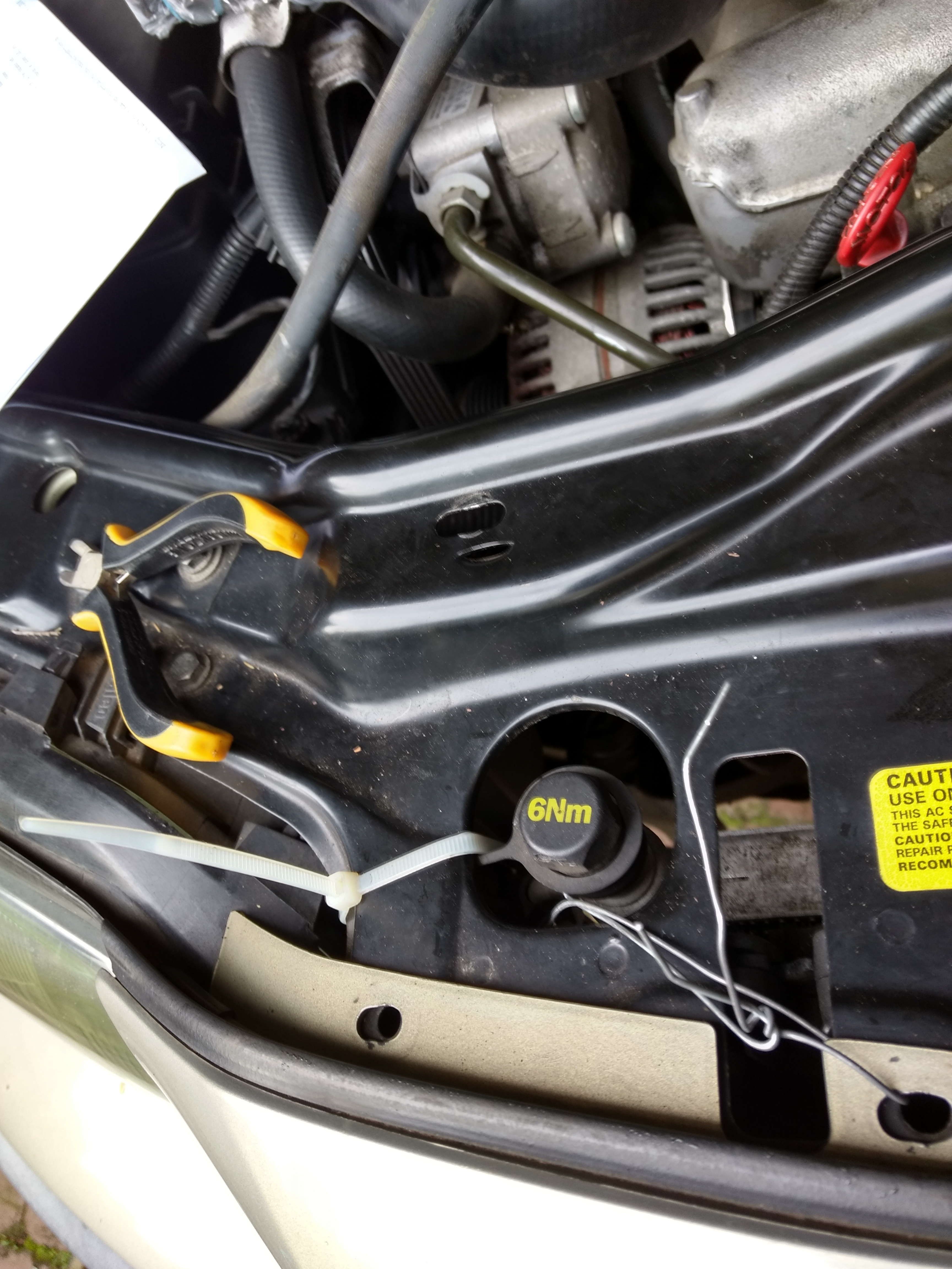

  • "... Hang up the condenser using tie straps on the right-hand side in the pipe for the receiver drier and on the left-hand side in the pipe for the condenser..." This had me scratching my head for quite sometimes. Have a look at the pictures I posted here and it will become clear how I did it.
  • "...The following requires two people..." I did this all by myself but I had to use a couple of jacks, the one that comes with the car, one jack on the left and one jack on the right to pop up the radiator and the charge air cooler.
Right hand side:
Left hand side:
On the left hand side 1) pushed two pieces of steel wire onto the front and back side of the air condenser from the top and 2) tied the steel wires at the bottom and 3) pulled the two wires up from the top and tied it to the top panel.
Please note that once you remove the six screws, per VIDA instructions, the radiator and the charge air cooler are decoupled from each other and everything. These two components must still come down together, due to the air cooler hose connectors being in the way of the radiator.

- None of the videos I watched or instructions I read mentioned this, but: The hard line between the compressor and condenser on the left hand side blocks the radiator/intercooler assembly from sliding down, and can't be removed (without evacuating the system), so I had to essentially rotate the assembly towards the right hand side of the car and slide it down until it cleared this line.
