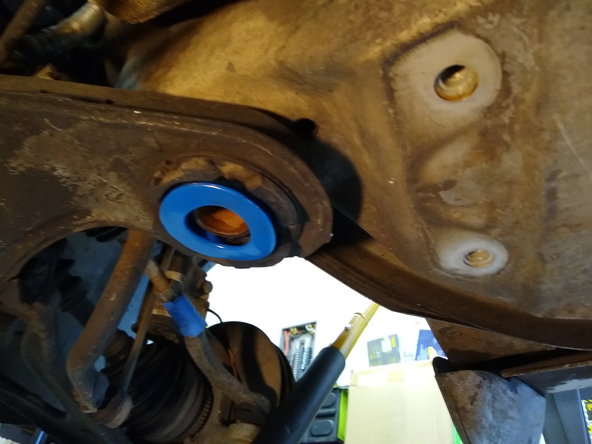

thanks again. I put a little red locktite on them to be sure. I don't do much driving anyway. Those bushing inserts are looking better by the day..

You can reuse the 14 mm bolts, The bushings you got in the picture are for the rear of the car, the front ones should all be identical with same part number. You're in the homestretch now.........just get the right parts and finish the job, I'll pretend I didn't read that part about the bushing inserts! :D

I torqued the 17MM to 80 ft/lbs with a a dab or red locktite. I'm going to the dealer to get the right bushings, but it may be a few days before I can get time to do the work.
Thanks for the advice and support.

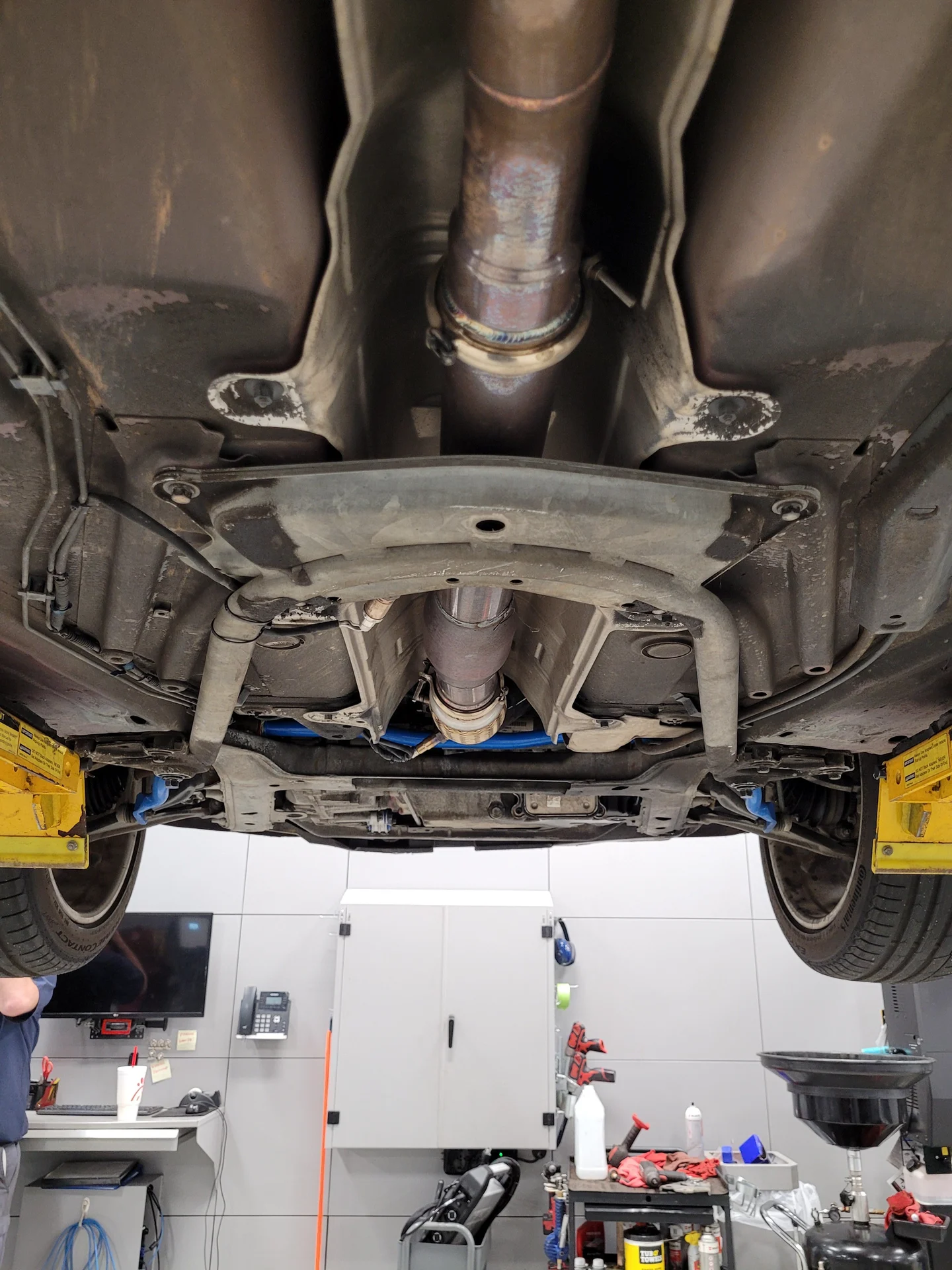

I think the sub frame bushing inserts is one of those inexpensive add on so I think most people don't have it in mind to inspect them. Having done two I either was going to go through the trouble of replacing the sub bushings in addition to the inserts or just the inserts.
Below is the 00 S70 rear inserts. Haven't gotten to the fronts yet. Will do so with the strut install. The rear inserts was part of the rear suspension refresh with springs and shocks besides the U sub frame brace. Purchased from the owner of the car pictured. He had several.
