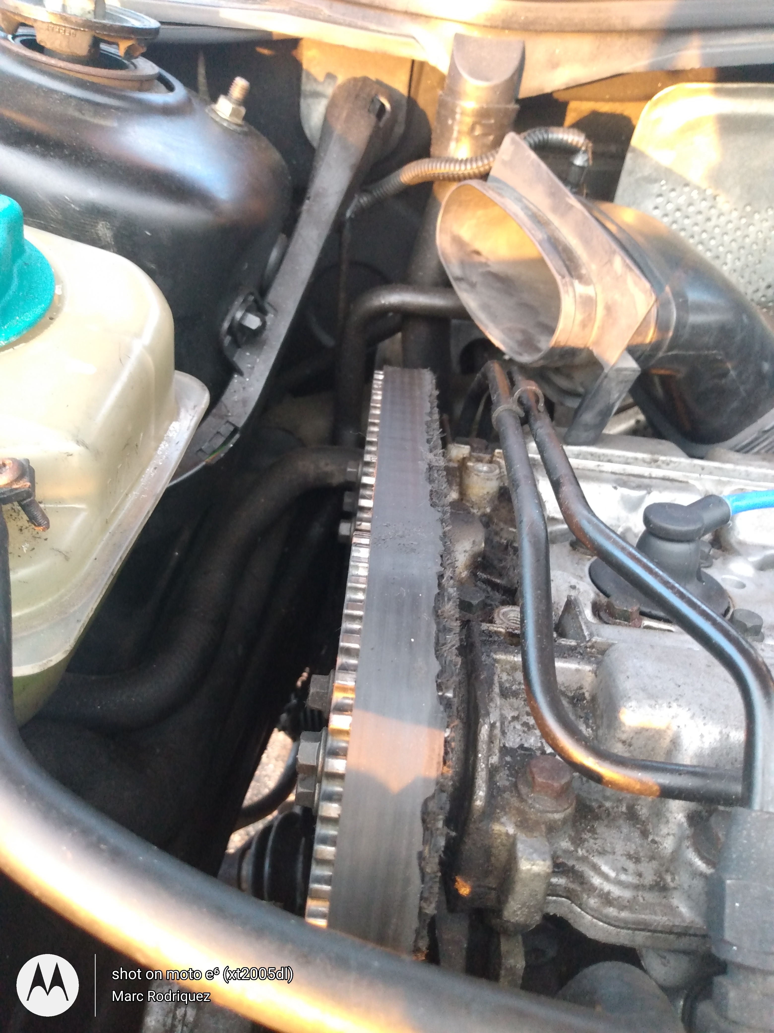

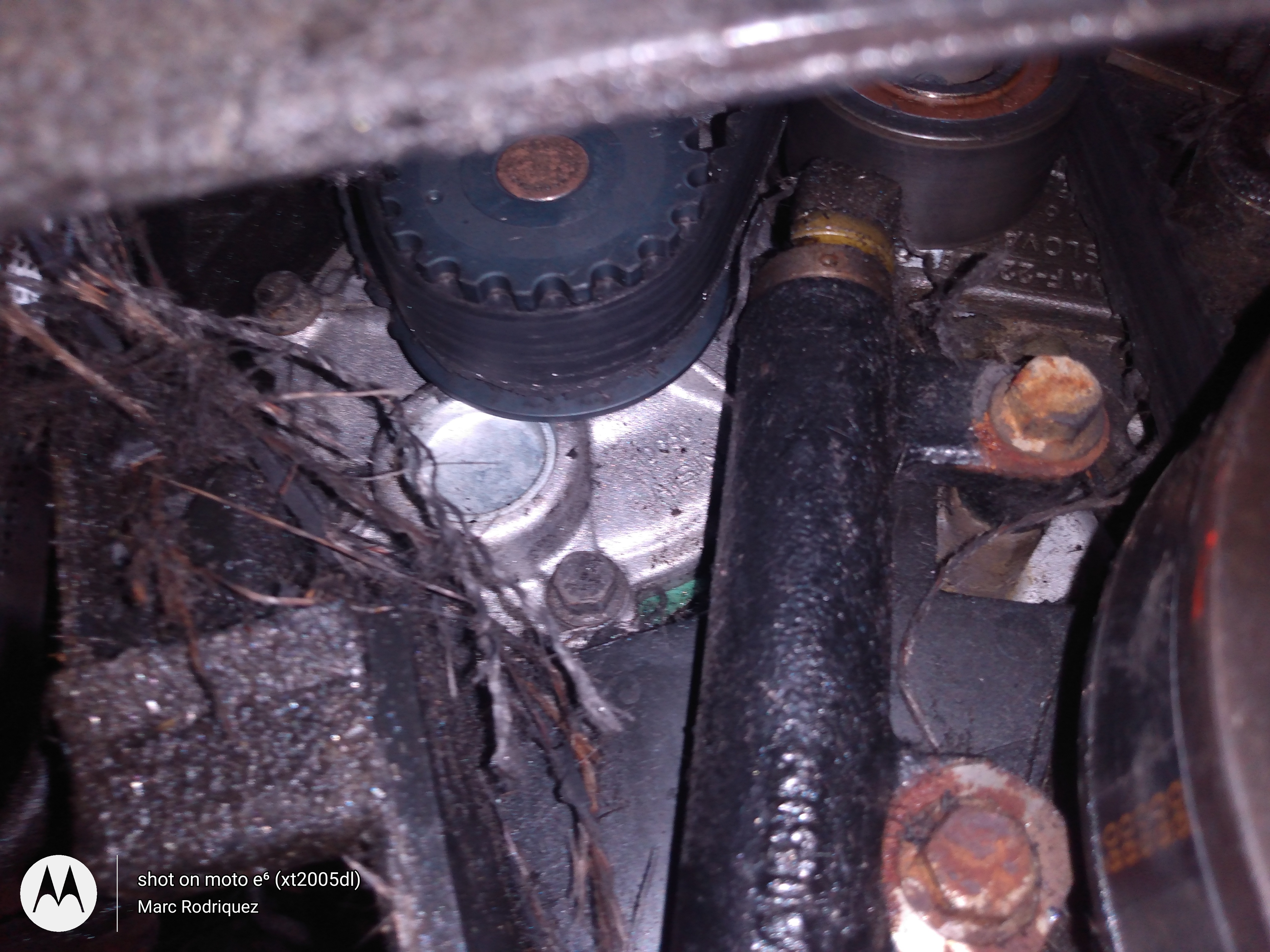

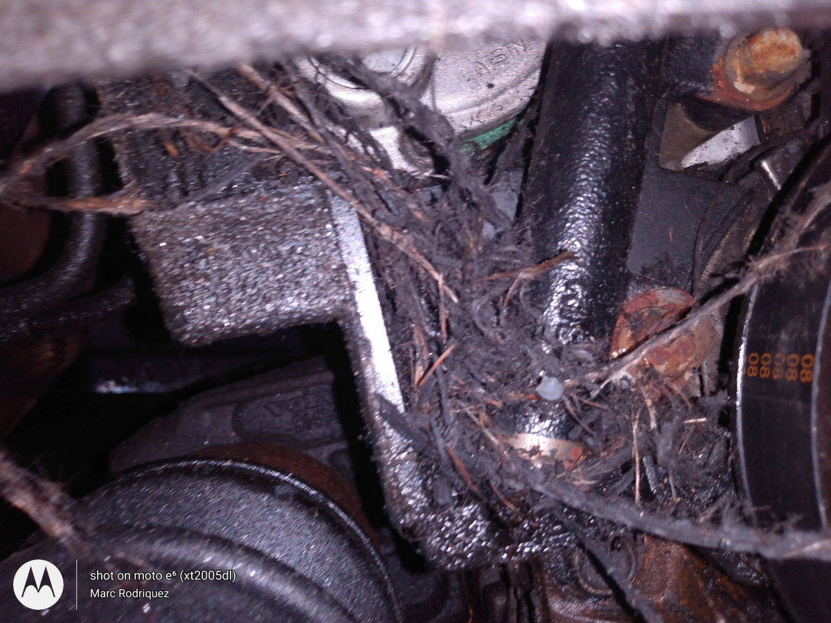

This adventure started with replacing a busted ps pump followed by thinking I had lawnmower syndrome, new starter and PNP switch and it still won't start. Pissed off now and do the one thing that I didn't do when it threw the belt when the ps pump exploded. Check the timing belt.....

Hopefully it will start once I put a new belt on and it didn't skip the timing. Any tips to make this as painless as possible? First time doing a Volvo 5 cylinder.
