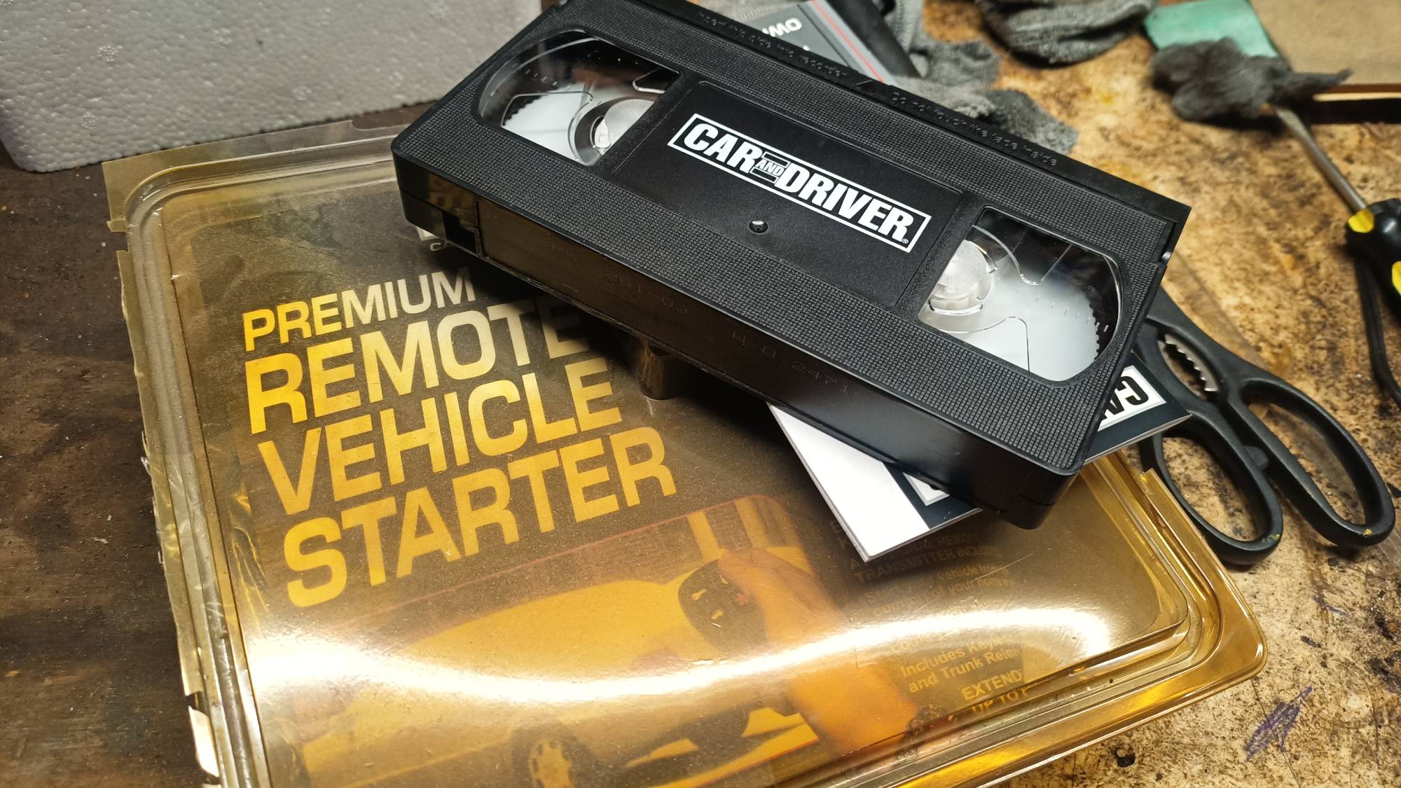

I found a period-correct remote start kit in my stash.
Thoughts?
(I no longer own a VCR)

Culito wrote: 12 Oct 2023, 07:27 I found a period-correct remote start kit in my stash.
Interesting! Anything C&D I love. So that's a C&D brand remote starter?
Also -> Amazon link

C&D branded, made by Bulldog.
