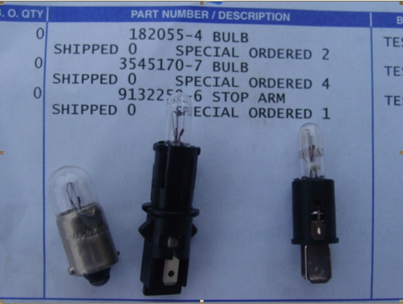

1997 850 GLT
I replaced the bulbs in the center console and glove box. The center console bulbs include the cig. lighter, front ashtray, rear ashtray, and shifter. I could not find the ashtrays bulb (same bulb for front and rear ashtray) online so I got it from the local dealer.
The glove box bulb (182055-4, $1.72 each) is on the left in the attached photo. I got this from dealer but other posts indicate you can get this online.
The bulb for both ashtrays (3545170-7, $5.17 each) is on the right in the attached photo.
The bulb in the center is for the cig. lighter and the shifter position indicator.
