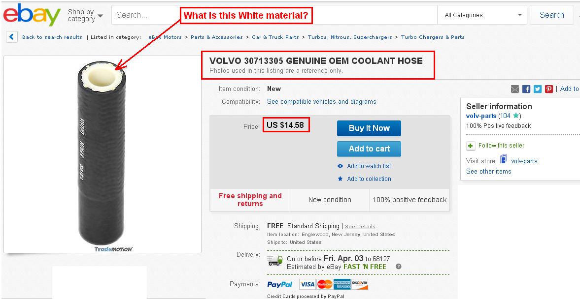

Update re SHORT hose PN 30713305 (right behind cylinder head area).
Two years ago, the factory hose (probably original) swelled (but no leak), so I replaced it with some fuel hose I had lying around. Two years/24K miles later, I got "low coolant" message. This fuel hose developed a pin-hole leak!!! This fuel hose basically hardened like brittle rubber, it feels like plastic!
Called Volvo dealer on Saturday, they won't be able to get it until next week. I had no choice but to head to local Advance Auto parts store and bought a short section of generic coolant hose, the 3/8-inch type. Took 10 minutes to fix it and refilled with coolant.
In the future, maybe 2 years from now, I will use OEM hose.
I have a question for chemical engineer gurus out there (or anyone), from looking at internet photo, it appears that this hose has the INNER layer made out of some WHITE material, maybe this is to handle the additional heat from the exhaust system (in addition to the hot coolant at 90C).
What is the WHITE material that makes it withstand heat better than standard EPDM stuff? The price includes shipping but normally, this hose is only $7.

All the multi-colored hoses I see contain some kind of silicon for higher temp applications. I got some blue heater hose for replacements of many of my lines and they all had some red/orange colored material inside. When I removed my OEM hoses, they all seemed solid black. I've never seen ones with white insides. Well, at least not from my car.
