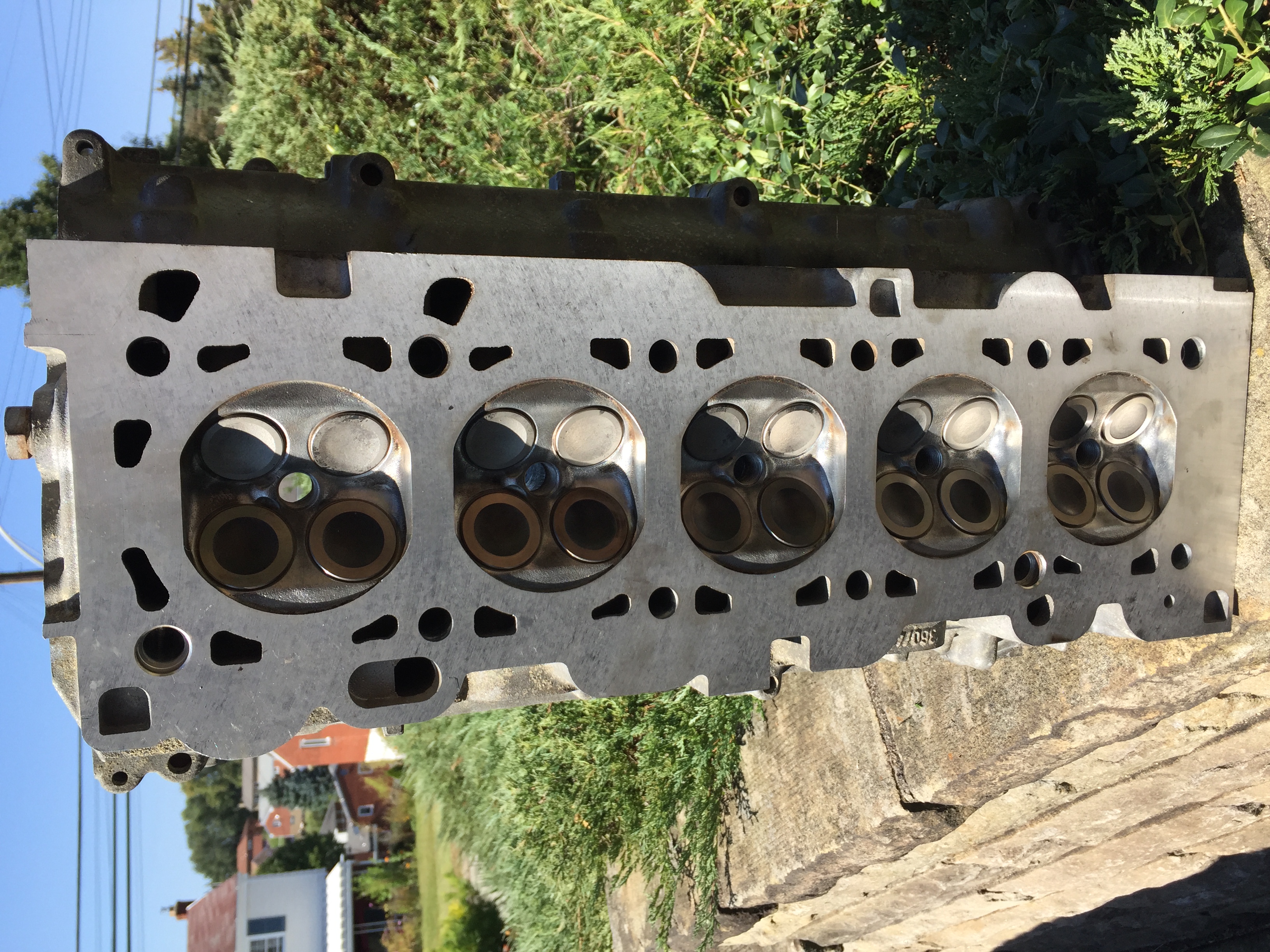

Here's mine, but the shop did all the work on this one:

Jazzer wrote:The machine shop did a beautiful job of cleaning the head as well as a valve job ($314), in 2 days to boot. As I clean up the block in preparation for assembly, I'm curious: I have read in this forum and others that scotch brite pads should not be used. Yet in multiple online resources the most common method of cleaning the surface is a green scotch bride pad, along with brake cleaner, wd40, oven cleaner, etc., etc. Should we not use the green pad, or are we referring to a different pad?
That is a great price for a head rebuild.
I would not use the scotch bright pads at all, not worth the risk. I had the pleasure of replacing an engine after 3 days of use after someone else used them. Almost impossible to get all of the particles cleaned out.
