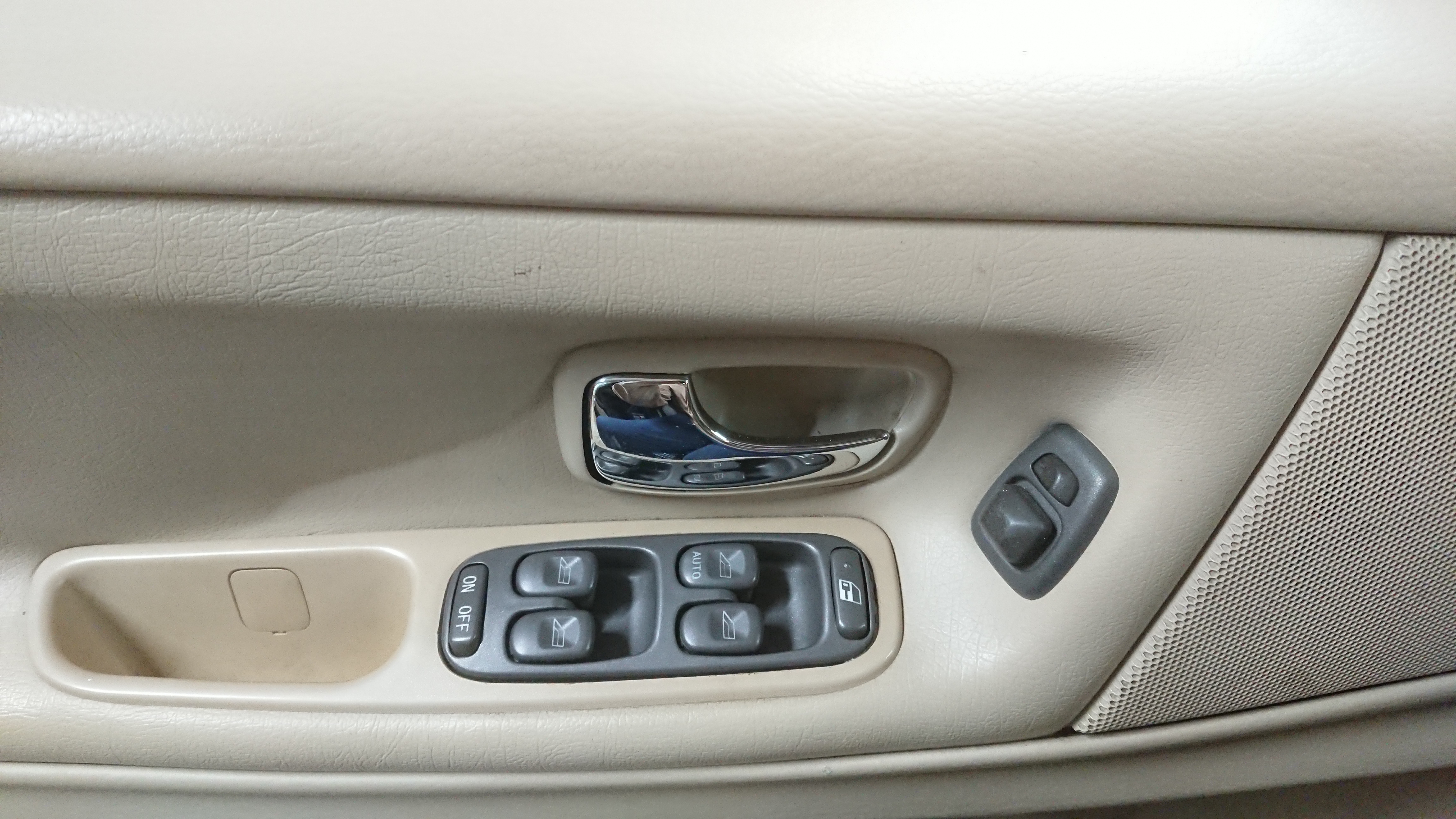

Then I cleaned the door panels and found out that Windex and a bristle brush works great on those grimy vinyl surfaces. I tried GreenKleen first, but that did nothing.
Once I had that done I replaced the super disgusting driver window switch with a new $25 Ebay one. It actually looks to be well made and it doesn't have that sticky coating.

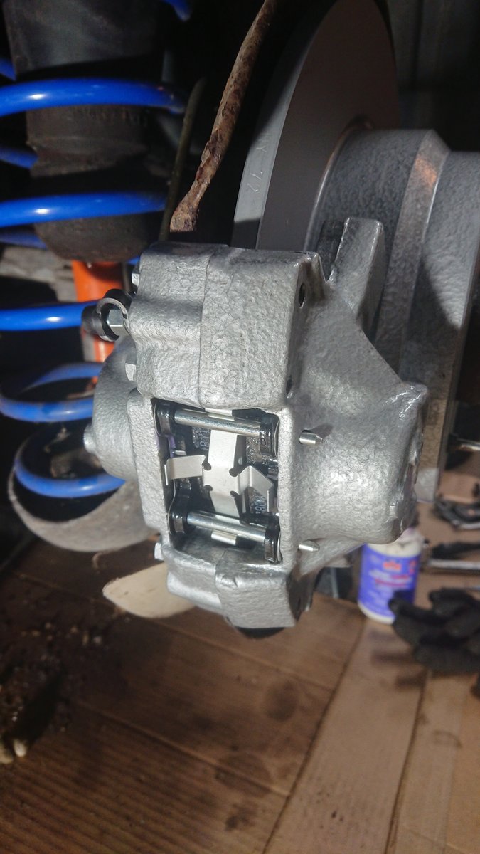

It's been a while since the last post, but I got a few more things done over the holiday weekend.
The brakes are all up to snuff now, I replaced the rears including parking brake shoes and rebuilt calipers, which was not planned initially. The calipers are Centric ones from Rockauto. They make a good impression but time will tell if they last. Rotors are Zimmermanns and pads are Akebono.
I guess I was a little naive about the rear brakes, thinking that I could just replace the pads and rotors. But when I took things apart I was greeted with a frozen piston in each caliper, and the parking brake shoe linings fell to the ground
A nice surprise was that both cables were intact, I wonder if they were replaced at some point already. After this I replaced the brake fluid and bleeded the system.
Then I addressed the broken exhaust hanger in the back, which was completely rusted off. A modified hanger with a regular 2 1/4" clamp did the trick.
The tailpipe was a rusted mess as well. I cut that off and installed a round stainless steel one which was standing on my workbench for years. I also polished and waxed the rims and installed shiny new center caps.

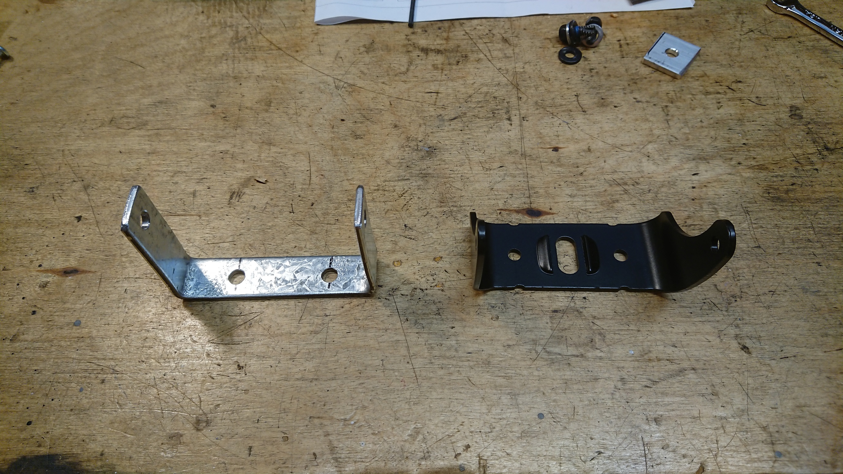

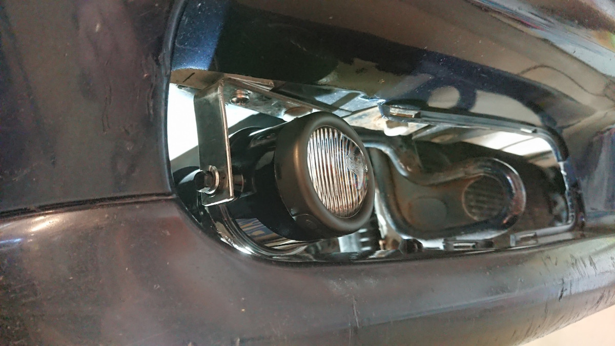

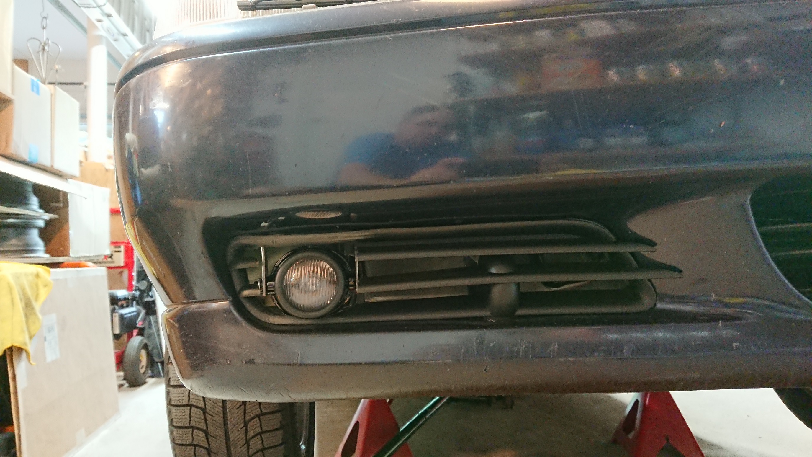

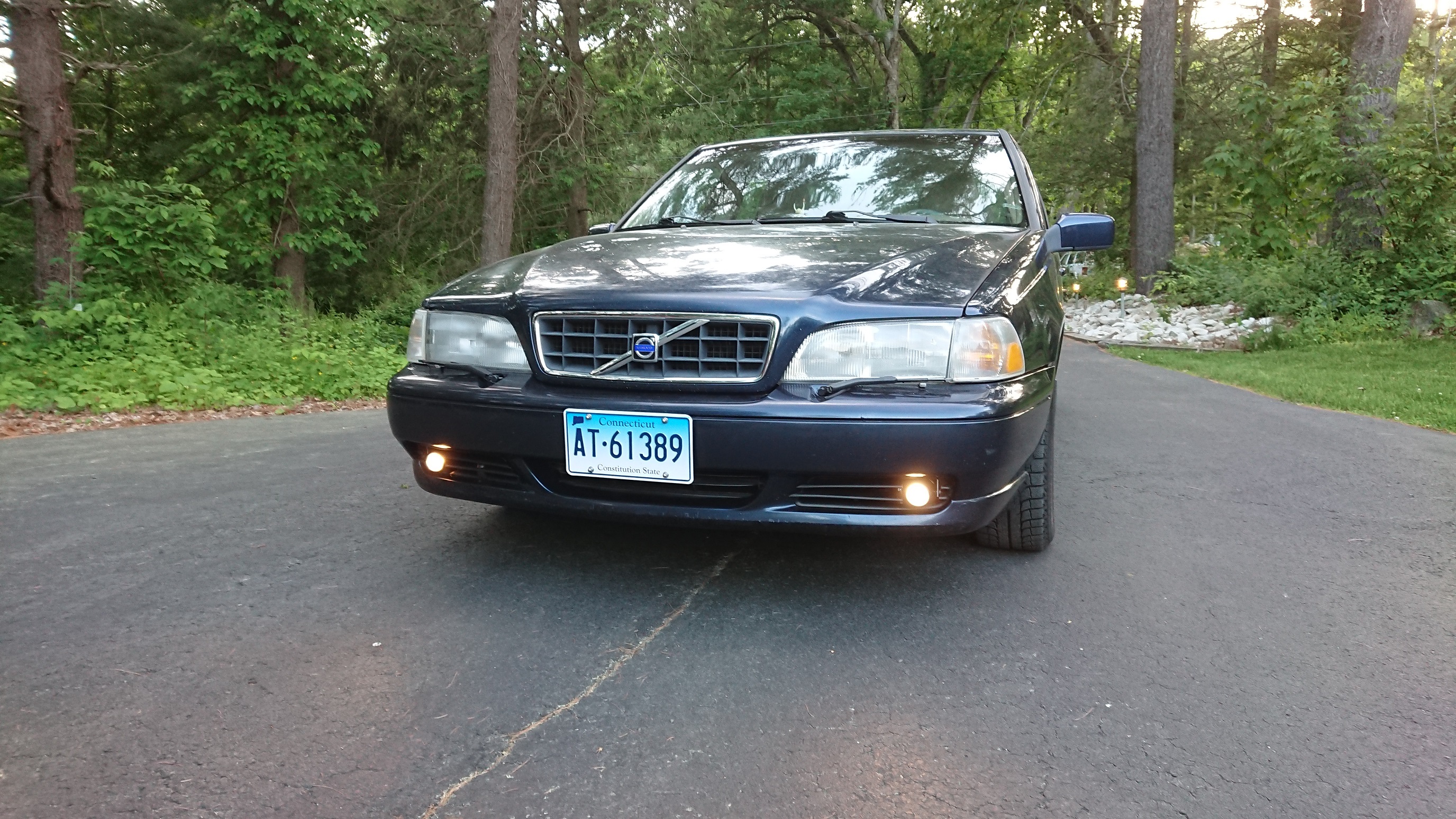

I was exited to see this in the morning: Last weekend I was able finish the driving light installation. This took a lot more time than I thought, but I was fooling around designing new brackets that attach to the end of the frame rails. This did not work out and I came up with a better version that attaches directly to the underside of the bumper. Here is the finished product. These are Hella Micro DE projector lights: Here is the the new bracket vs. the ones that came with the lights. I knew these would not work because of the offset of the mounting holes: From the outside:
(I used one mounting screw of the bumper cover and a spacer for the other screw) From the inside: Another very time consuming thing was making the cut outs in the grills. The plastic is super soft, which makes it easy to cut, but hard to smooth out. I feel like this just looks too messy and I will make new ones when I get a chance. This time I will use the grills for the OEM fog lights unmodified and then make separate surrounds for the driving lights. Here is a close up: I also want to take the brackets off one more time and paint them black, they are kind of noticable right now.

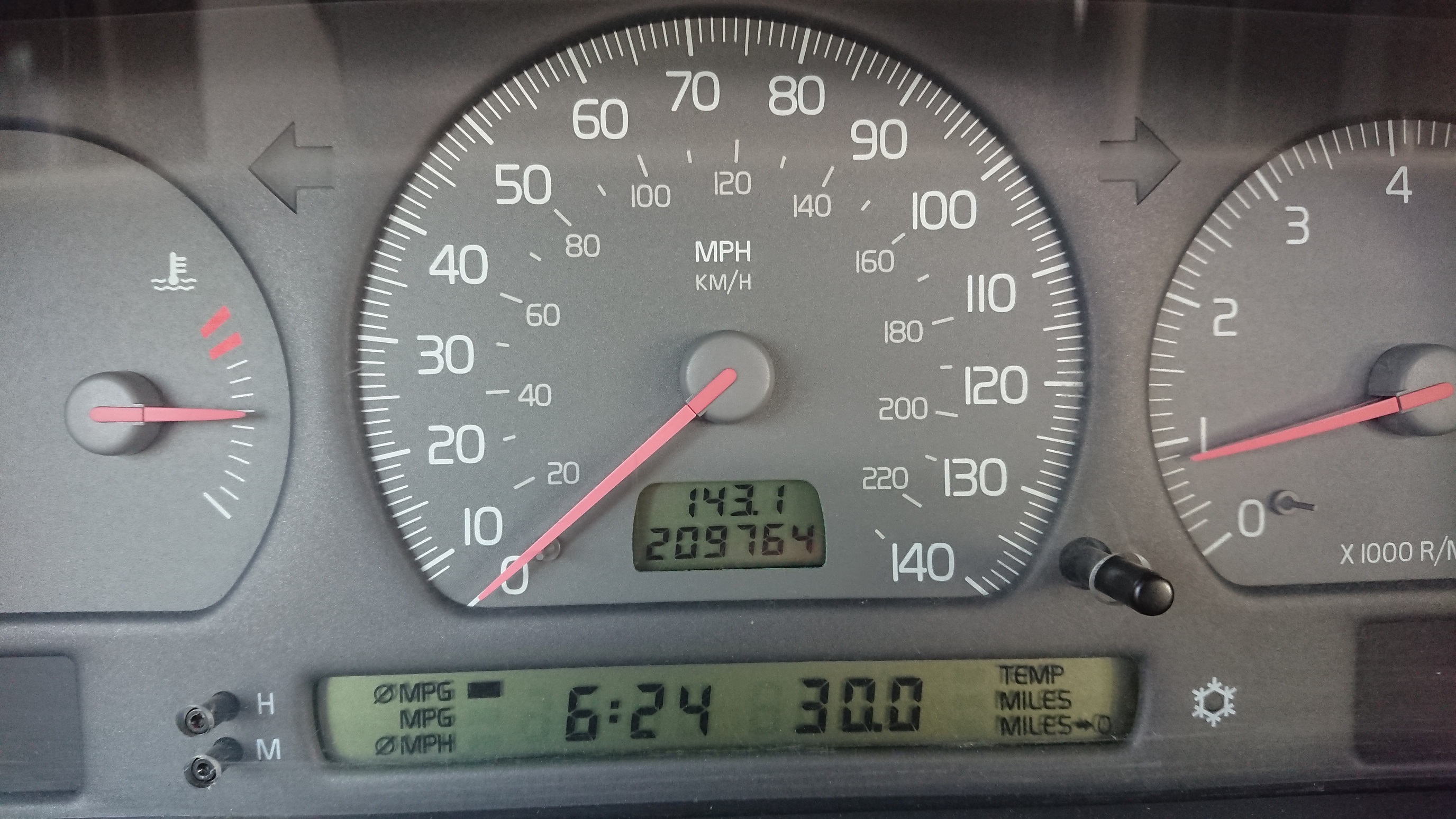

Yeah - Im getting >30 mpg out of Evita, the base Black S70 with new plugs. The NA 1999 engines are dreamy smooth and stingy on gas.

Very cool, Dirk. If you snap a photo of the lights at night, can you post it? I’d like to see the amount and pattern.850 LPT wrote: ↑14 Jun 2019, 07:59 Last weekend I was able finish the driving light installation. This took a lot more time than I thought, but I was fooling around designing new brackets that attach to the end of the frame rails. This did not work out and I came up with a better version that attaches directly to the underside of the bumper. Here is the finished product. These are Hella Micro DE projector lights:
- 850 LPT
- Posts: 1961
- Joined: 27 May 2011
- Year and Model: 96' 850
- Location: CT
- Has thanked: 331 times
- Been thanked: 242 times
Absolutely Matt, I will try to do that this weekend.
