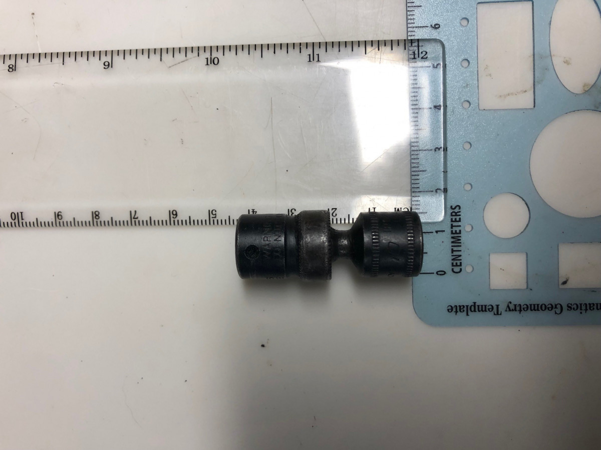

This is what works for me on the Volvos I have encountered. The dimensions can be seen - the 10mm socket portion is about 13.5 long before it starts to taper. Looks like it swivels about 30 degrees in all directions - rotating on a ball and socket construction.
I am not sure what a 1/4" wobble extension would provide, but the socket would not be as wide and would be about the same length - the dimensions of your donor 10mm socket is on the long side.
I forgot to mention - the first time I looked into the repair I read that people remove a bracket and grind it so that next time the job has to be performed there is no problem. As I never had the problem I did not do any grinding. But it maybe that the only way yours is going to come out is to remove that bracket - not even sure it is applicable in your instance.
