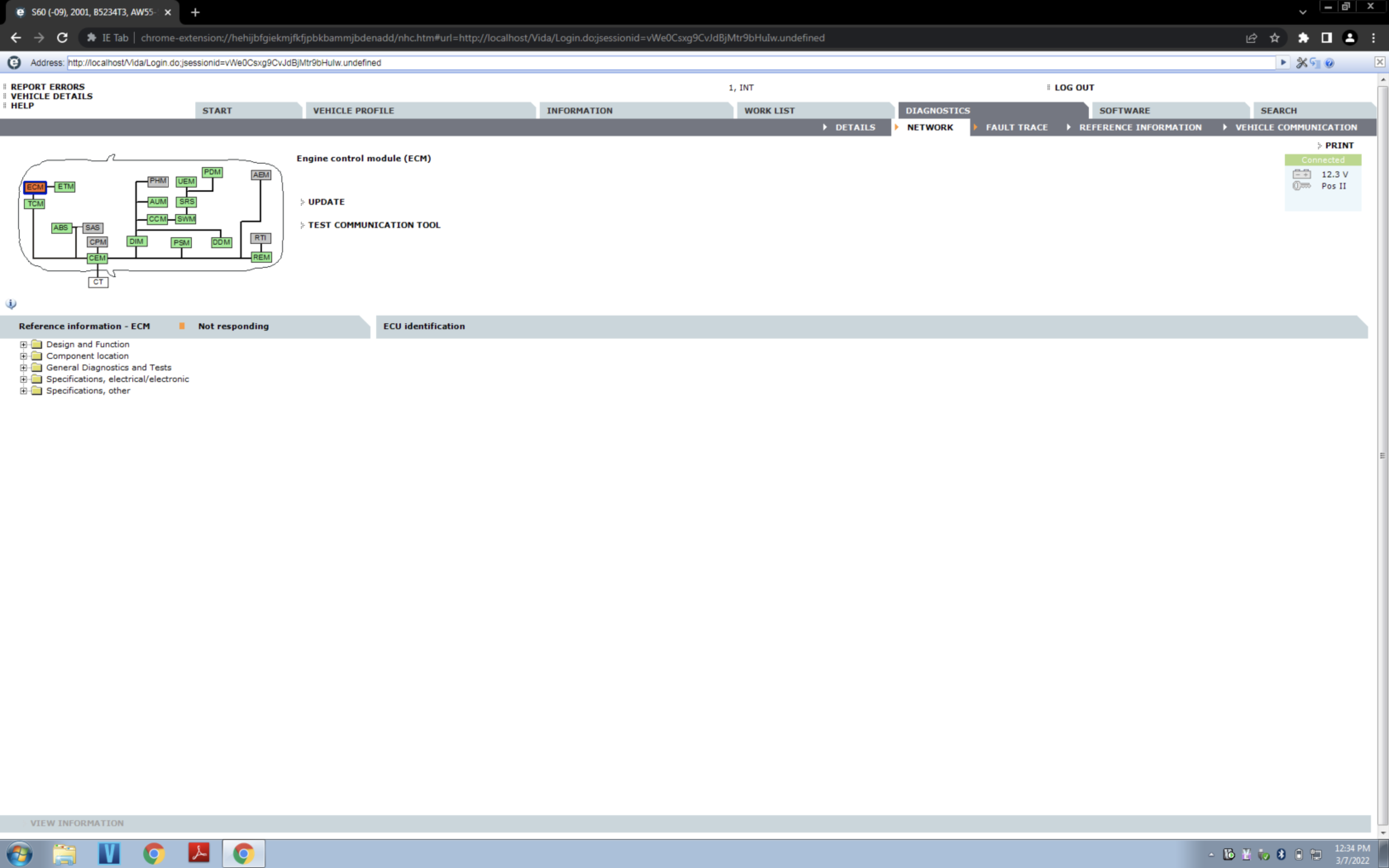

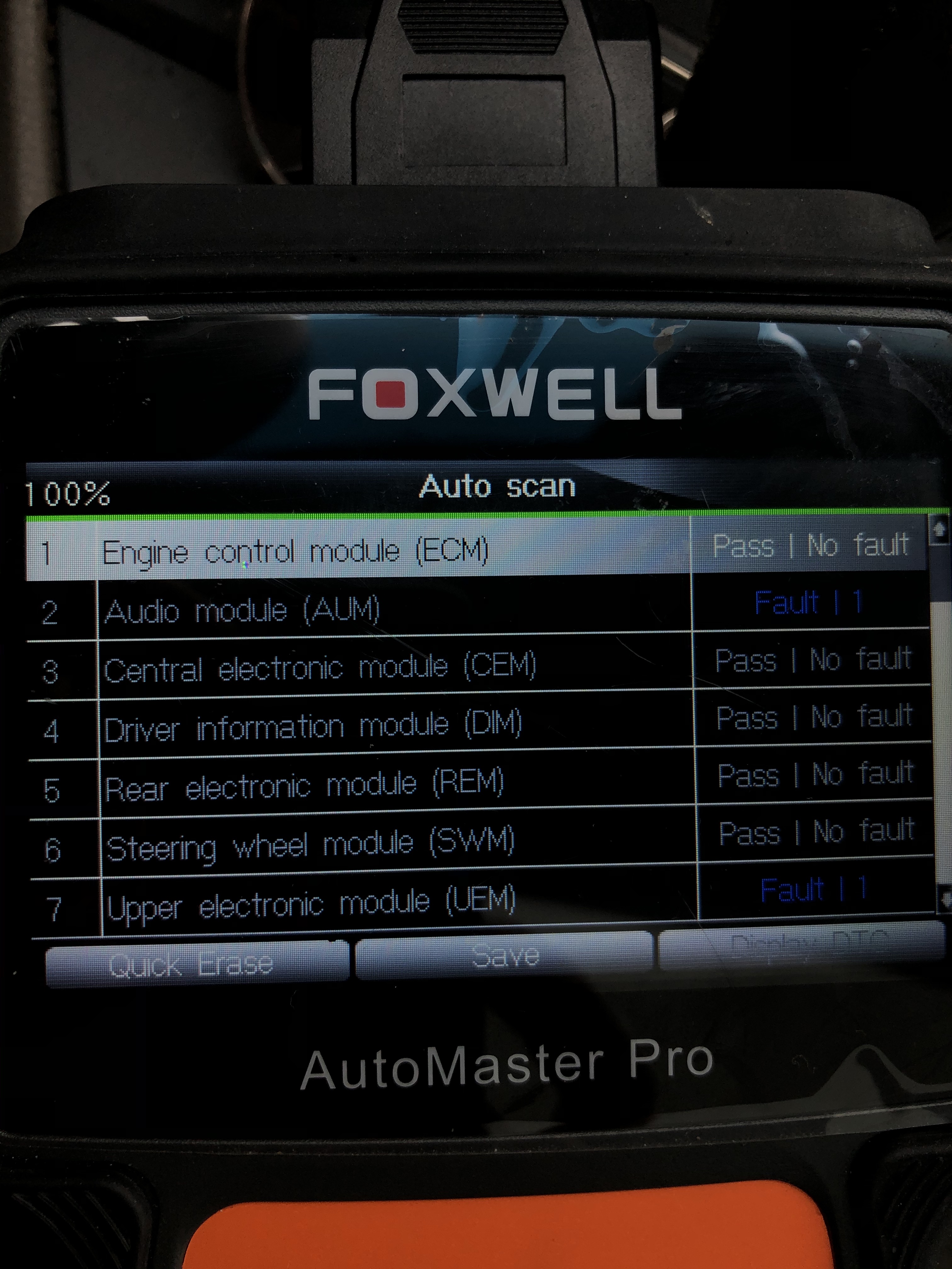

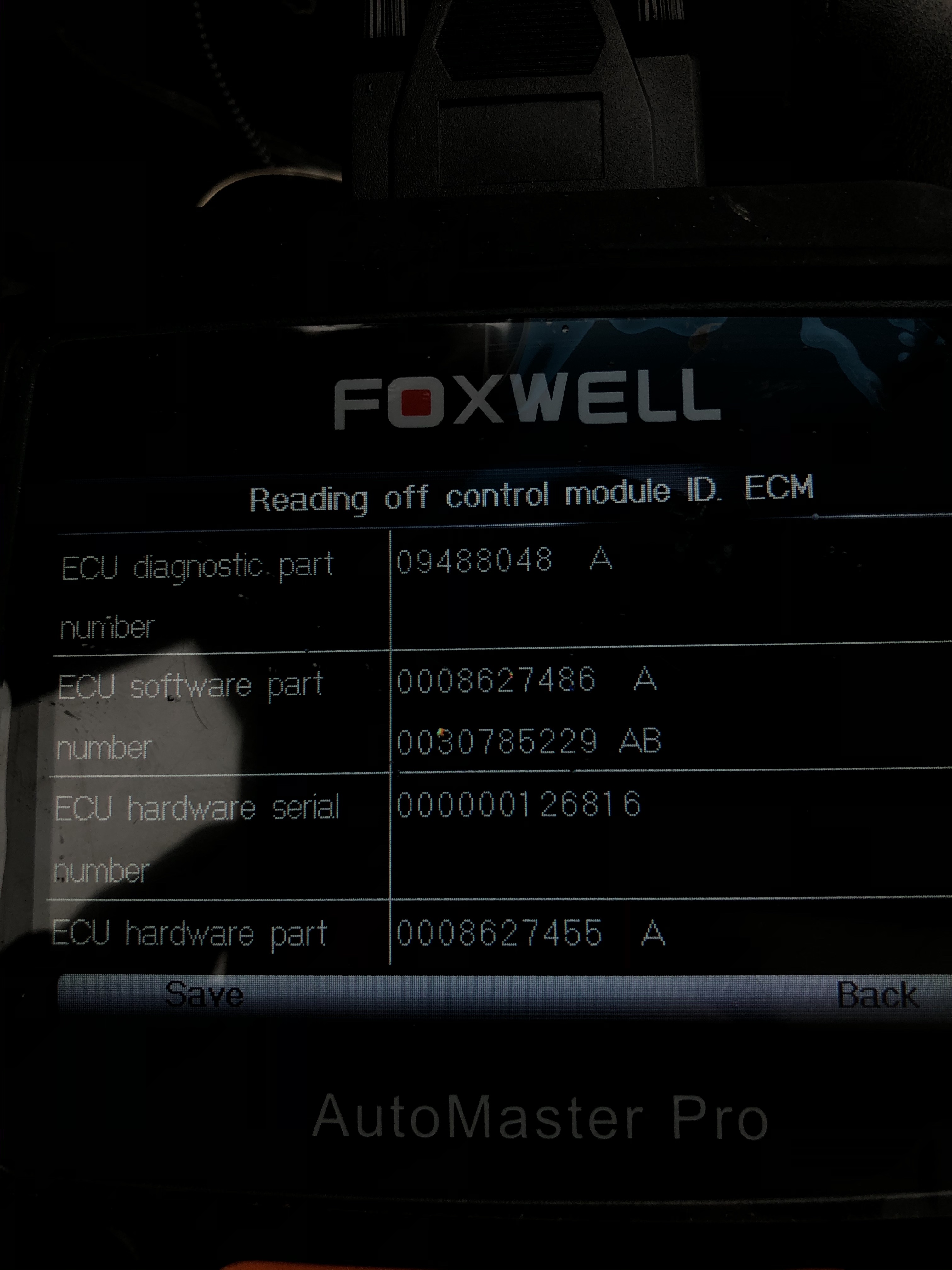

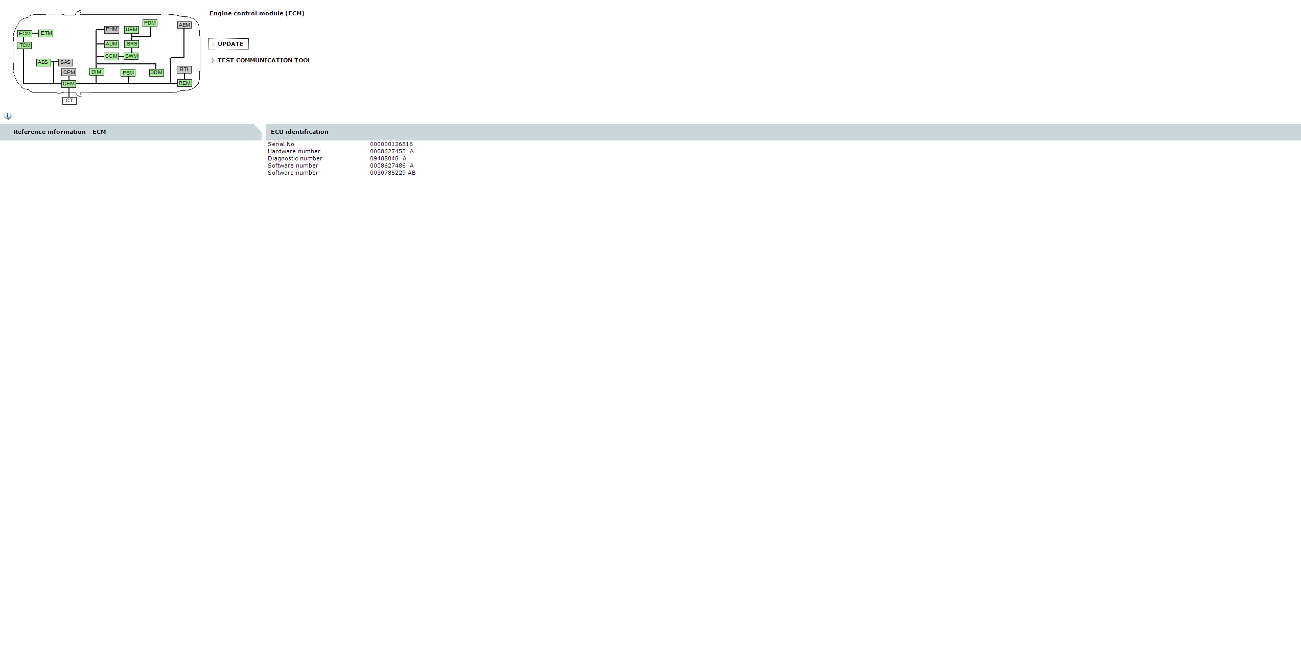

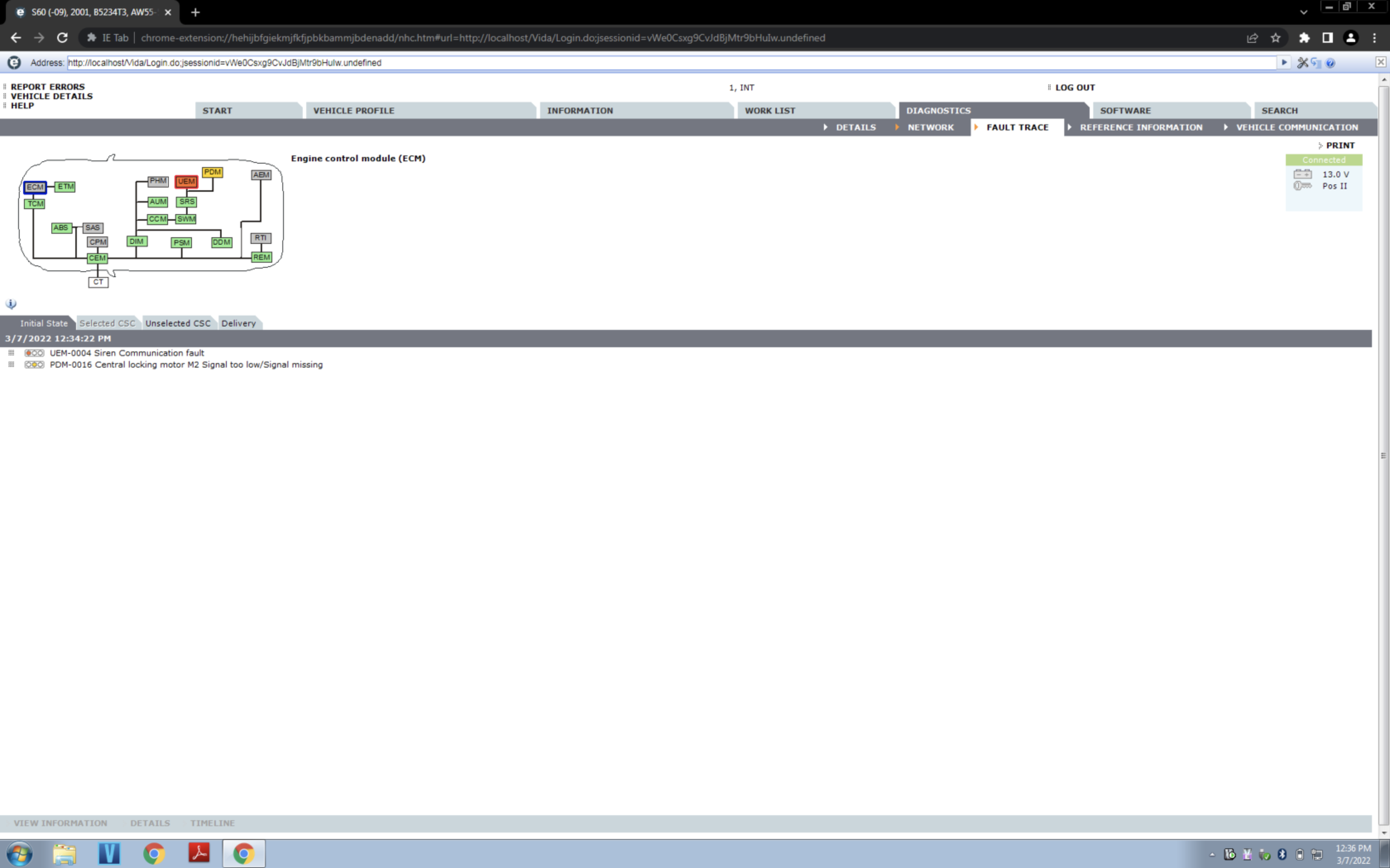

So I tried both V160's and I also tried using Vida through IE to make sure it wasn't my chrome addon, I still have the same issue. ECM is not responding. I pulled out my Foxwell scanner and was able to connect to the ECM, read codes, even read the ECM software number, etc. I really doubt that I have an ECM-CEM issue like a cut wire or corrosion on a pin, I doubt the car would even start if the ECM wasn't taking to the CEM but correct me if I'm wrong on that.
I've attached a whole bunch of pics from vida with chrome, vida with IE and my foxwell reading the ECM.

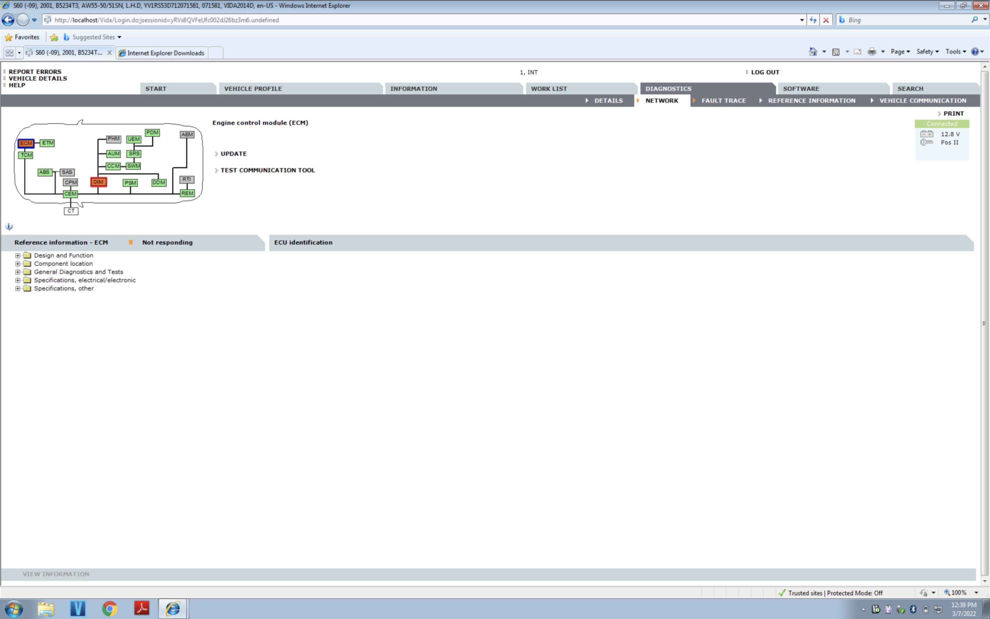

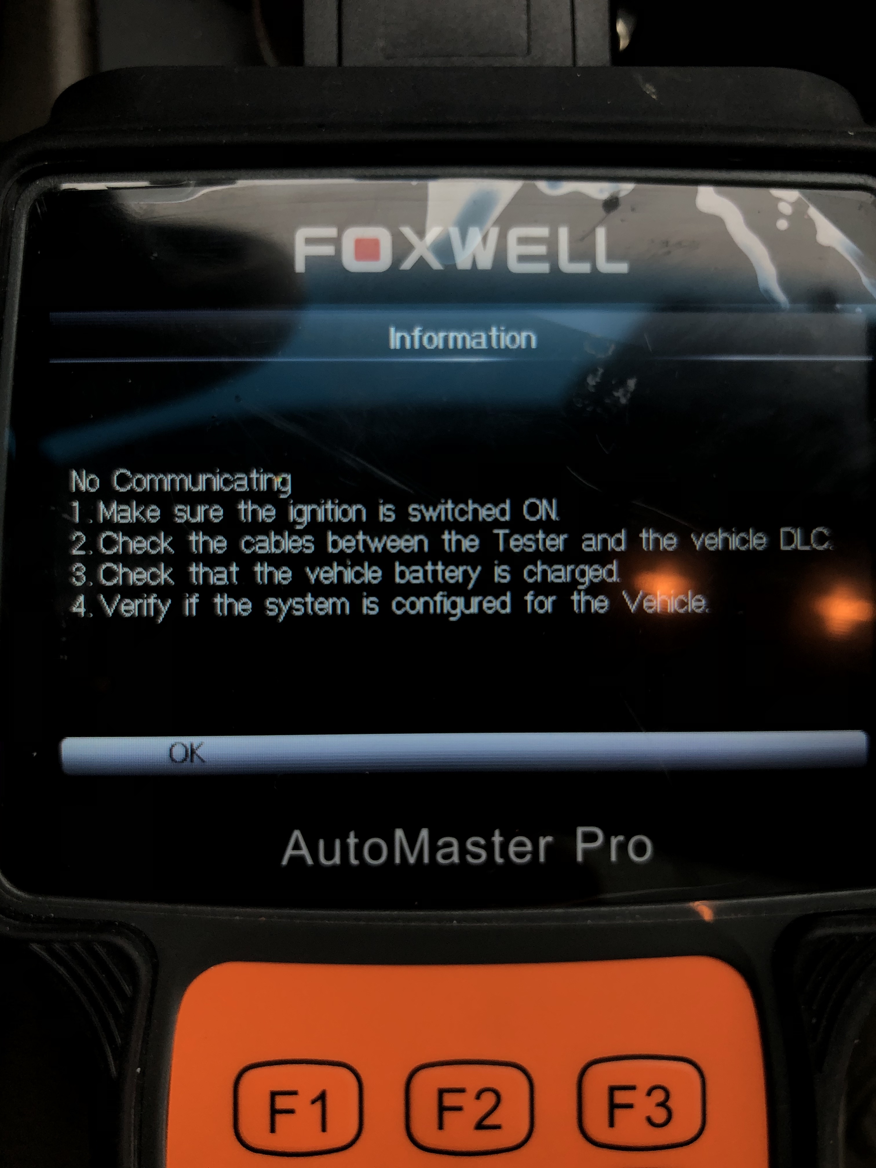

This did not actually happen but I just wanted to show what happened if the foxwell could not communicate with the ECM, I did this by not having the key in the second position.

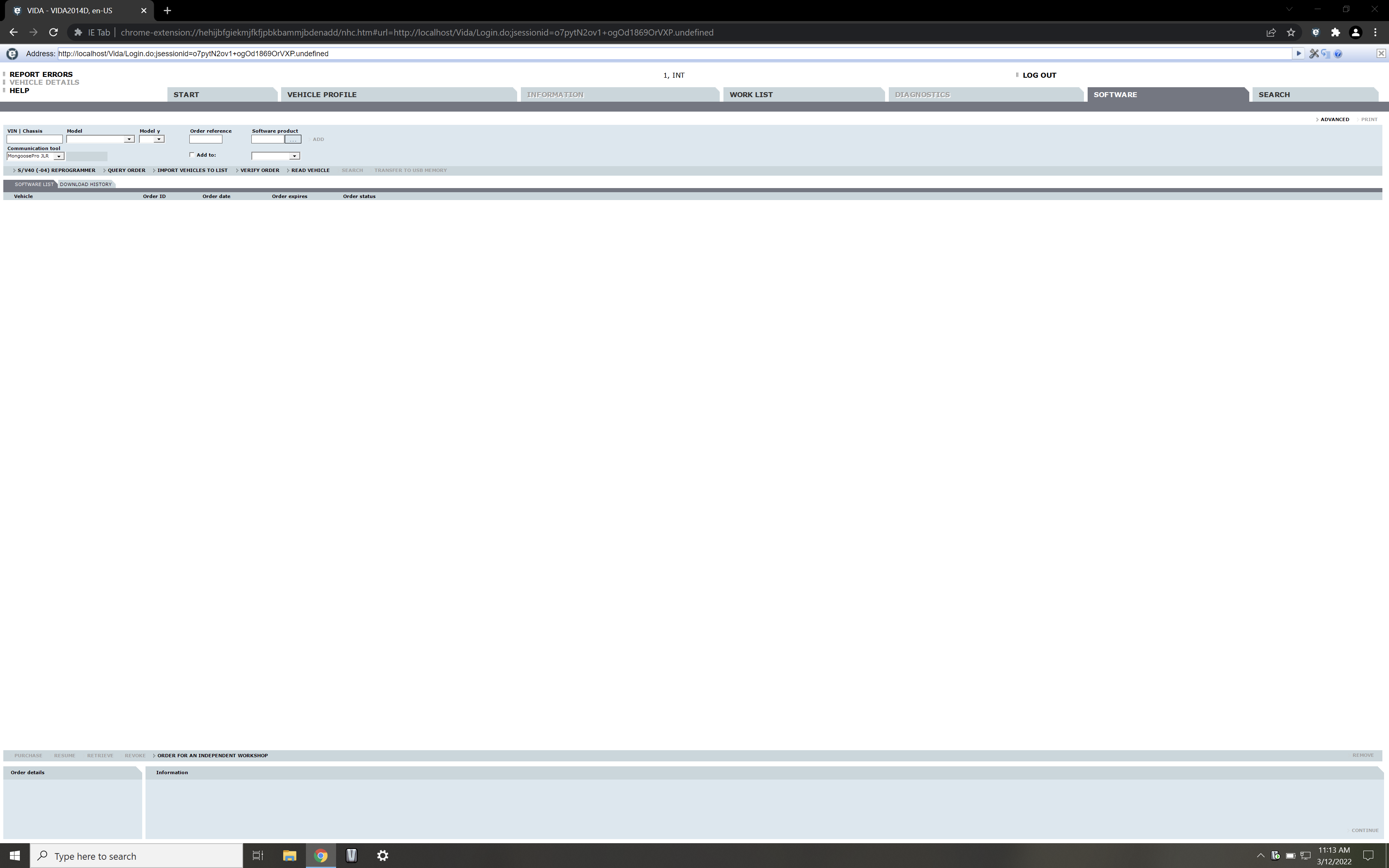

Update, after making another Virtual machine with windows 10 pro following Trixeo's tutorial on Swedespeed, everything is working. Only thing I'm dealing with right now is the weird aspect ratio
I'll swap it over to Google and see if that solves it.

I was on windows 7 pro & vida 2015A when I wasn't able to communicate with the ECM. I decided to give windows 10 pro a try so I made a completely seperate VM with vida 2014D from another source. People say that vida 2015A is just a rebranded 2014D so I thought it would work with the JLR but I guess something wasn't right. Trixeo has a step by step post on SS and I downloaded vida 2014D and the patch off of VVDE.info
