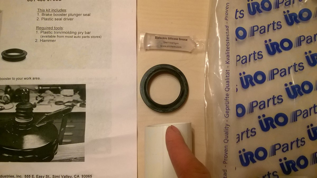

Got the brake booster seal from URO, waiting now for a moment to install it - in fact I will first practice a little at the junkyard. Have to say the quality looks good, there is some silicone grease and the pipe used to press the thing has an angled end (important) and the URO video also shows an important part about bending the lip of the seal at @2:30
