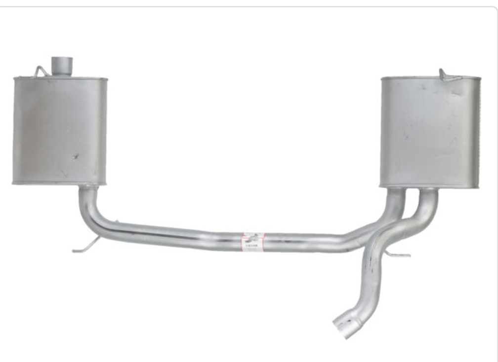

The wagon is still running good. I was wondering if anyone has experimented with removing one of these mufflers for some more tone. Are they both mufflers, or is one a resonator?
I was thinking of eliminating / bypassing the first one in line.
Thankya.
V50M66
Posts: 289
Joined: 21 May 2023, 11:05
Year and Model: 1998 V70 AWD
Location: New England
Has thanked: 26 times
Been thanked: 94 times
Post by V50M66 »
I have played around with this a good bit. Removing the blocked off one (right one in your picture) is very difficult without a welder, some tight bends, and creativity, so I haven't tried that.
However, I have removed the muffler on the left side of your pic and replaced it with a pipe (and welded on a hanger). It's pretty easy and sounds great. More sound, and there's no drone whatsoever. It's basically stock until you get into it, when it gets loud, toned, and sounds fantastic. Highly recommended.
I also tried cutting both out and it droned like crazy, so don't do that.

Nice, Thanks! I shall dust off the sawzall.
