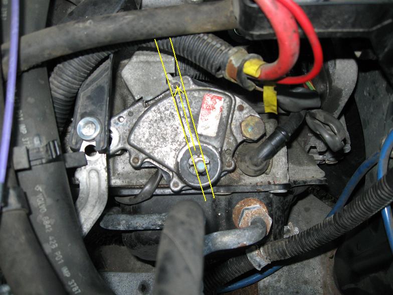

polskamafia mjl wrote: Alignment and Reinstallation:
Unfortunately I was not able to use MIJ’s method for alignment. I don’t understand how he
gets the reverse lights to work with the battery out of the car. So, with no other options, I kept
things simple. The Volvo tool aligns the middle bolt with the groove going down the middle of
the PNP housing. So, I decided to get as close to parallel between the 2 w/o using a Volvo
alignment tool. Here is a picture of what I mean.
So what to do. Put the shifter in Neutral. Align the PNP switch as shown, and screw the shifter cable down into place. Then bolt the cable arm to the central bolt of the PNP. [...]
The step highlighted red needs some clarity...assuming the step is key part of Alignment and Reinstallation, I ask those with this repair:
1) where is "Put the shifter in Neutral" applied, is it at the gear shift lever inside the car?
2) wasn't the Shifter at N - Neutral at the outset of this repair?
