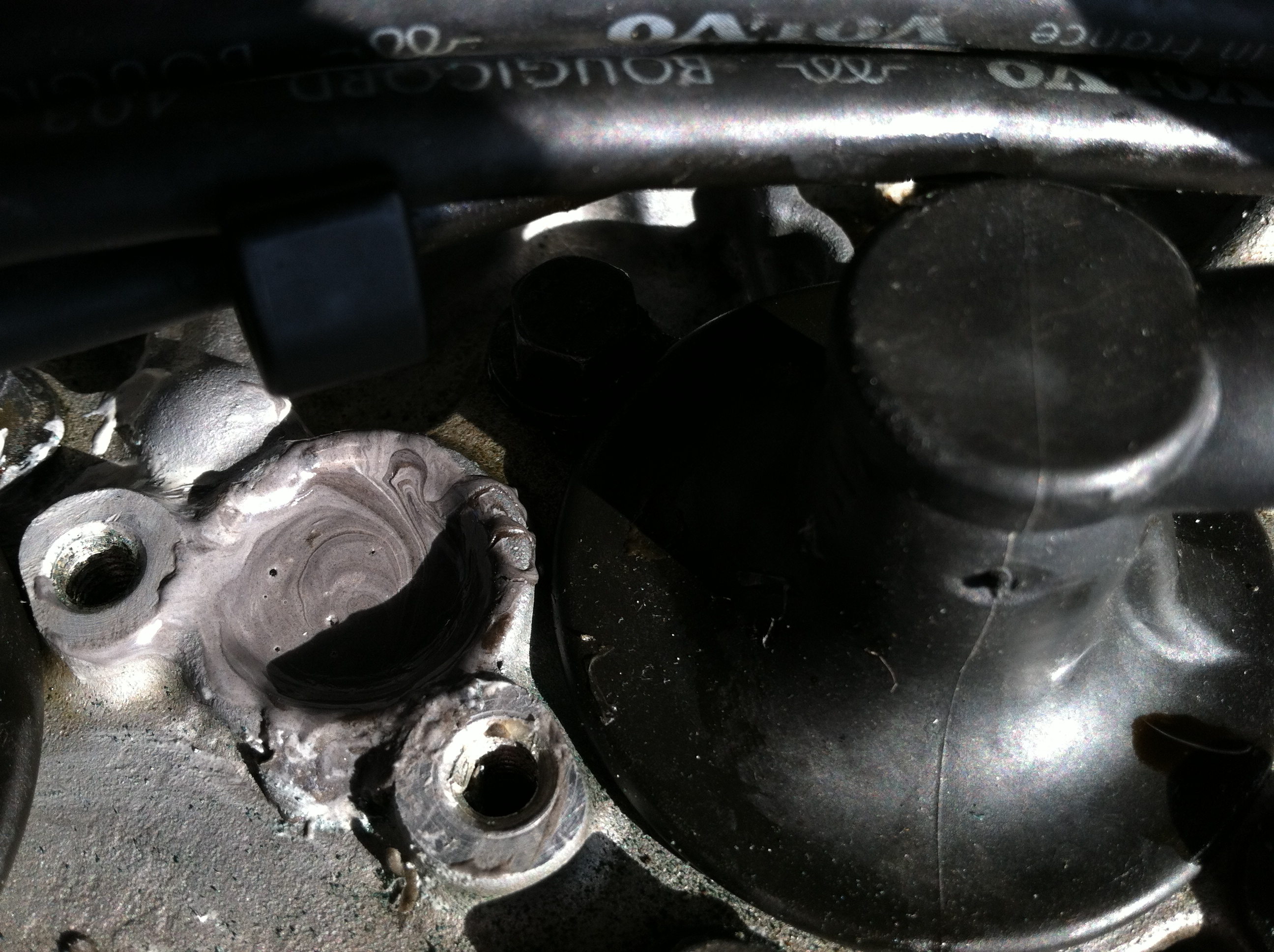

If I may suggest another more nuts and bolts solution that might work;
1. Buy, borrow, steal a tap and die set.
2. Get a fine thread bolt the width of the aperature, cut short to fit.
3. Tap out aperature.
4. Install bolt in hole with some red loctite or RTV on threads.
5. Relax

The bolt idea is tempting, but I had a hell of a time getting that other bolt to quit leaking too.
Cleaned and scraped all the old JB weld out tonight, sanded all the stuck on stuff out, and cleaned it thoroughly with acetone. When I stabbed into the plug with my knife blade, oil gushed out like I was dissecting something in Biology lab. It was almost like oil had found its way in between the bits of the weld.
I got the high temp, high strength JB weld this time. Noticeably harder to squeeze out of the tube (I actually busted the end of it open squeezing on it), but I checked on it after 6 hours and it seems to have hardened into a much firmer plug than the quick-set stuff that reminded me more of silicone in a way. Again, looks like its made a real good seal, but theres no telling what will happen.
8 AM tomorrow should be right around the 15 hours for it to dry. Hope it works this time.

FIXED!!!
And this means...for the first time in 5 years...nothing is leaking.
For those of you with this one, the REAL JB weld is a good fix. It seems to have dried much harder than the quick-set stuff.
Before: After:

Good Job...Hope it holds. Had a similar problem for a different (non-automotive) application. I found that there are several manufacturers of (expansion plugs/cup plugs) - "good old frost plugs"....is various sizes including Metric - CarQuest/Napa had Dorman Brand in the closest size in stock. The tapered design provides for a good start and seal - just cleaned the hole completely and applied some Permenant Loctite (Loctite has it's own cleaner/activator) and drove it in the hole. (Sorry for the late reply...just came across this post.) Anyways...Congrats...
