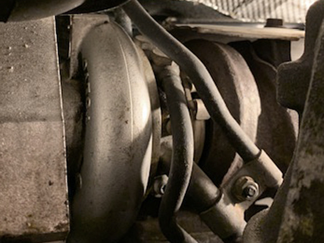

Dry as bone - no longer a blow-by. PCV and oil pan clean up did the job. Running above 17mpg.
