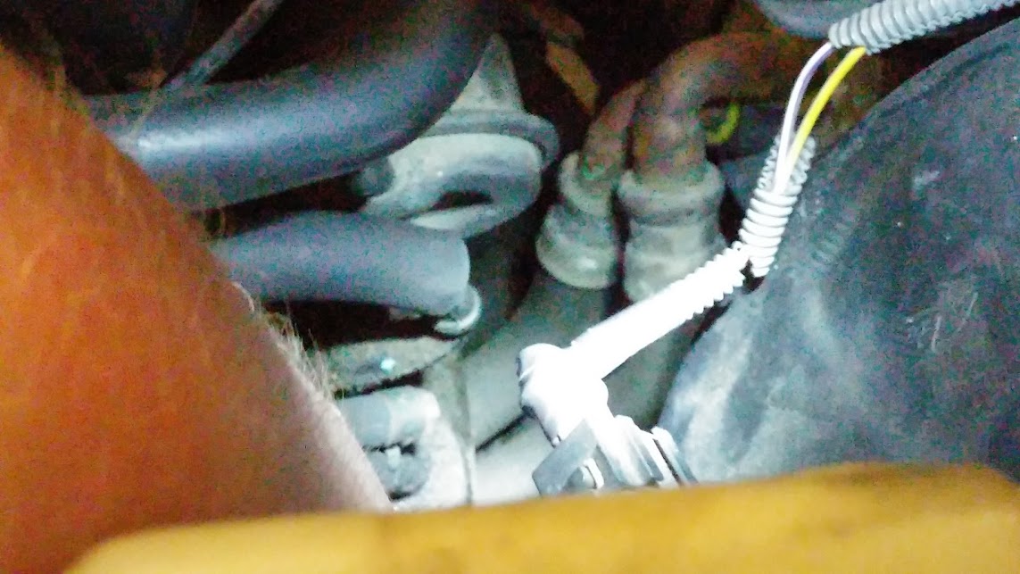

I can't find the other end for the life of me. I would have to move the intake hose and some other hoses that I don't want to mess with.
After looking at some vacuum hose diagrams, I think that it might be the "T-Pipe PCV" hose shown in this diagram.

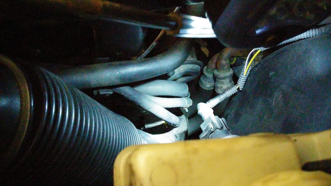

Which brought me to my next question. What is THIS hose for? I apologize for not marking it, but it is the fatter one just next to the plugged one.
It's insulated

T-pipe connects to the PTC but to be sure you really must trace it back to the other end. Is there an open nipple on the PTC?. That T-pipe goes back the the PITA elbow on the intake manifold.
I can't see the two pics from your most recent post, although others in the thread load fine for me. So does the vacuum diagram.

If I am not mistaken,your loose hose looks like the vacuum hose that routes from just in front of the throttle body to the CBV. If it hugs the engine along with the PCV hoses I think you have a winner.

Scholz wrote:If I am not mistaken,your loose hose looks like the vacuum hose that routes from just in front of the throttle body to the CBV. If it hugs the engine along with the PCV hoses I think you have a winner.
Must be that one. I am probably going to look again.

I'll upload the pictures again in a bit. Don't know why Google Plus images won't link properly.

Post by bmdubya1198 »
Here
