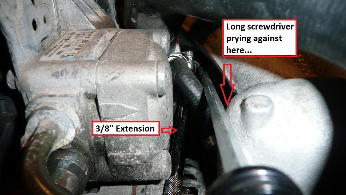

I am happy to declare that @abscate is right. The crowfoot is the ticket for the 2007 S60 2.5T...
For those of you who:
- Don't own the Snapon swivel socket mentioned earlier in this thread (it is btw $32 on ebay).
- Don't want to remove the thermostat housing.
BTW, if you have > 120K, you may as well replace the thermostat with new Volvo gasket.
More on this later...

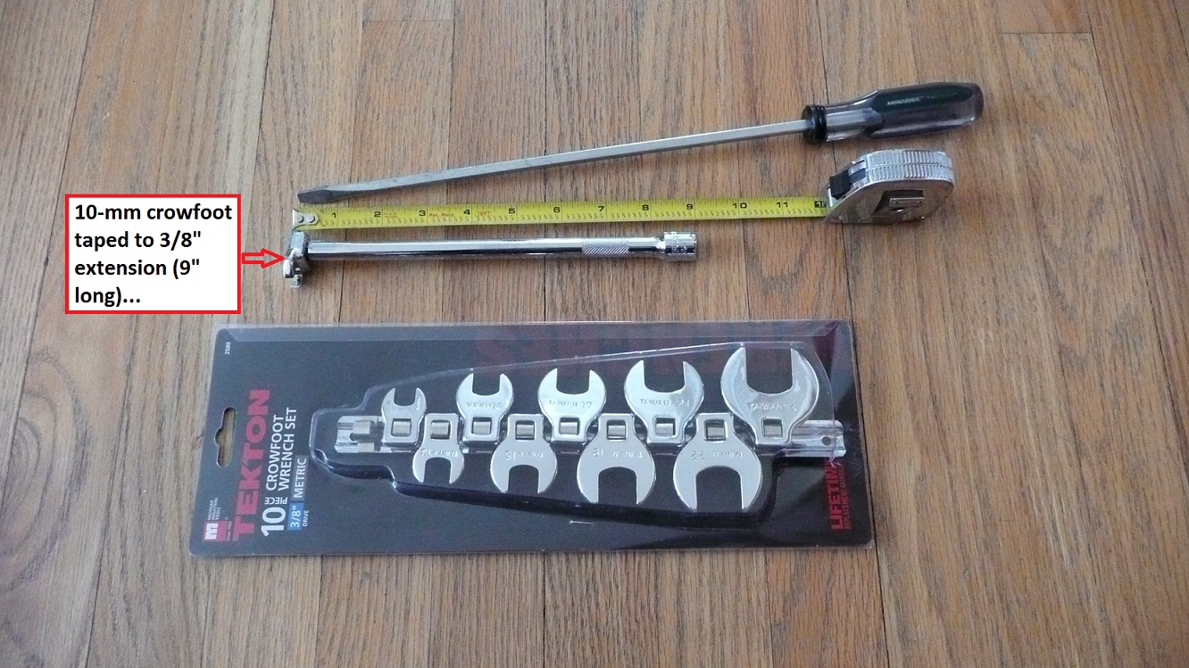

I happen to own a Tekton crowfoot set, just found it in my garage...
- Tape the 10-mm crowfoot to the 9-inch long extension (Harbor Freight wobble extension set)
to avoid the crowfoot from falling off.
- A telescopic magnet (to retrieve lost bolt etc.) is a must when doing this job.
You can always stuff a rag below the area where you work in case the bolt falls off.
- A flash light is a must.
- Torque is about 14 ft*lb per forum. Just tighten it snug and add a bit more.
This bolt cannot come out anyway, it is blocked by the thermostat lower housing.
- Use the long screwdriver to push the crowfoot in so it bites properly.
Use a flash light to check for depth of the crowfoot onto the bolt.
In other words, the crowfoot needs to be squared onto the bolt (both lateral and depth aspects)
to avoid stripping the head.

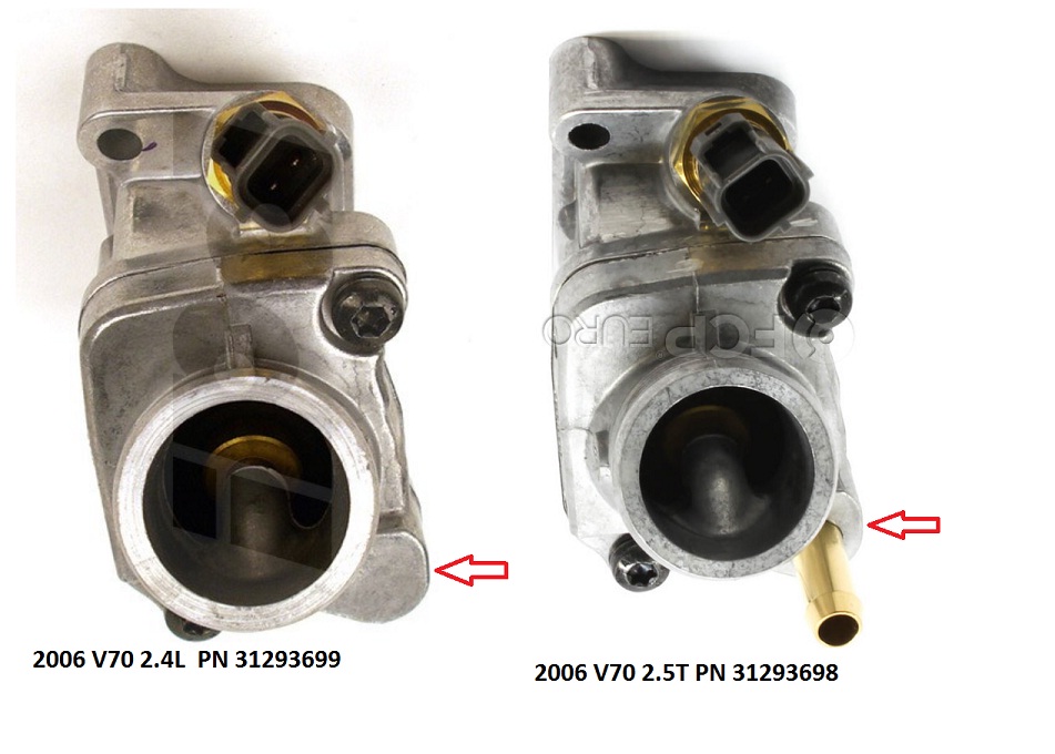

I do not have the 2.4L as the O.P.'s car is 2006 V70 2.4L...
My understanding is that different tsats:
- With or without the nipple for the small cooling hose that runs alongside PCV system.
- The 2.4L tstat w/o the nipple ---> the notch "might" stick out a bit more than the tstat with
nipple as shown in the photo. I don't know for sure bc I only take these photos from the web...
If I ever do this again, I'd do both the PCV system and the Thermostat at the same time,
simply bc thermostat lifespan is about 110K-120K etc. Once the thermostat housing is off
(I posted the tricks in the tstat thread using appropriate T30 key with 10-mm wrench;
also disconnect both large and small cooling hoses from the tstat first), the I.M. right lower bolt
is a piece of cake, no need to fool around with this socket, that socket, Snapon swivel socket,
crowfoot etc.
