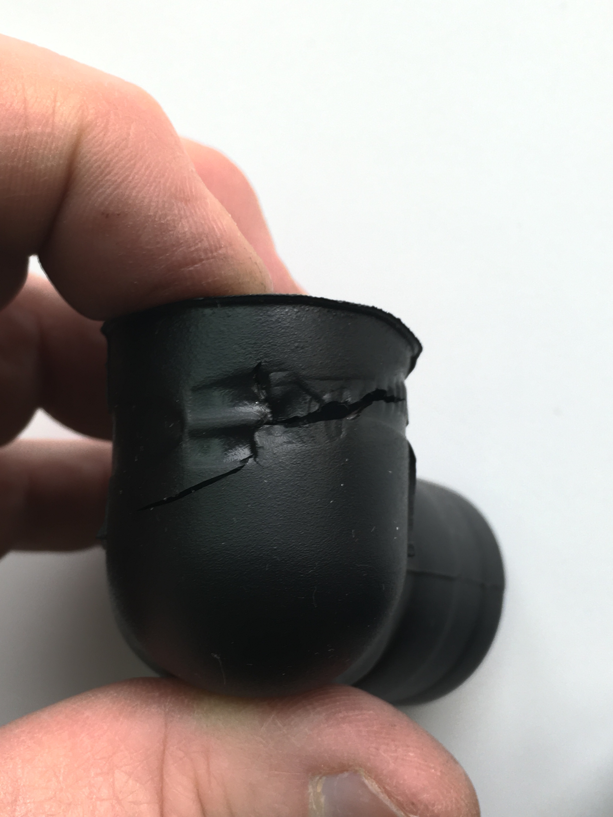

Edit: on your J-hose, it almost looks like the "clasp" part of the worm drive cut the hose. Also looks like the clamp is "forward" (towards the front of the car) more than it should be on the hose, but I think there's only one area that that clamp can even go. I see that FCP has changed the contents of their PCV kit, did you get it from them? Their kit used to contain a Gen Volvo j-hose that melted retinas at $75. Now I see it has been replaced for a $25 PPS part.

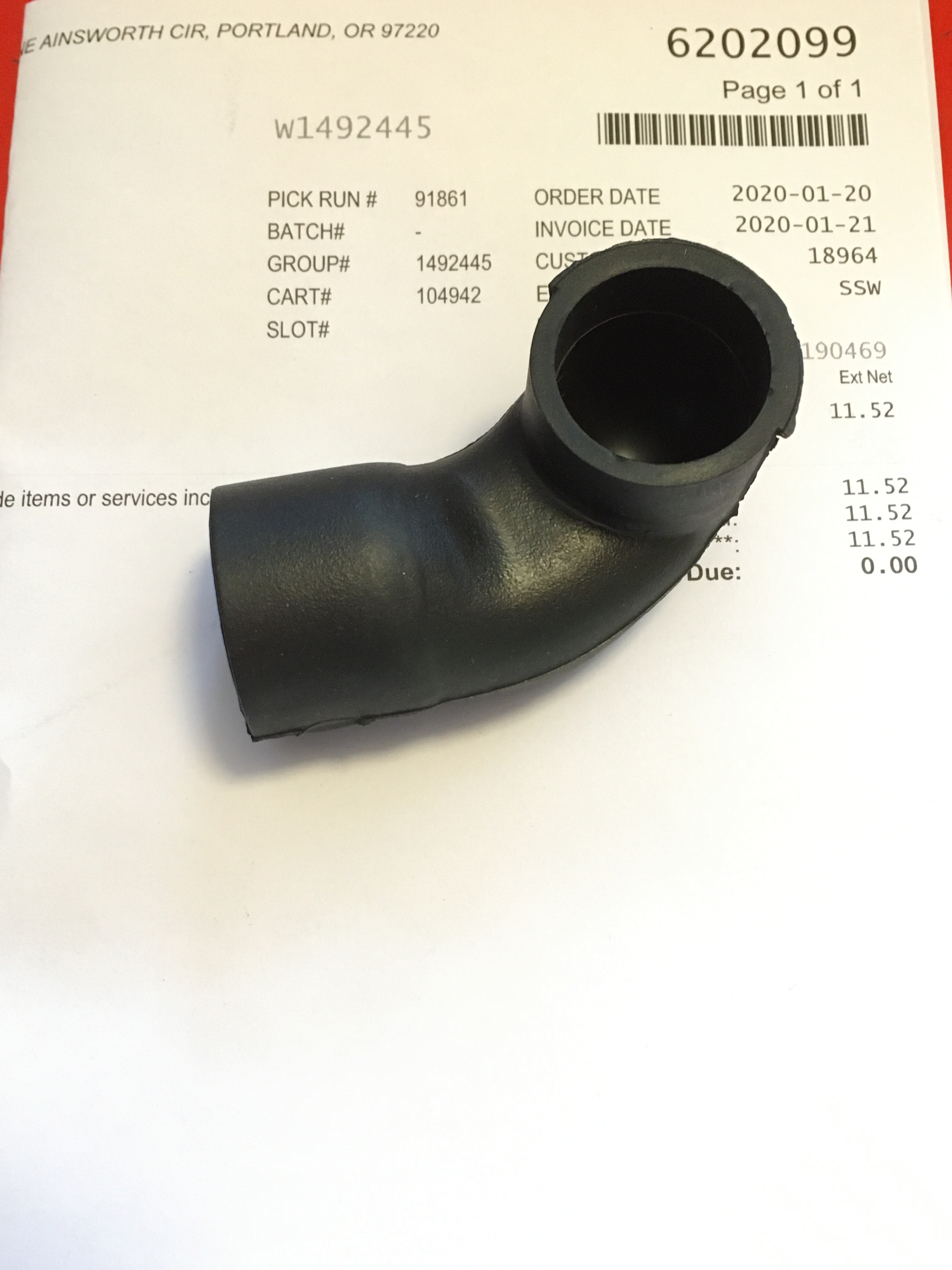

There's not much to that hose, smaller then I thought. I'm going to take a chance on XC70Rider's experience, move some hoses out of the way, and see if I can reach it from the drivers side without taking off the intake. It's a Volvo hose, as is the one that split.

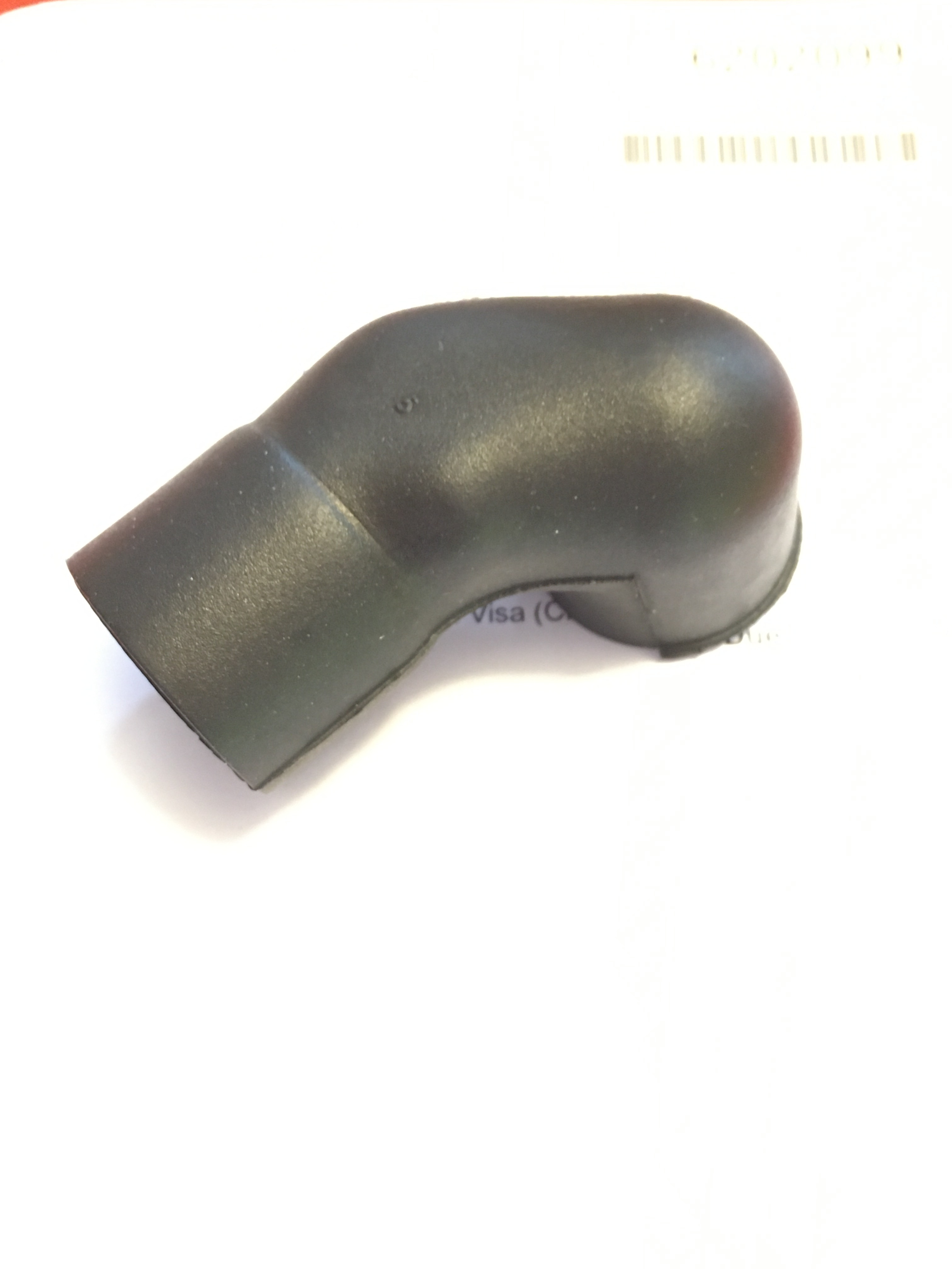

Bart, I would definitely verify that that is the correct hose. There are two hoses made, but very differently sized on the one end. Of the PCV’s I’ve done, both 2004’s required the larger hose. The one in your pic looks like the smaller one that wouldn’t fit.
This is the one I’ve used on the 2 04’s. You can check with your VIN. Granted, I used Gen Volvo for one, and URÖ on the other.
https://www.fcpeuro.com/products/volvo- ... s-23437388
This is the smaller one.
https://www.fcpeuro.com/products/volvo- ... in-1271653

That PCV hose is a Volvo brand Flame Trap Vent Hose #1271653 for an '04 XC70. Ipd # 112257.

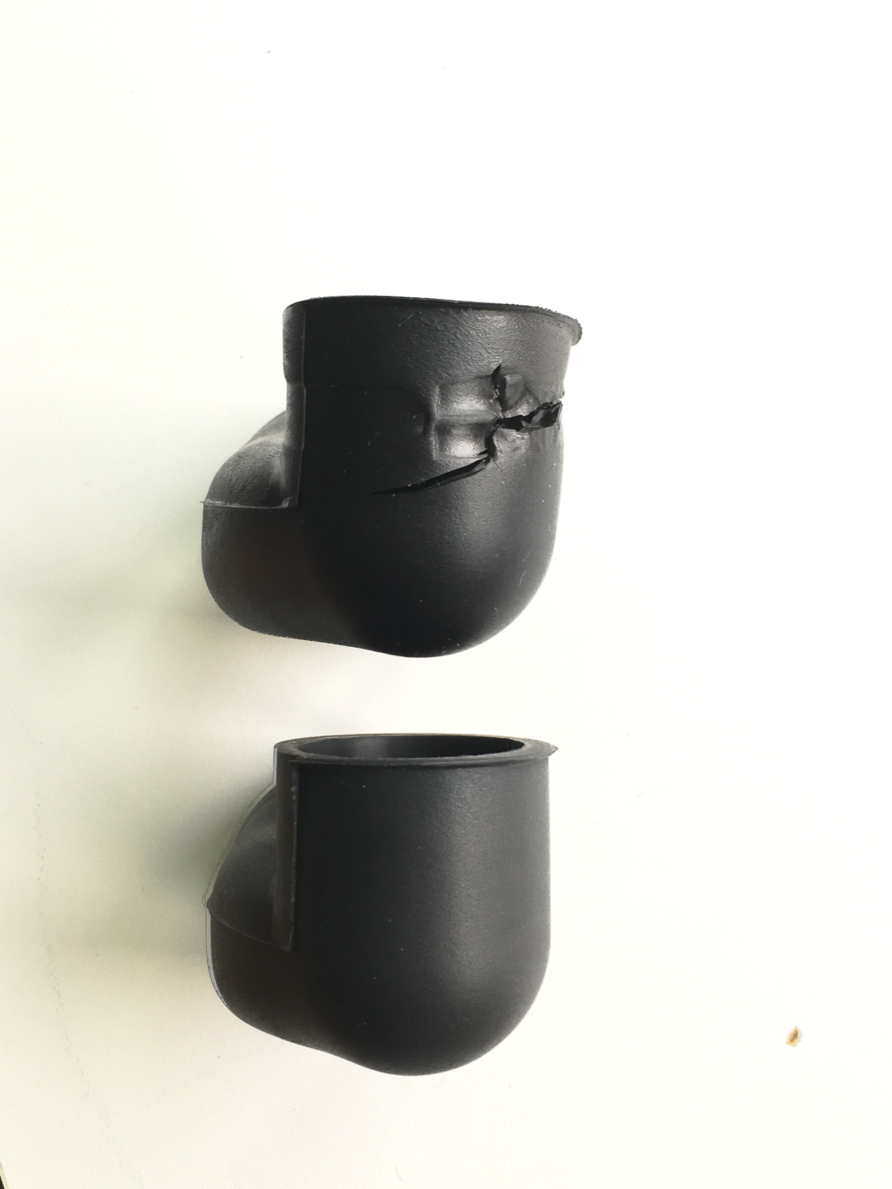

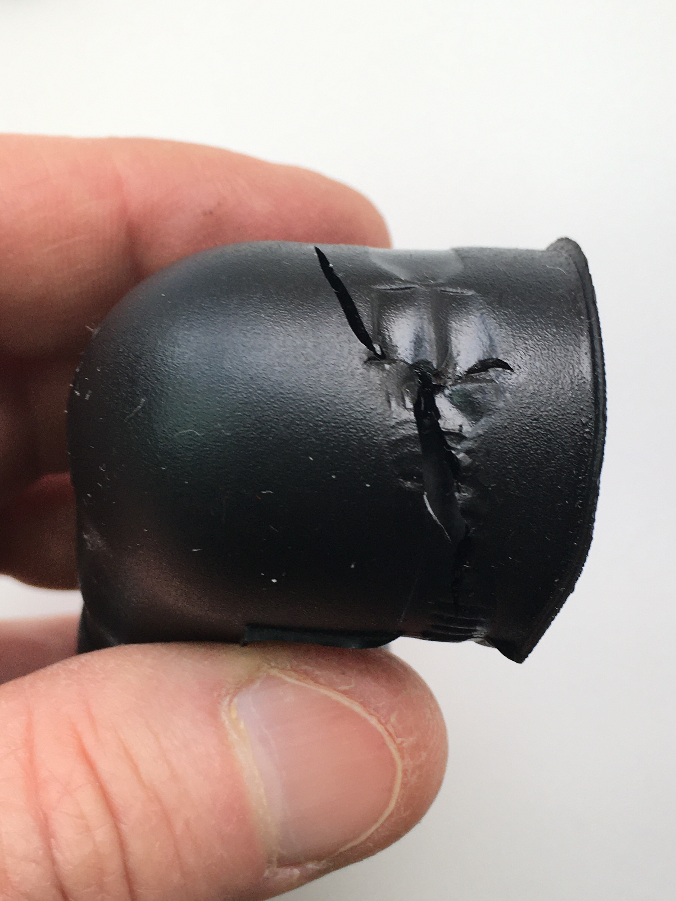

Look at this - I think maybe the clamp hooked the rubber and tore it. Maybe I make things too tight? I dunno. I disconnected some vacuum hoses and the intake pipe so I could get my arms under there. Tiny flashlight. 1/4" drive flex nut driver got one clamp off, LONG screwdriver to slip it off, and a 1/4" ratchet and short socket to get the PCV box clamp loose.
Now to get it back on there! I got some skinnier clamps from our Fastenal store.

Man that’s an ugly cut. Whew, I was worried you were gonna need the bigger j-hose.

Yeah, too tight. The rubber failed under the screw clamp and then the crack propagates away.
The clamp just needs to firm up on the rubber, and the better quality closed type won’t bite the rubber like that
