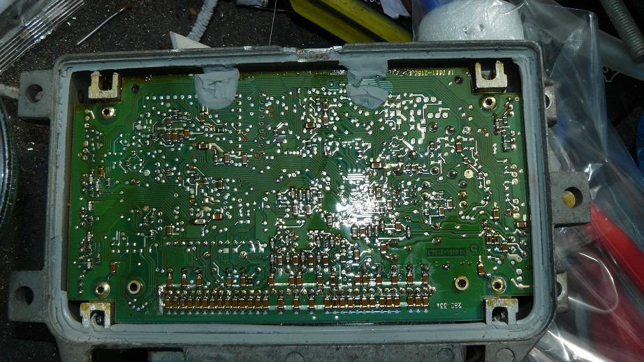

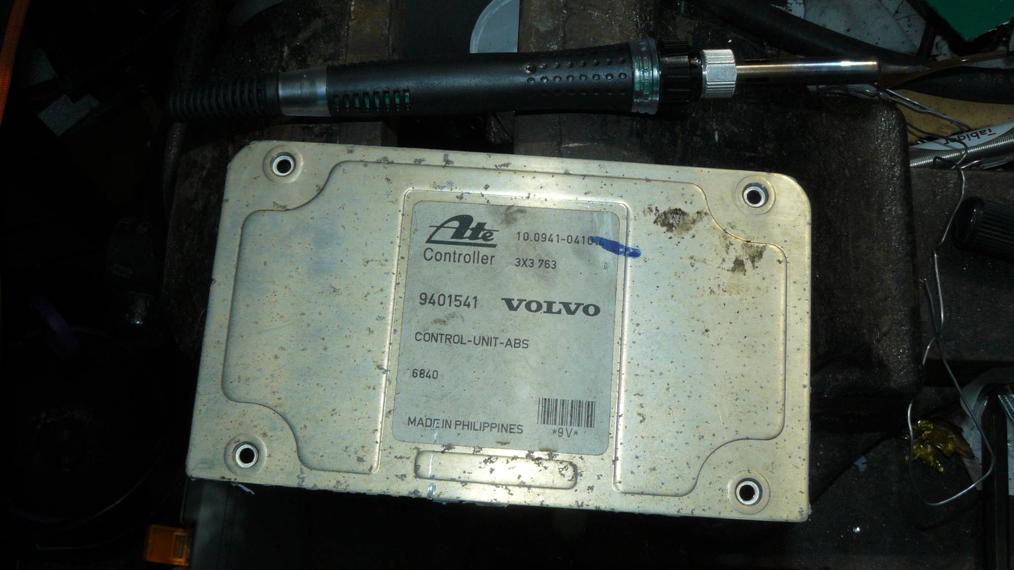

hi neil and all well today i removed the evil thing and gently and with near zero damage removed the cover,pictured is my abd module but having done a search here and elsewhere for images of where i need to solder and none look even similar maybe its because its an old evil thing i even did a google search for images theres plenty of the sealed box but none of any relevants for the inside bits.
i can say ive used a magnifying glass and put me specs on but see no obvious cracks or brown bits i see folk mention the main terminals where plug connects and have been along the row and remelted the existing solder after scraping the covering matter from relevant sections i still see nothing and plugged it back in and its just the same evil thing still cruelly abusing and taunting me! any guidance much welcomed,also i read during search someone mention the early 94 855 having a particular fault re the abs but not saying in the post what said fault might be? i am so shaky today and single handed shaky soldering could well make things worse :!: :mrgreen: meds time i think,wheres me pipe? :D
