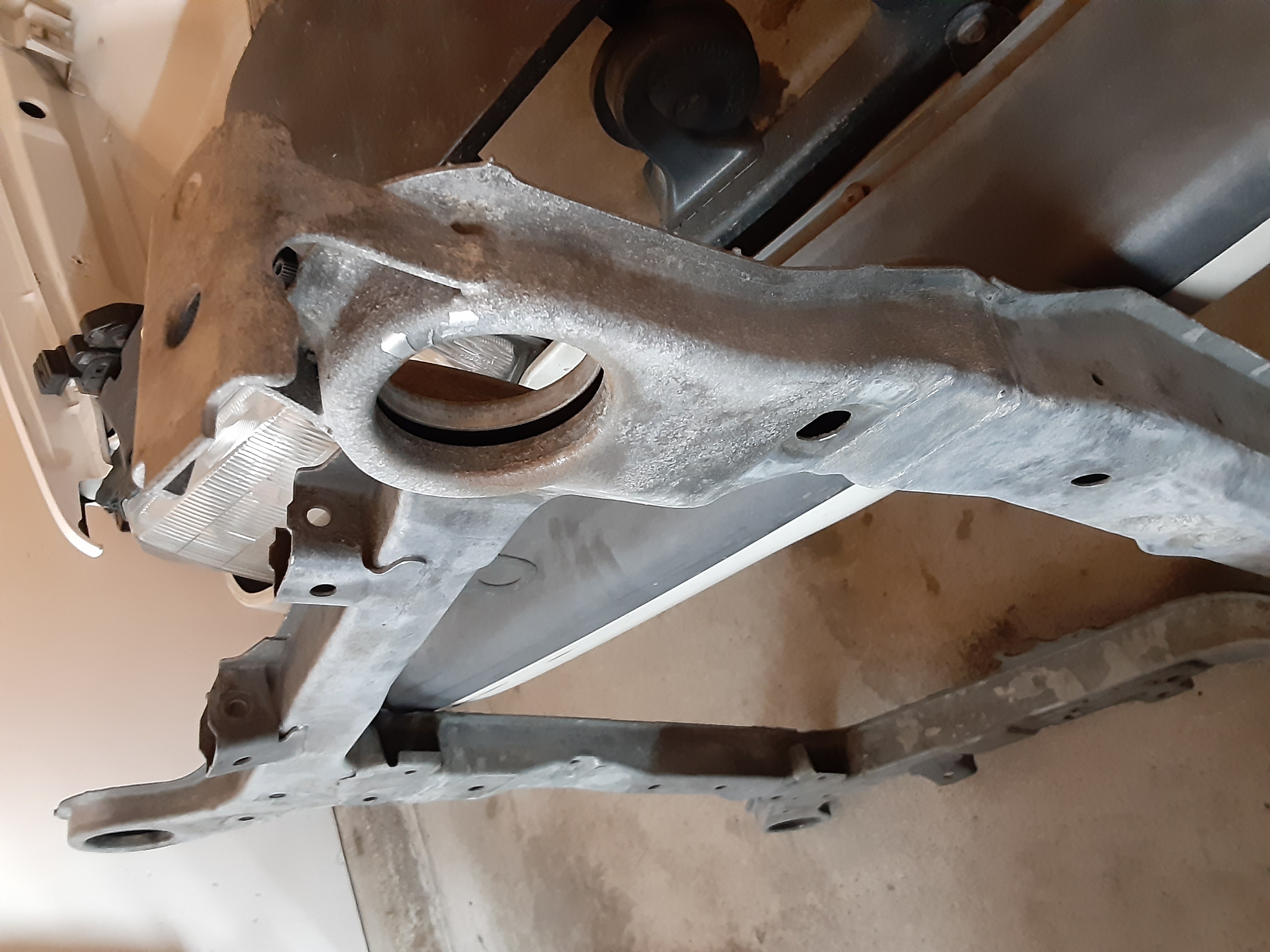

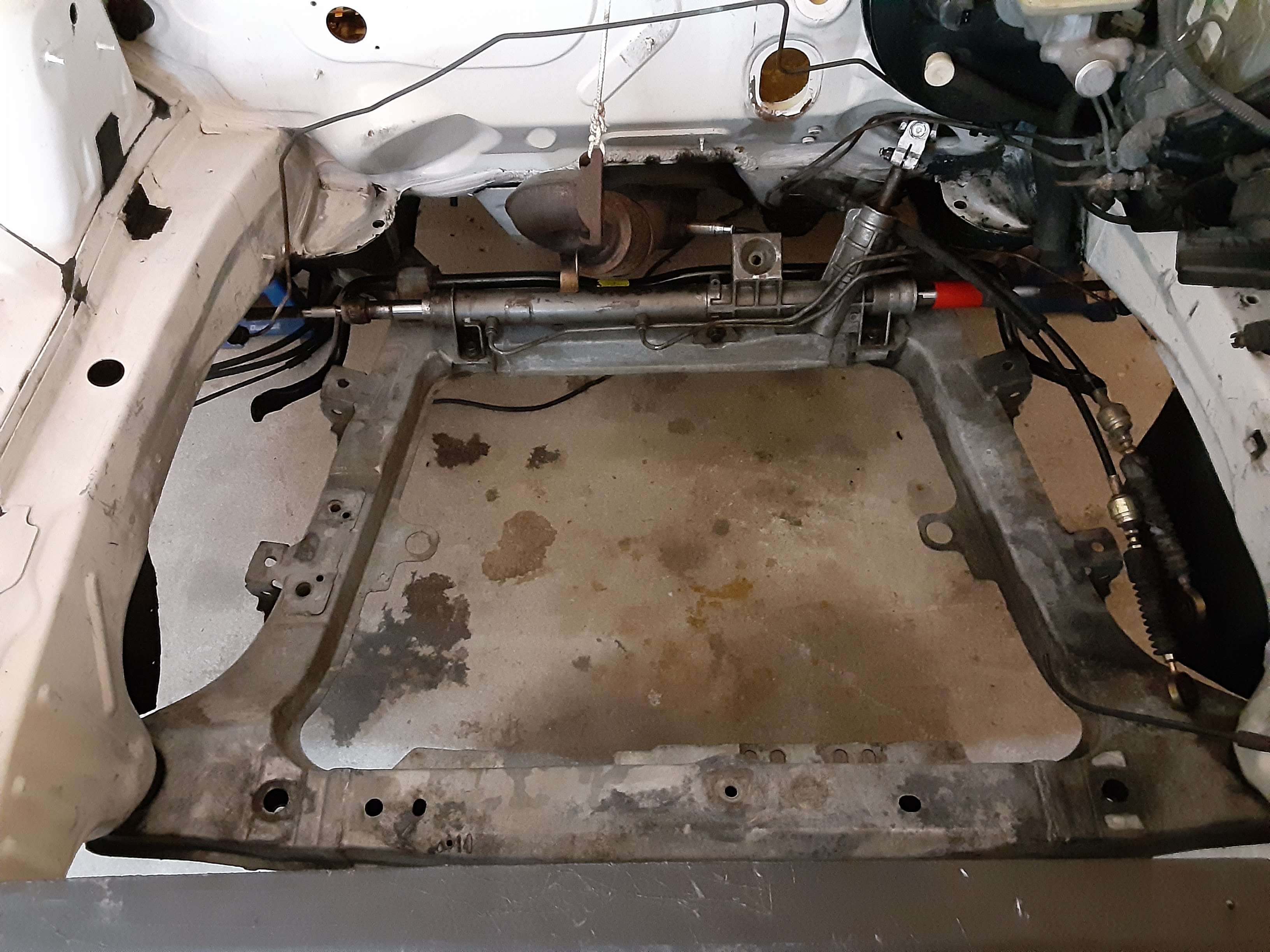

Life got in the way again. I finally got some things done.

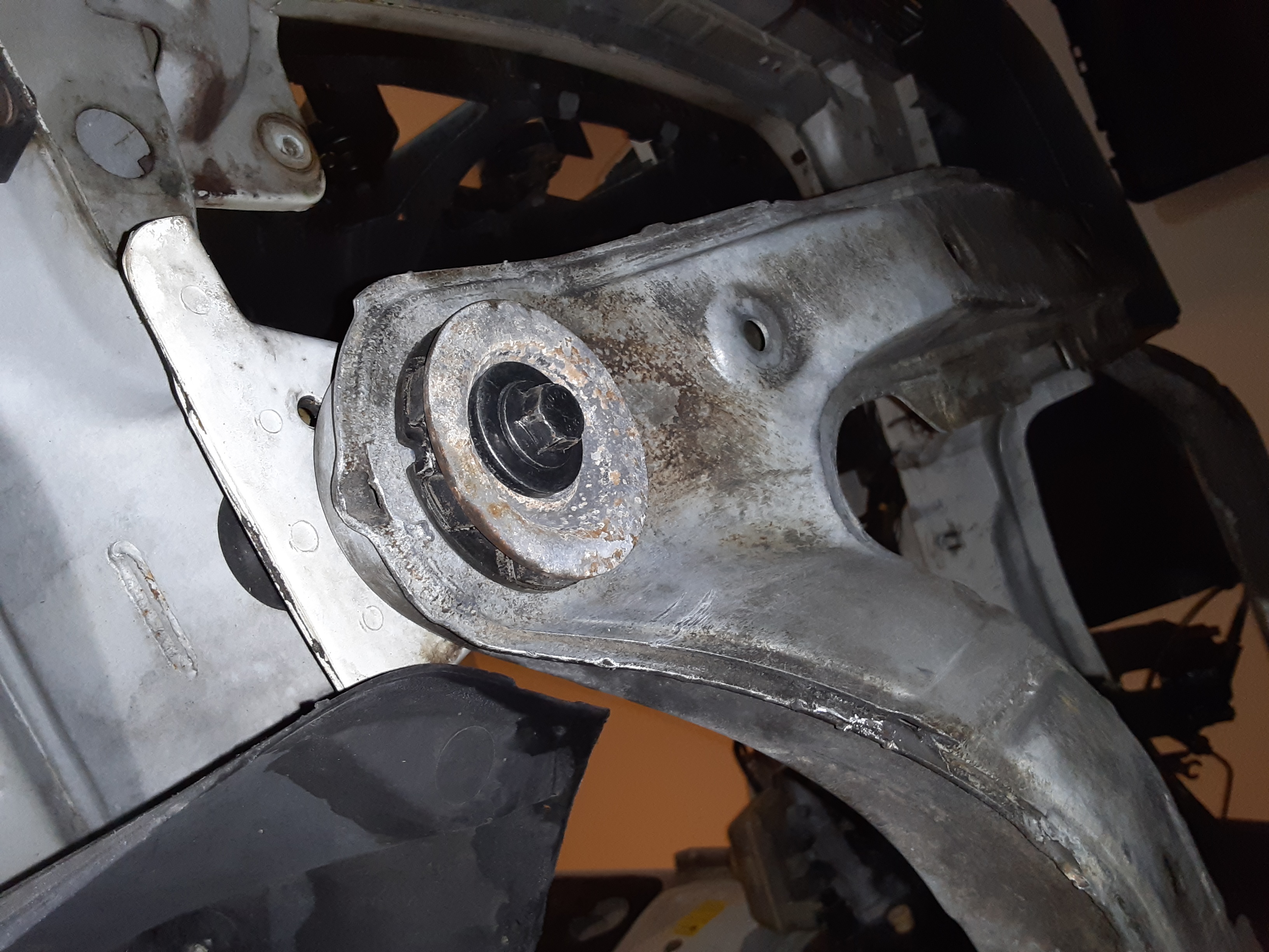

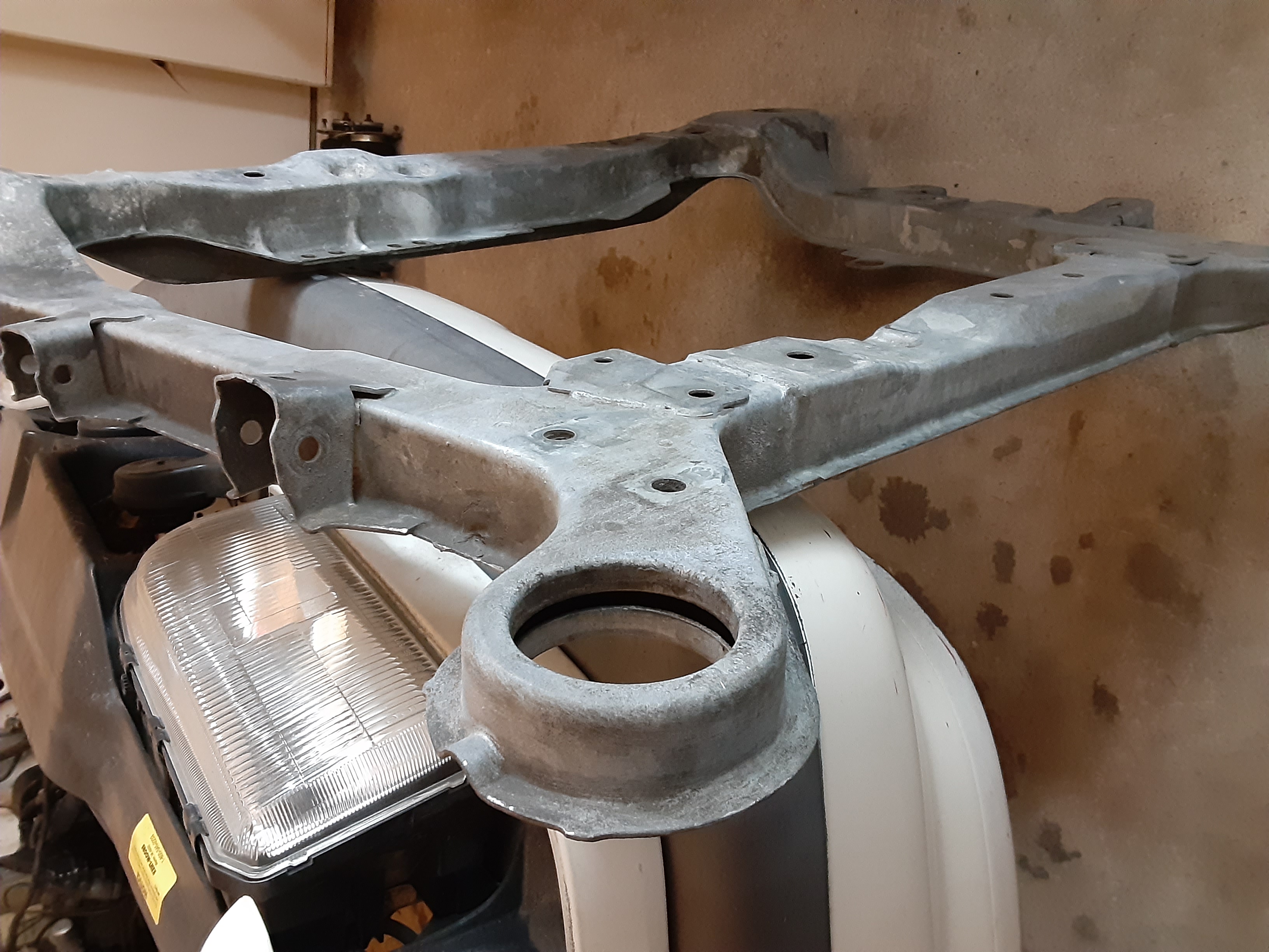

I cleaned up the front subframe:

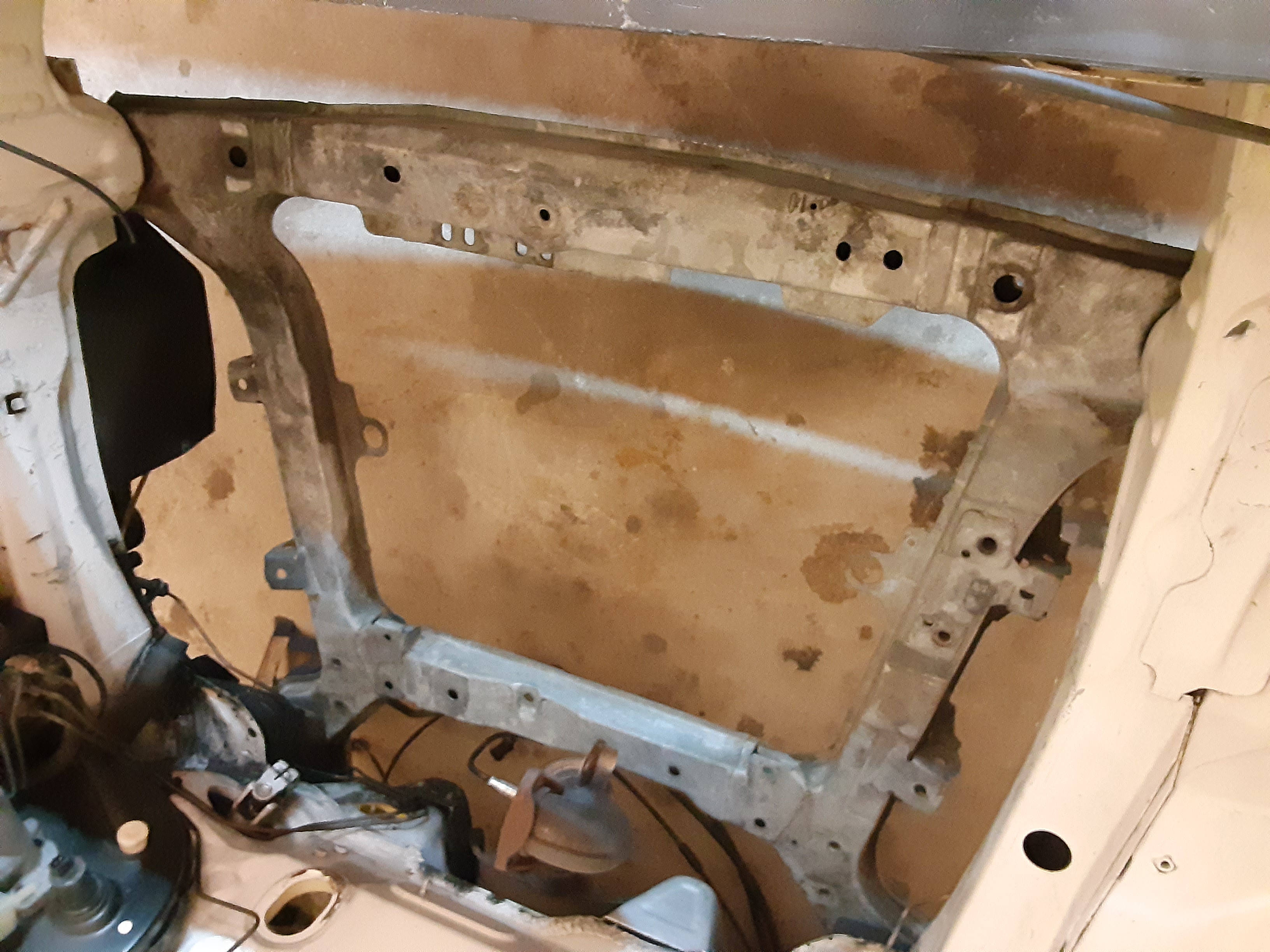

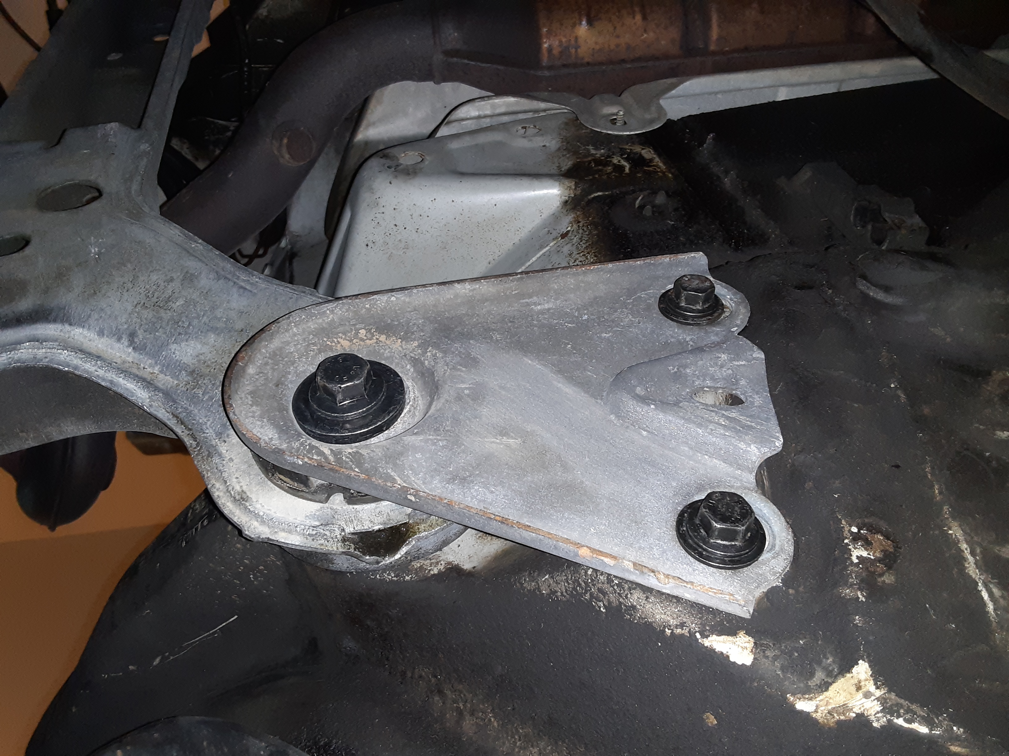

Then added new mounts and reintalled it in the car:

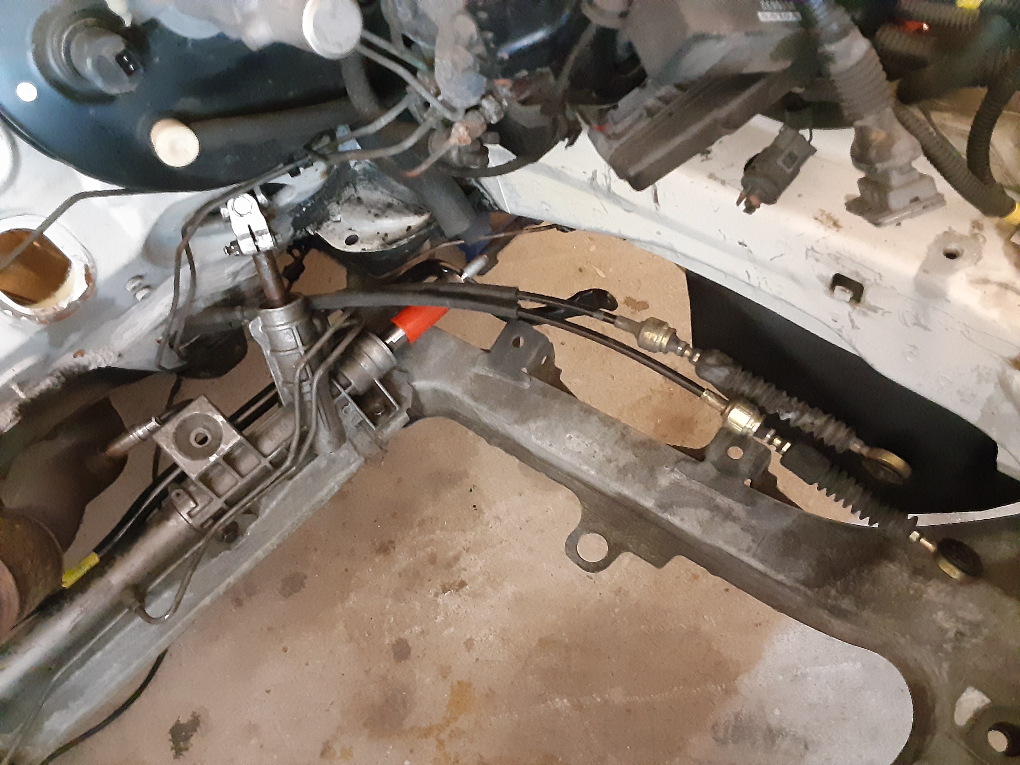

Then installed the sway bar, steering rack and shift cables:
The next step is to get the exhaust out. Nice of Volvo to WELD the entire thing together...

Volvo didn’t weld it together, that’s on a previous owner
Are you really doing to put that subframe in with that rust?

I was thinking the same. After going to all that work I would have had it painted at least before refitting. Ideally powdercoated before fitting the sub-frame mounts.
Good luck!
Good luck!

Believe me, I'd absolutely LOVE to vaporblast and powdercoat every single part on this car, chassis included. Unfortunately, something broke inside me last month and now, I JUST WANT MY CAR BACK. I'm sick of looking at it sitting forlornly in the garage, half-apart, surrounded by parts leaned up against walls, stacked on benches, laid in corners, stuffed under the car itself.scot850 wrote: 27 Mar 2022, 10:33 I was thinking the same. After going to all that work I would have had it painted at least before refitting. Ideally powdercoated before fitting the sub-frame mounts.
Good luck!
Also, I don't have a vaporblasting cabinet or a powdercoating setup, nor do I have the cash for them right now. But not to worry - all the TTY bolts I've replaced are new and installed properly. Everything's sealed and gasketed up nice and tight. It'll be fine.
If it turns out to be a Swedish rat rod, so be it. At least that keeps the car tax on the ground.
