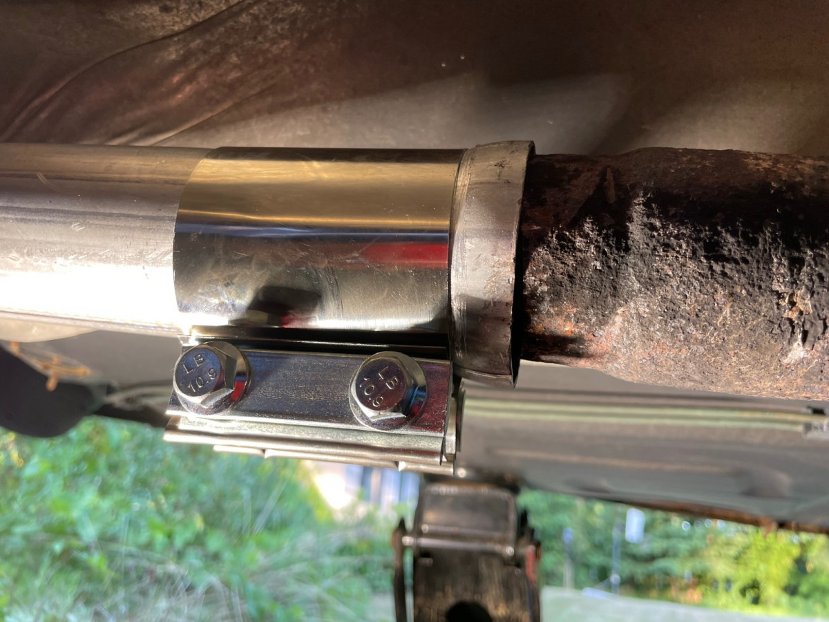

Went into the WwF ring with an XC muffler. Couldn’t get the joint above the axle apart, so had to successively cut pieces off , starting with grinder, finishing with Sawzall. Not too bad labor wise but a lot of obnoxious metal chips.
Mounted up the twin mufflers, got hangers on, then puttied and installed rear pipe.

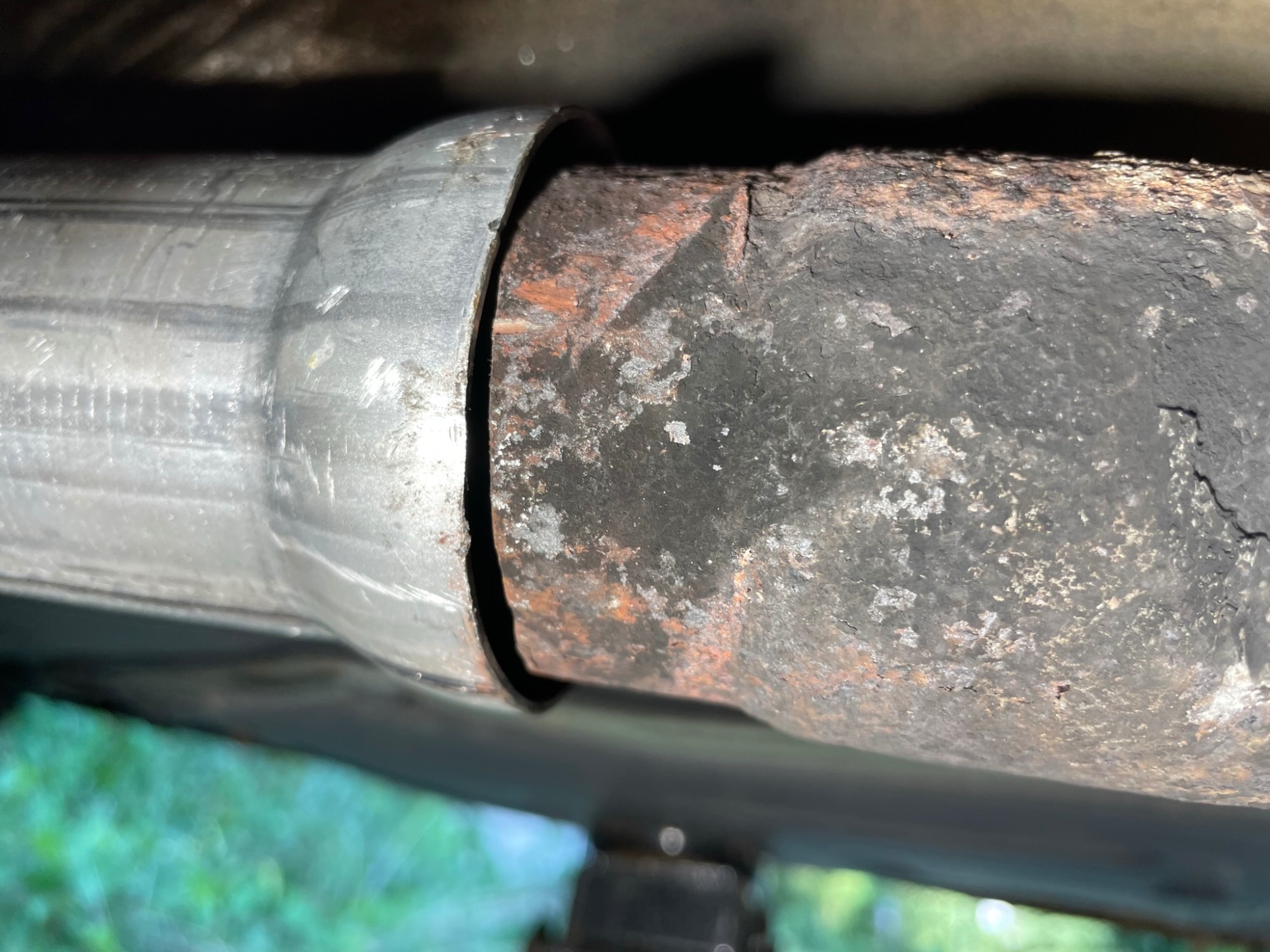

Connected to cat with 21/2 inch band clamp with putty. I like this over the stock Volvo snout connection which is hard to get tight on an old exhaust
Checked fit, then tightened both band clamp and over axle clamp. I might need a bit of tube buffer on the rear right hanger, close to frame.

I had great results using a replacement flange kit for the cat-to-muffler connection. I had tried solutions like yours on Jane for many years and they always quickly failed. This flange kit seems totally solid and worth the $100 parts and labor.

That’s a great piece of kit. I’ll certainly look at that when this puppy fails. It is in 304 steeltoo, so hopefully I’ll get a few years.FireFox31 wrote: 19 Jul 2022, 20:27 I had great results using a replacement flange kit for the cat-to-muffler connection. I had tried solutions like yours on Jane for many years and they always quickly failed. This flange kit seems totally solid and worth the $100 parts and labor.
AnLPT exhaust is 60 mm stock OD so I’ll need a 2 3/8 version in worldwide units of inches instead of the esoterica meters
