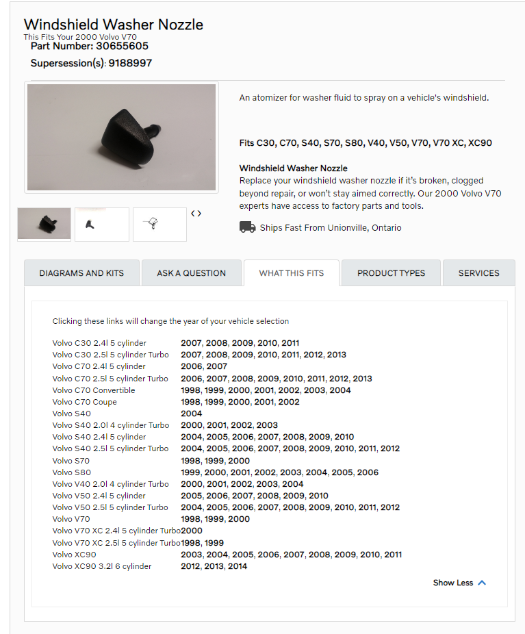

Would recommend anyone who has the old style spray nozzles (2 hoses) to pick up some washer nozzles from any of these cars. My 98 had the old style and the upgrade is amazing for vision. Much more efficient spray of water.

Those fan-type nozzles are a must!

I swapped to the fan type nozzle, but the Pro Parts version..... I would not recommend. I seem to go though washer fluid very fast. The spray is not high enough on the windshield. One of these days, I'll try something else.... maybe get some from a salvage yard, if I ever go and find a suitable car to pull from.

You can save $18 with the PPS, or spend $24 for the ones that work.
