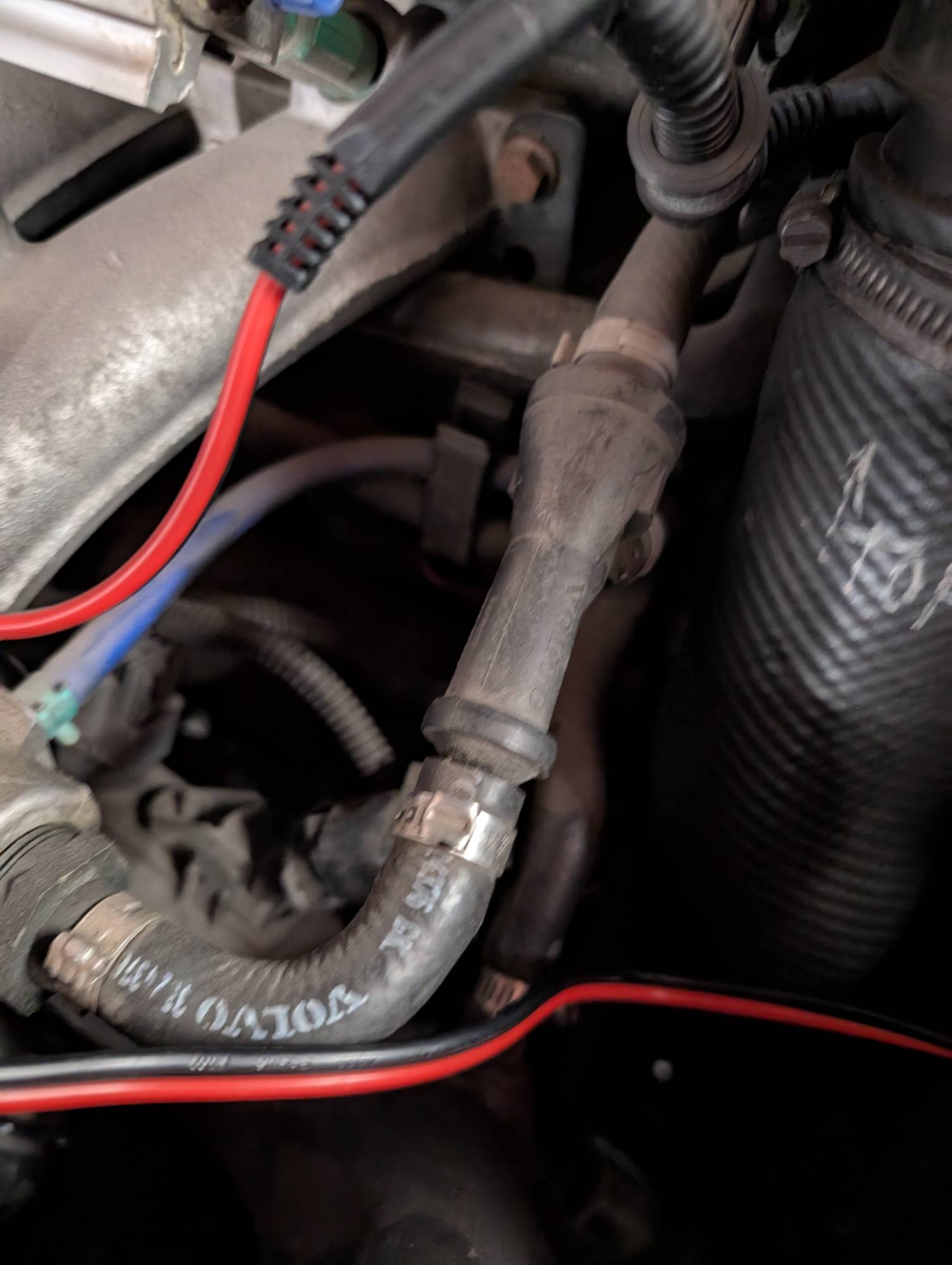

Well I'm hoping that I will be able to figure this out based on finding vacant hoses/ports.

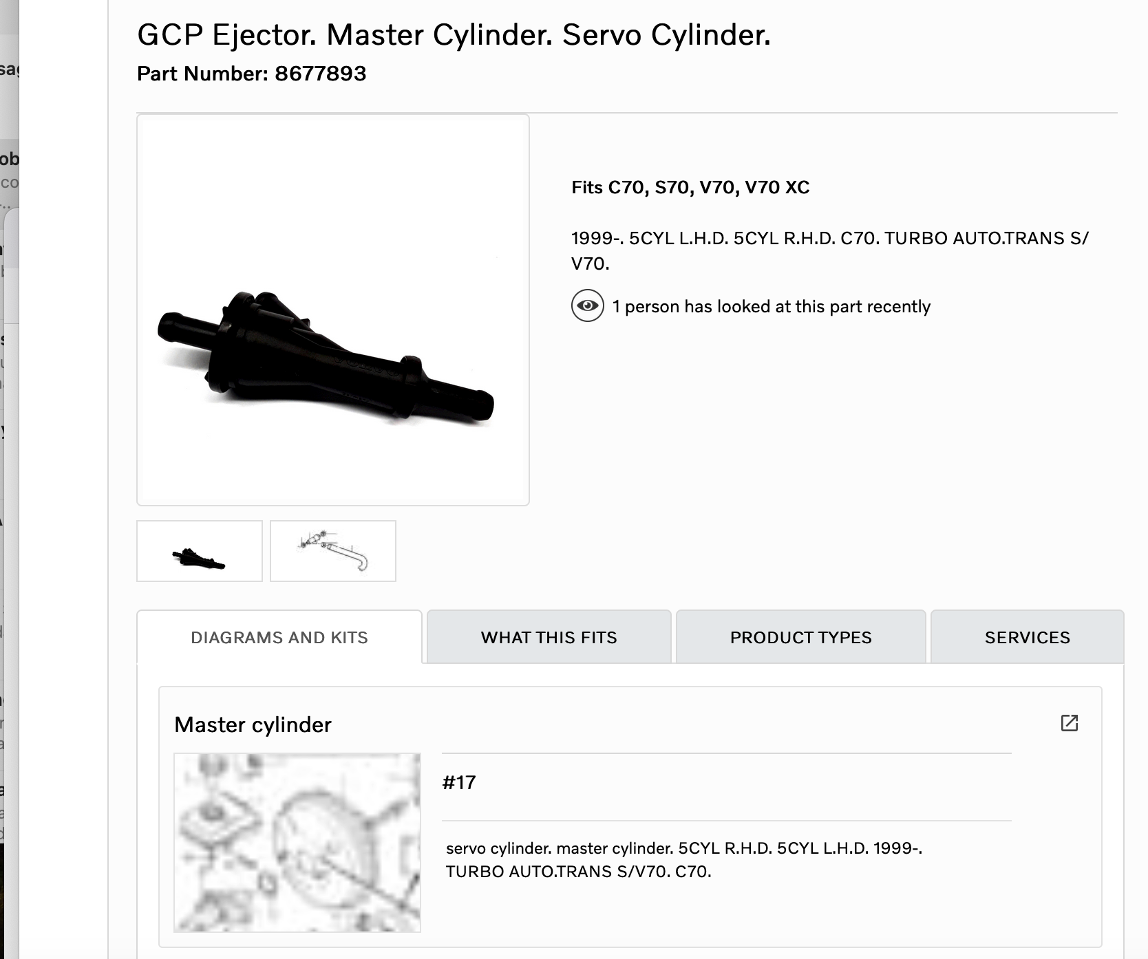

I can't find that diagram on Volvowebparts even when I enter GR72362 which seems to be the page header. It would help to see what each part numbered actually is.

Heres the part....

Figures. I pull up that part and diagram, and I want to know what parts 24 and 26 are, but they only tell you what parts 23, 25, and 28 are.
I have figured out where all of the hoses go, except for one open port on this part. Since I still don't have the top of the air filter box, maybe it connects to that. I'll get it sorted out.

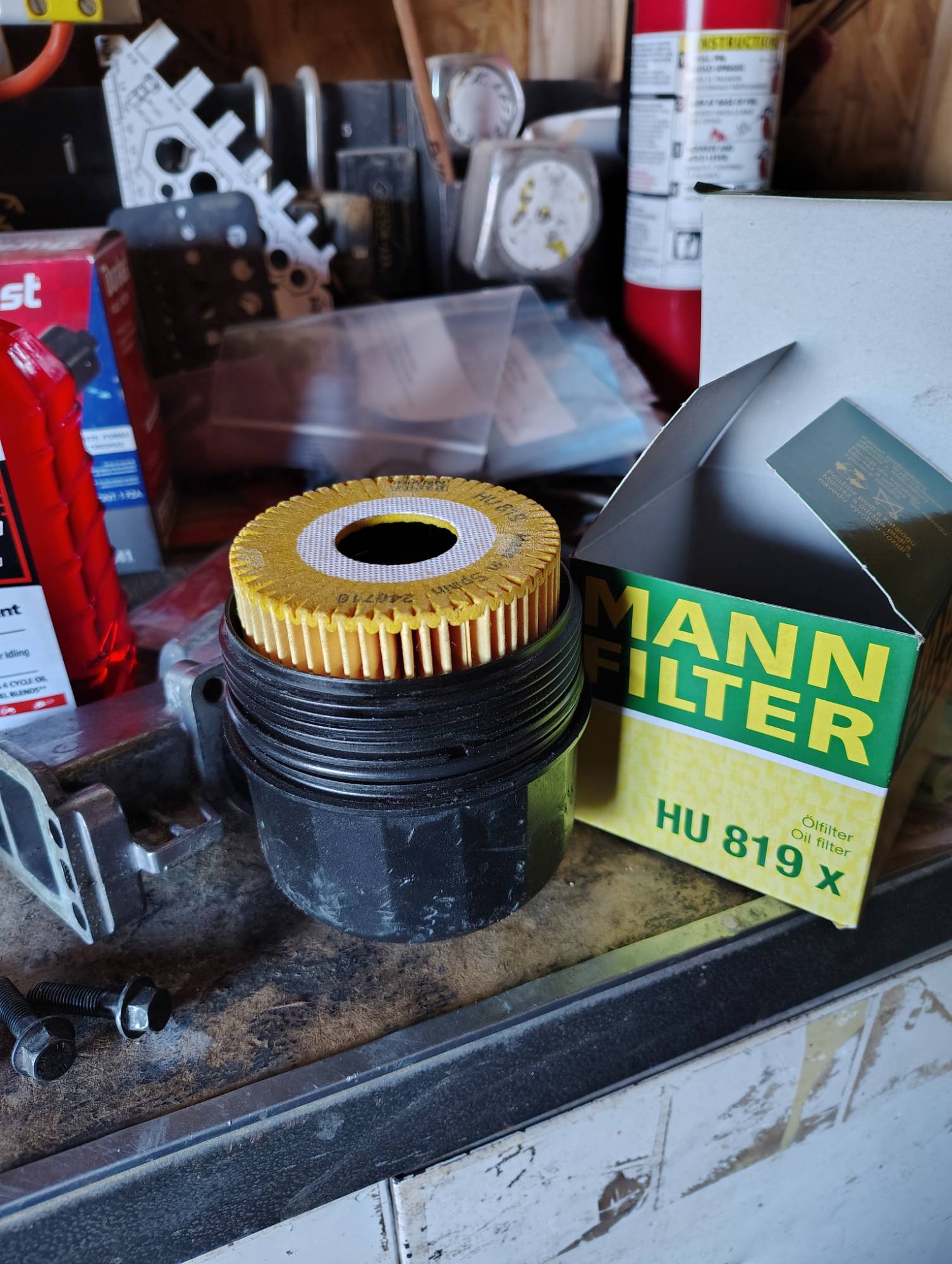

Decided to finish the day on something really really simple. How about putting in the oil filter, so I don't make the mistake of starting to add oil and wondering why it's taken 5qts, but nothing on the dipstick. This is my first cartridge type on a Volvo, and when I went to fit it, it seemed to bottom out by hand way before the o-ring would seal. Without the element the housing threaded on just fine.
Does this look right ?
1999 V70 GLT
1999 V70 GLT
- Posts: 36158
- Has thanked: 1611 times
- Been thanked: 4074 times
You have to set that cartridge way up and into the engine so that the threaded cap bottoms out the threads or you will have a gusherSveedy wrote: 22 Apr 2025, 17:17 Decided to finish the day on something really really simple. How about putting in the oil filter, so I don't make the mistake of starting to add oil and wondering why it's taken 5qts, but nothing on the dipstick. This is my first cartridge type on a Volvo, and when I went to fit it, it seemed to bottom out by hand way before the o-ring would seal. Without the element the housing threaded on just fine.
It can take a nice firm push to get the cartridge up there

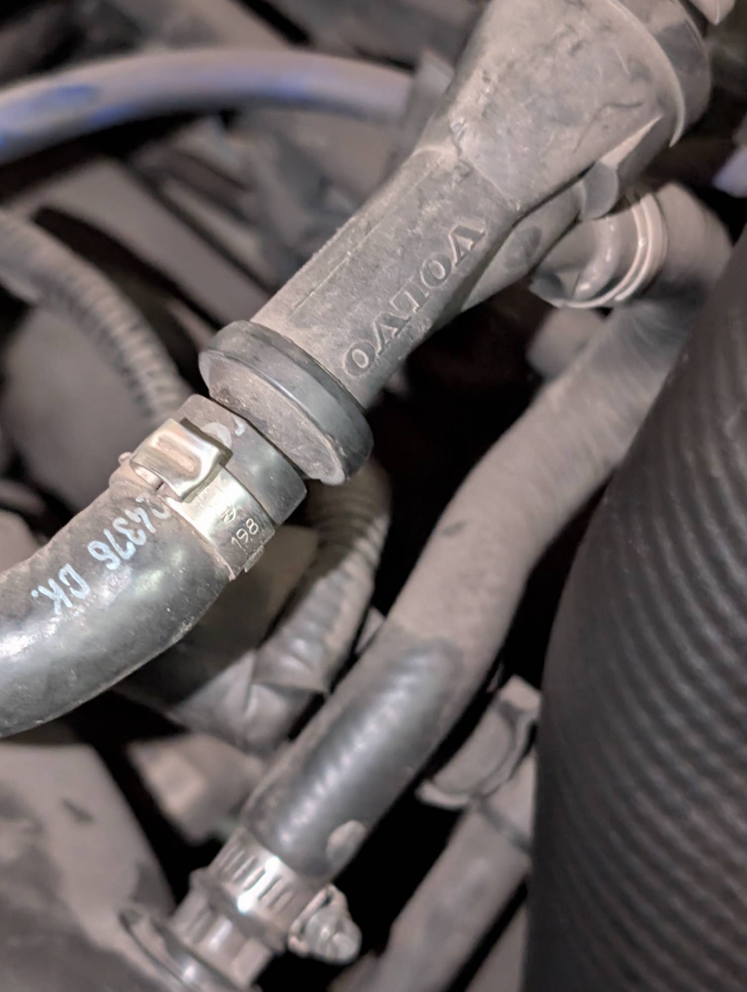

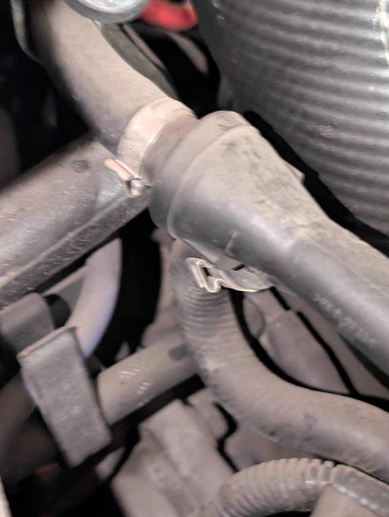

The HPT also has that part. Here are a couple of pictures from my 00 V70R:
From your original picture the short pipe should fit to the transmission end of the intake manifold and the ejector orientated this way with the wider end towards the rear of the car.
The curved pipe from the side of the ejector should face downwards and loop towards the front of the car and attach to the intake tube to the throttle body.
The rear facing outlet pipe runs to the rear of the car. I did not have tome to trace it but it should run to the brake booster.
Hope this helps.
Hope this helps.
- Sveedy
- Posts: 2140
- Joined: 11 Nov 2019, 16:52
- Location: N. Arizona
- Has thanked: 445 times
- Been thanked: 479 times
Perfect ! That's just what I needed.
