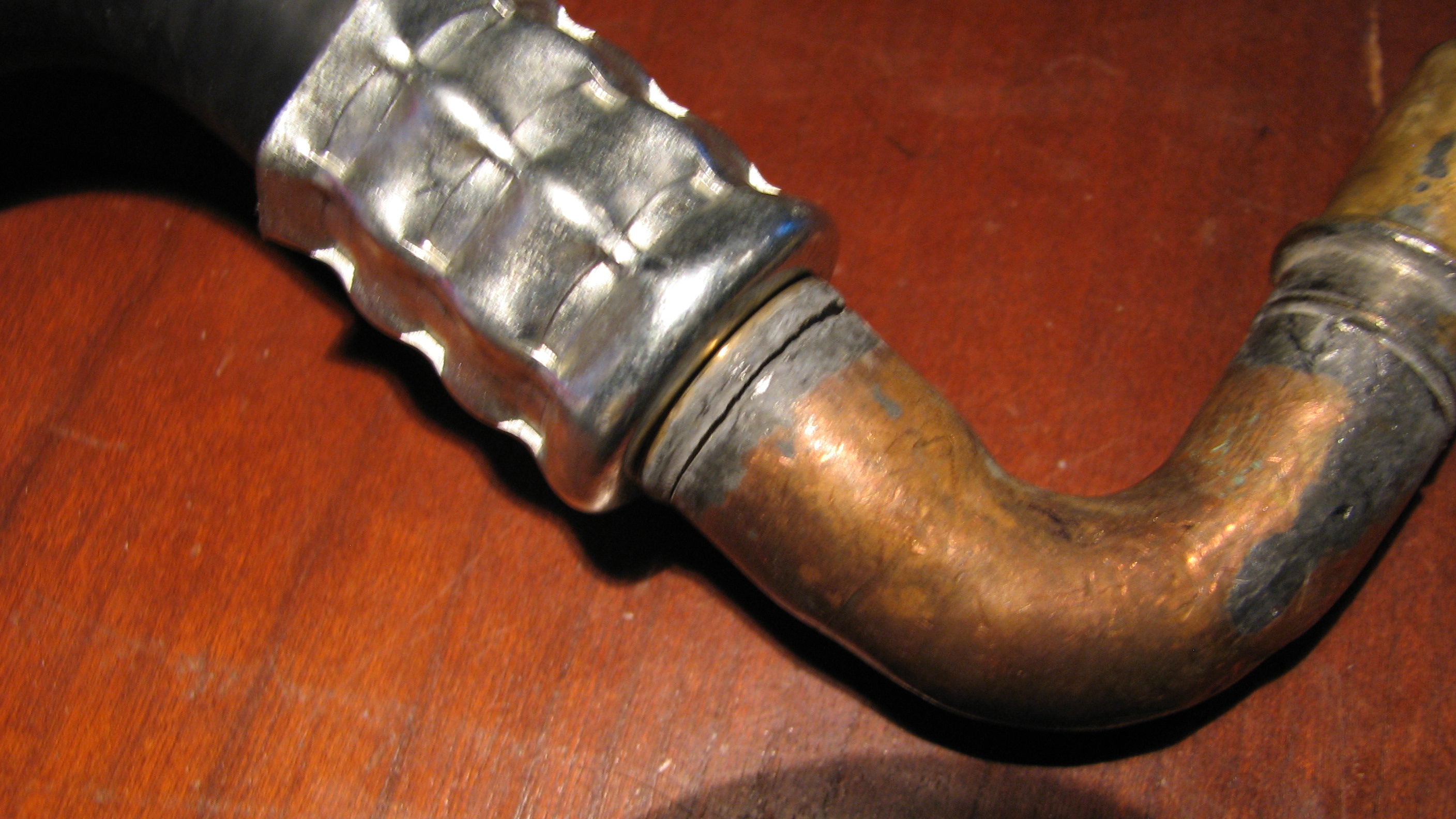

To clarify the "URO" hoses, they are a remanufacture, using some original copper tubes, and a pot metal clamping as opposed to the original pressure fitting.
It is an aftermarket brand known to utilize less than good polymers.
The original is a nice coupling from hose to copper. The weak link is still the bulkhead transfer.
It was over complicated, but for the sake of assembly line.

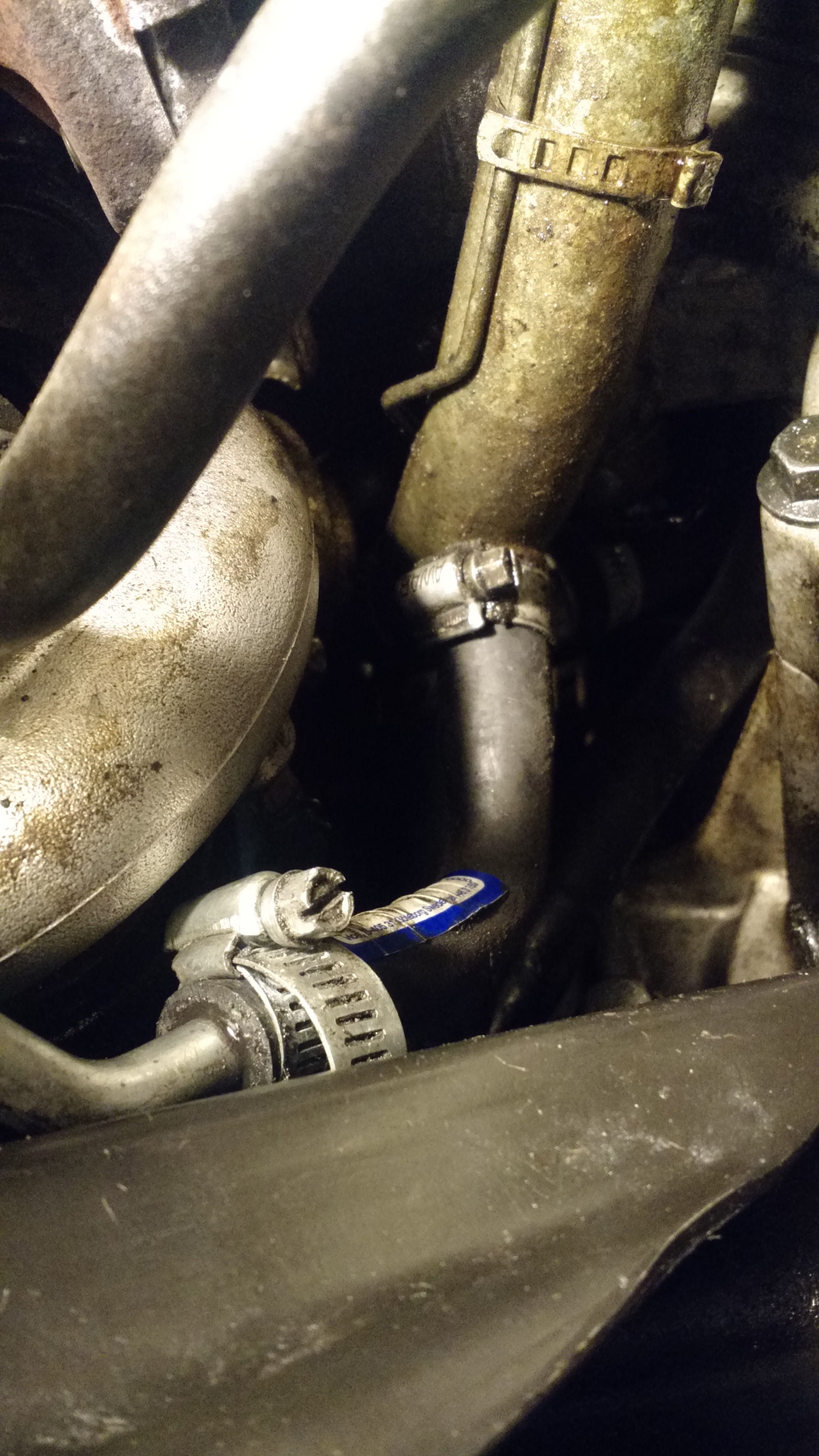

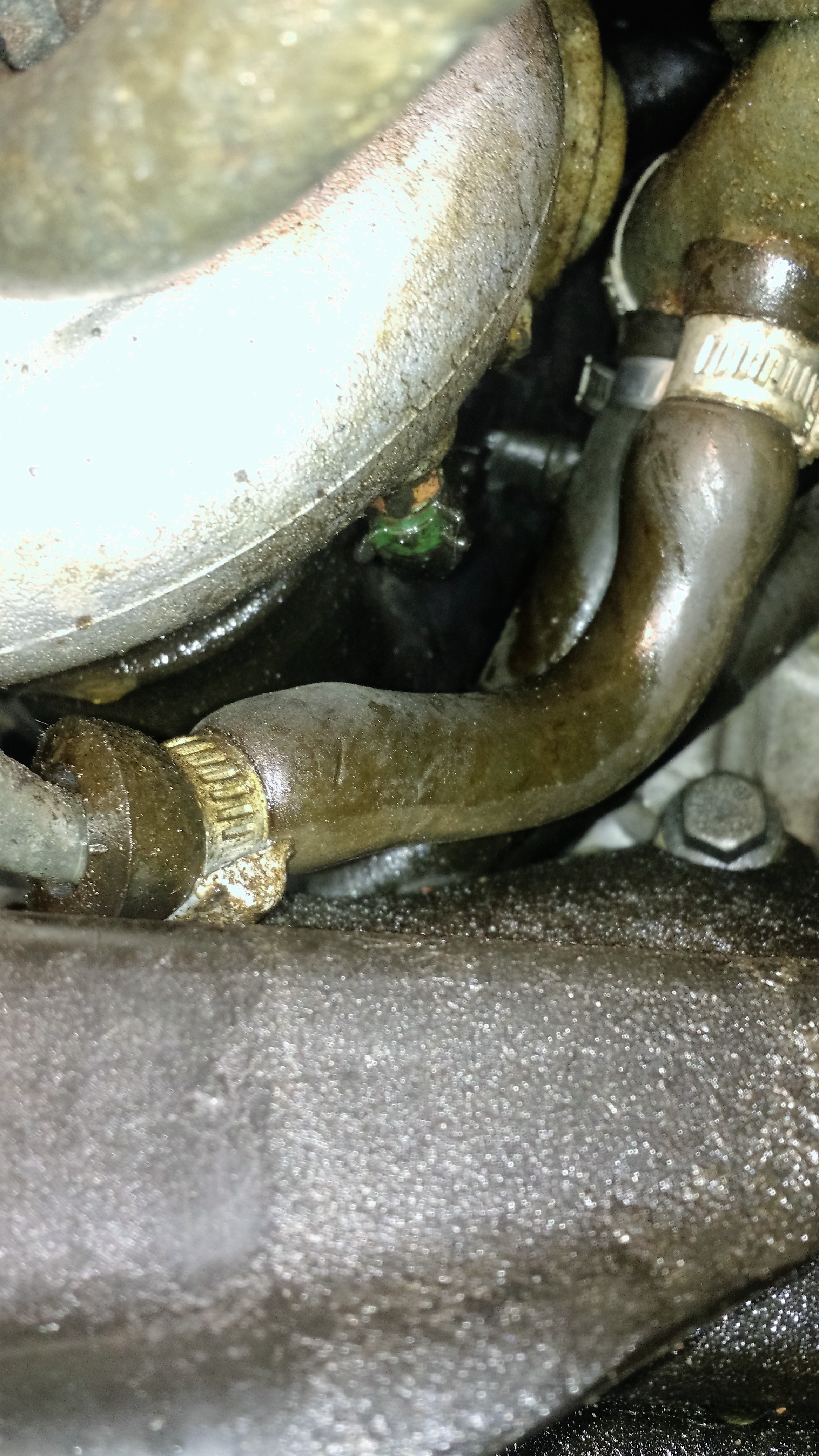

I too, had this problem of the coolant inlet hose to turbo ( PN#6842190) leaking profusely from being worn and bulging at both ends. I spent an entire week, ususally after I got off work to get this done. It was 30 degrees or less, in the garage with no heat, slaving away in ridiculously close quarters trying to detach and reattach a hose that cost 10 bucks to replace but a good portion of one's sanity and patience. Yes, I hated my car just a little bit more after this...
- Posts: 36149
That one is a bitch. Common sense says the shorter a hose is the easier the job should be, and that logic fails. I think I spent an hour on that one.

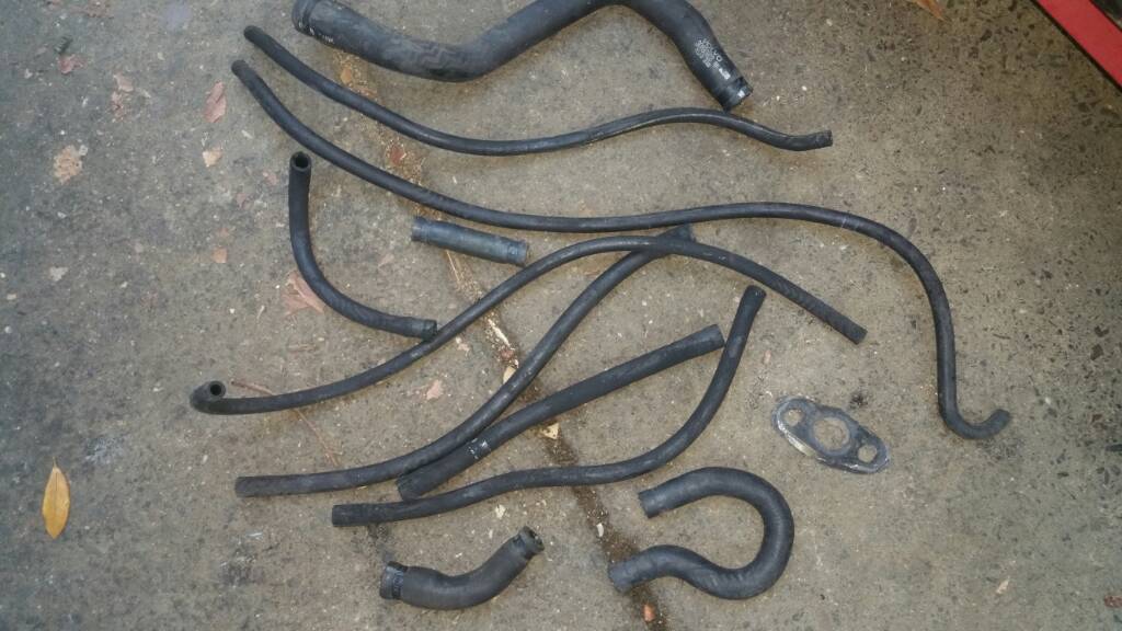

I just had a 2.4T motor converted into a T5 car. The 2.4T doesn't have this hose as the layout has been redesigned for the P2.
However upon bringing all the T5 coolant layout over this hose (and all other hoses) were replaced. You can see this hose in the bottom lower left. The one in the bottom lower right which is a PCV coolant return hose would be equally painful while engine is fitted to the car.
Swapping the turbo and fabricating/replacing all these hoses took me an entire day with engine out !!
- Posts: 36149
Interesting Mike. On my 1999 T5 the PCV return is a short hose to the thermostat ( another bitch) to a hard banjo connection on the back of the cylinder head. I don't have that U hose.
