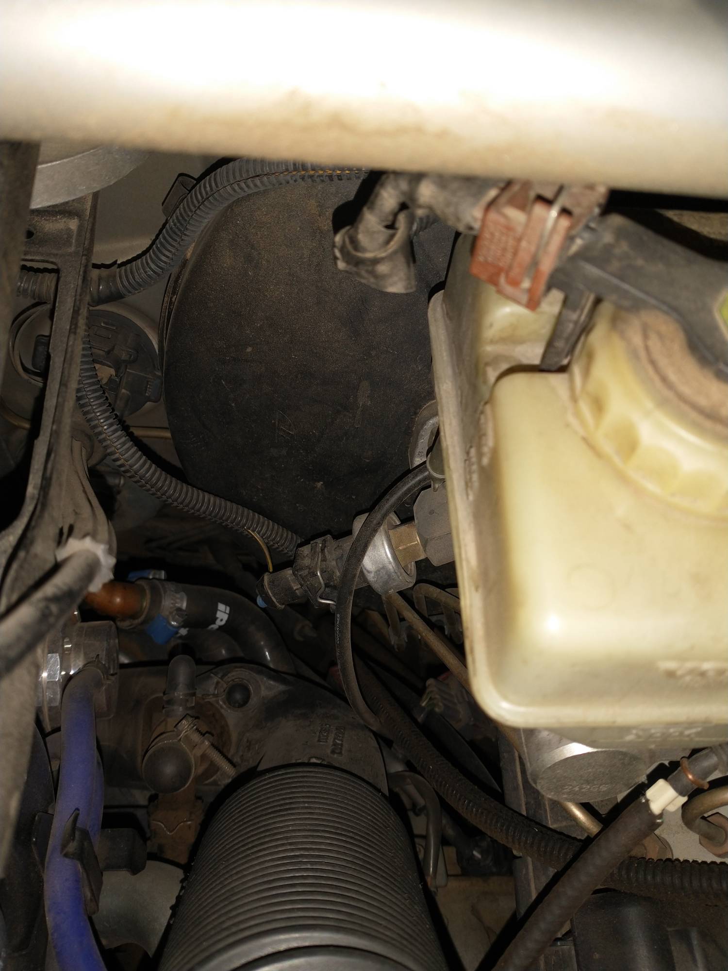

When I bought Sveedy, I had an intermittent ABS light issue. Looking through some old receipts, I found a reference to the ABS light.
The indy shop wrote that a sensor switch was bad, and NLA. I started poking around and found a plug installed where this switch was supposed to be on the master cylinder. Replaced it with one from a junk yard, and never had a ABS light issue again.
