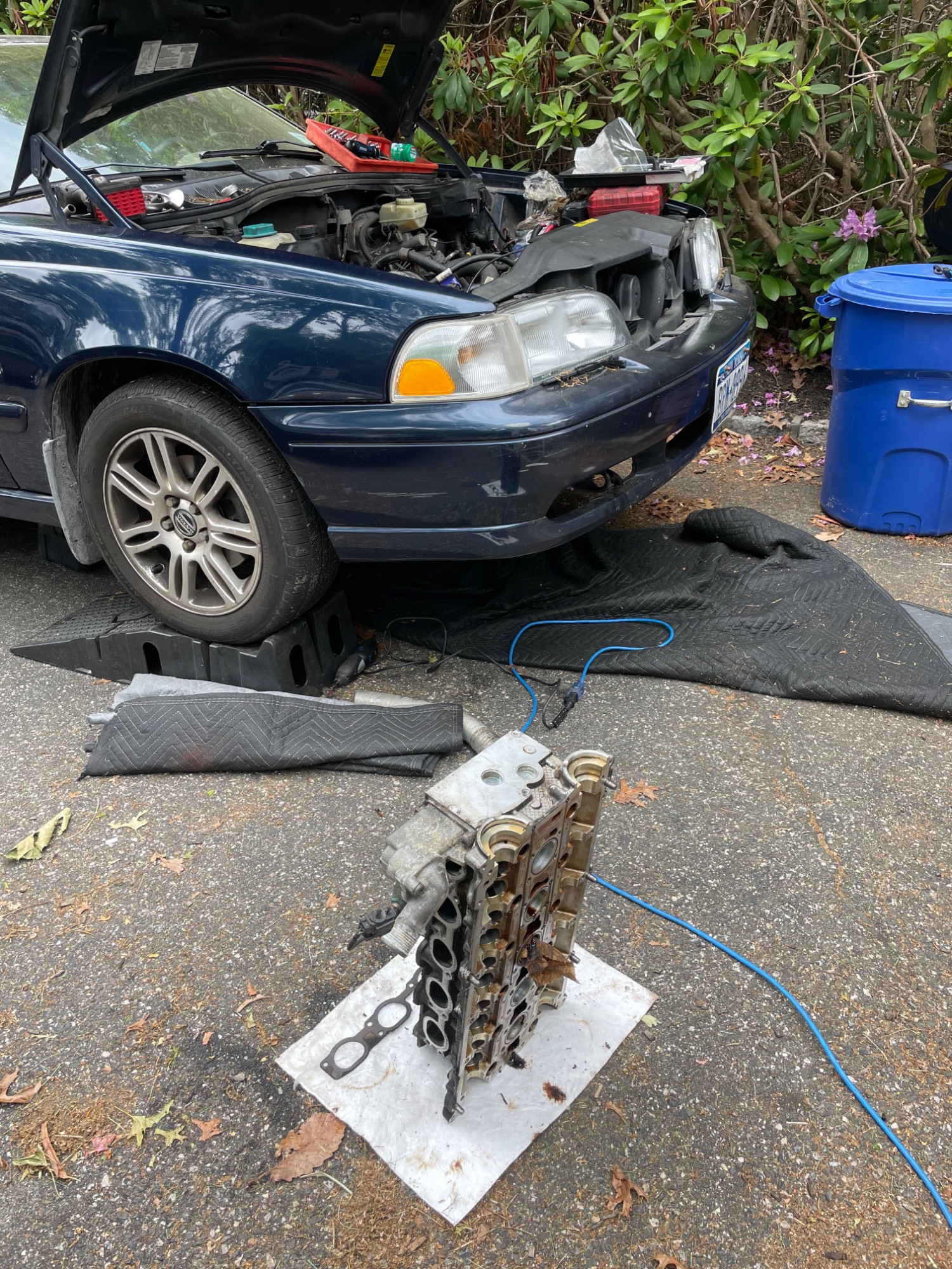

Here are the tools for water pipe m6 bolt removal. On the RN engineabscate wrote: 29 Apr 2023, 18:20 Ah, the infamous water pipe M6 bolts. It’s much easier to put it in with the exhaust manifold off the car
Up the game to some Tektron sockets for that M6 , Pittsburghs and Kobalts are ok, but they will break on a tough application
Tektron, Matco, or snap on if you are loaded
You can get a straight shot on them with the right length extension. Use a six point to get a good fit
Top, just a 10mm deep socket
Bottom, SMSLL extension plus socket.
See scale for lengths.
- Posts: 36158
- Has thanked: 1611 times
- Been thanked: 4072 times
Knocked down in 3.5 hours. Got stuck on one bad buy down pipe, so pulled the manifold off instead. THats gets head to shop, I’ll deal with down pipe later

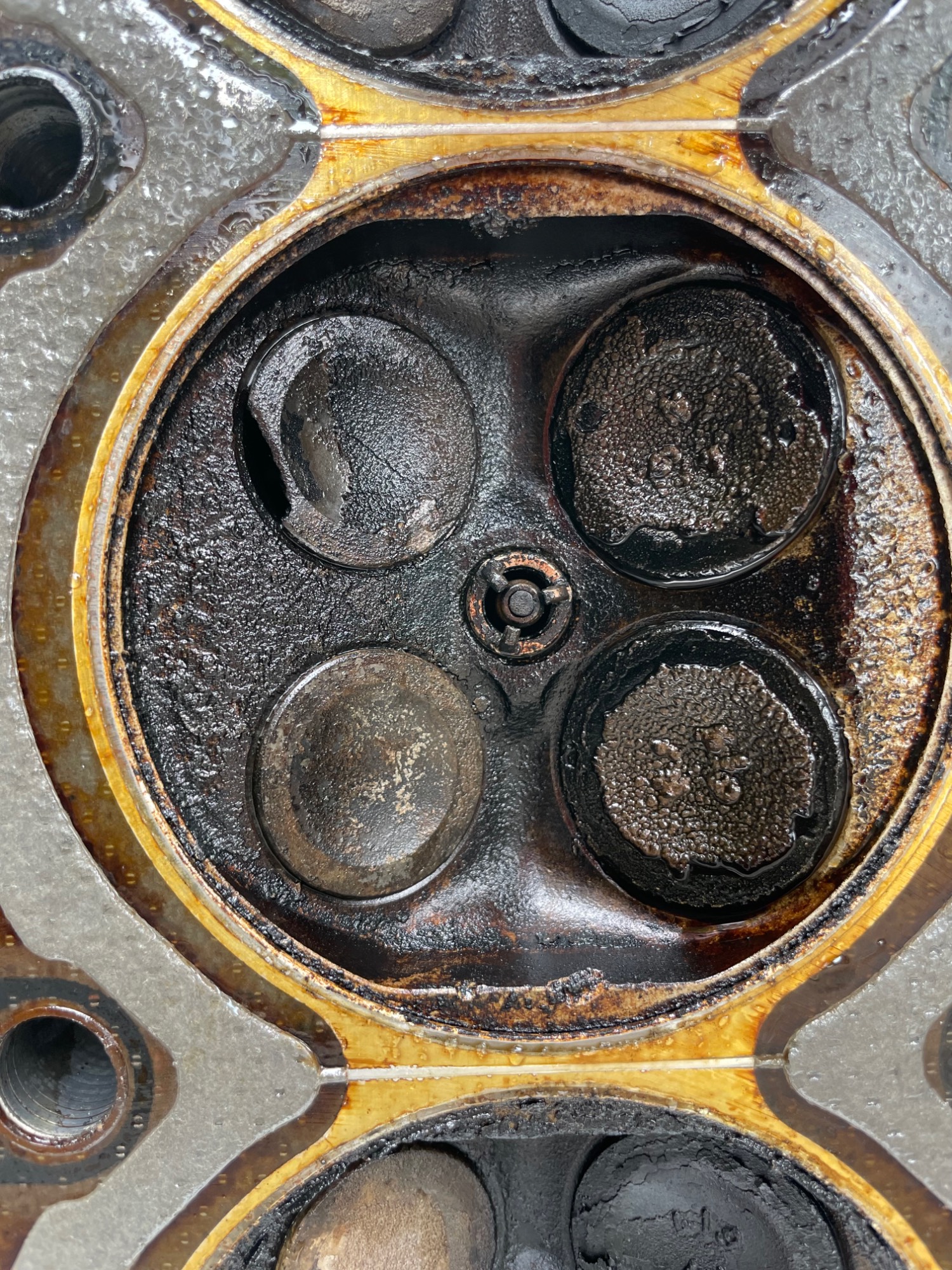

Burnt indeed

Looks like that valve is missing a chunk. Is that what we all mean by a "burnt valve"? Does it cause loss of compression?

Yes, no compression when the valves aren't closing - double so when it's partially missing. It isn't a Volvo if you aren't at least leaking from the oil fill plug gasket. =)FireFox31 wrote: 05 Jun 2023, 23:32
