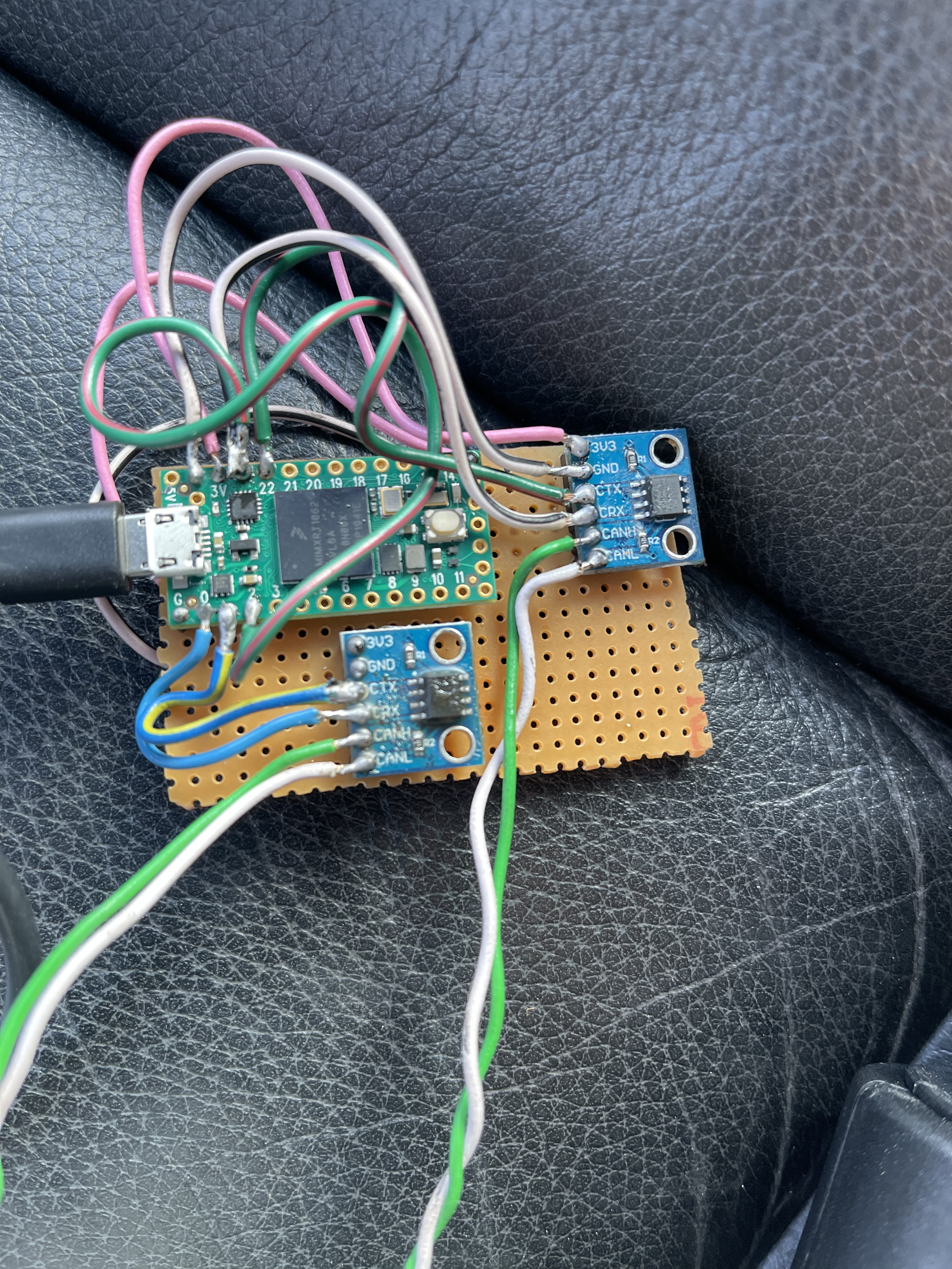

PowerMatz wrote: 15 Jun 2021, 05:39 I use the Waveshare CAN interfaces and cut the resistors for termination. Please see my photos. Should I try some other CAN interface?
1. Breadboard: An experimental model, especially of an electric circuit; a prototype.
Etymology Breadboard ( electronics ): The original electronics breadboards where literally a board to slice bread on with nails as terminals and copper wires as pathways.
2. Yours is soldered breadboard. Two steps up from solderless breadboard. The other is wire wrap breadboard.
3. What are you using for the power source? Insignificant power could be a problem.
4. Use some CAN twisted pairs between the CAN transceivers and the OBD2 connector. A twisted pair reduces electromagnetic radiation from the pair and crosstalk between neighboring pairs and improves rejection of external electromagnetic interference. In other words a twisted pair is quite compared to a untwisted pair. The wire size and twist rate needs to be balanced for optimal performance. Go get some CAN twisted pairs out of a junk car and be done with it. ( The Orange - Orange/White and Gray - Gray/White in my picture. )
5. Shorting the wires between the MCU and CAN transceivers may help. They are laying on top of each other and maybe picking up too much crosstalk. You can run some of the wires on the underside of the board and reduce the size of the hornets' nest.
If Twisted pairs and cleaning up the hornets' nest. is not a cure. Move on to the CAN transceivers.
7. Problems have been reported with the 3.3V Chinese knock off chips. If it where mine I would switch to some good 5V CAN transceivers. You tried everything else, might as well exhaust the last remaining hardware possibility.

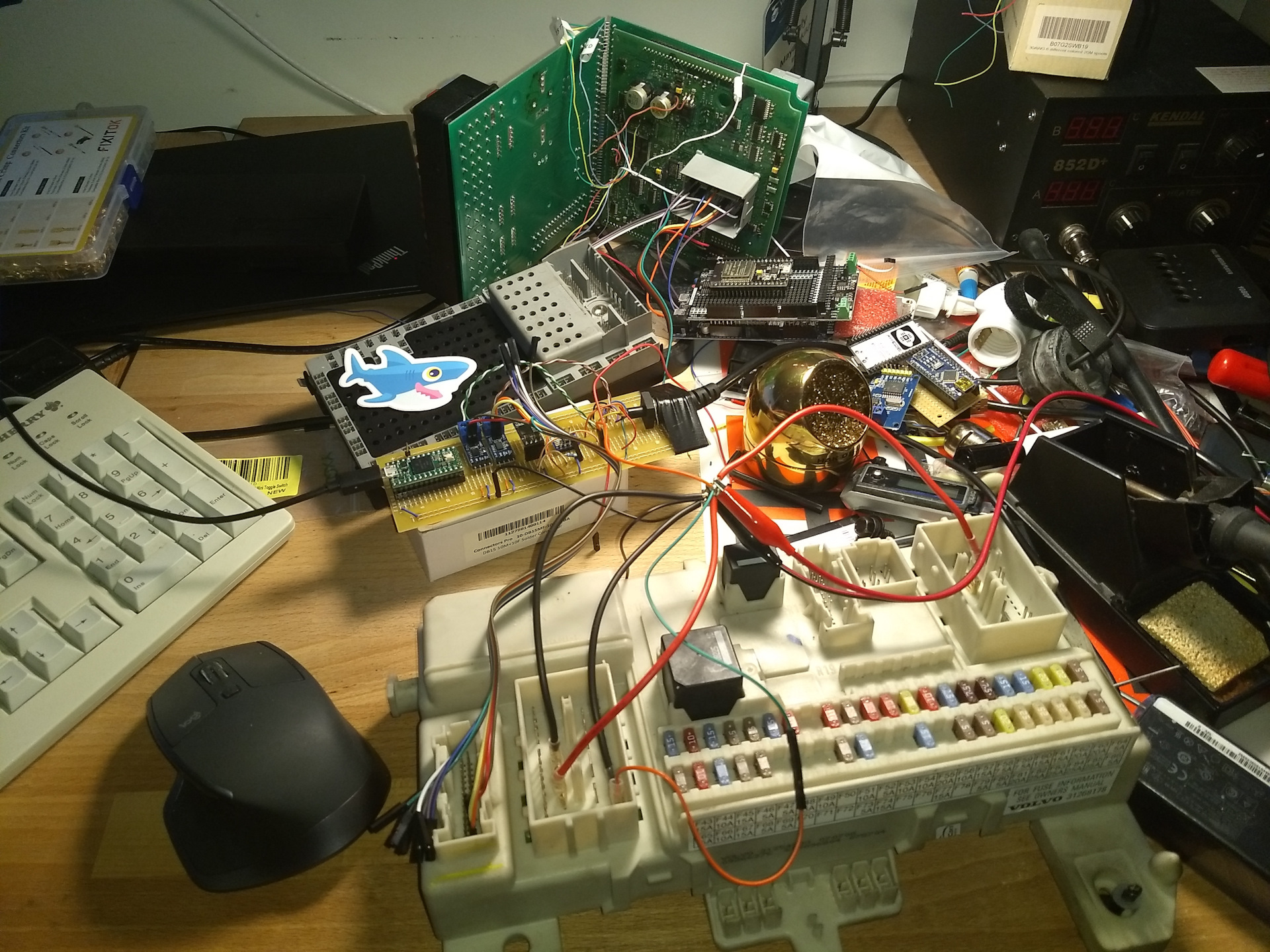

Thought I'd add a picture of where I'm at with this project. 3D printed case still to be made.
Labels on the board are for my reference.
Headers were added for all testing purposes, especially for the tft touch screen.

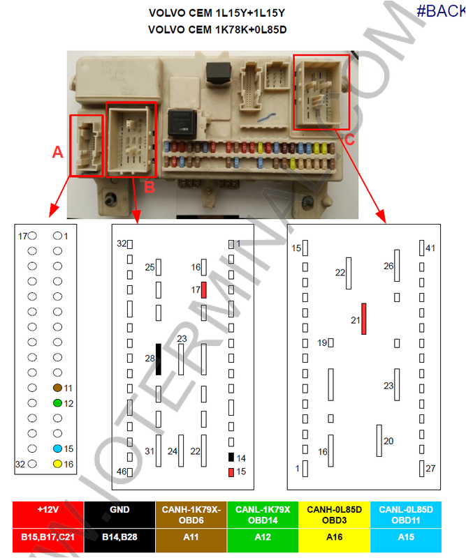

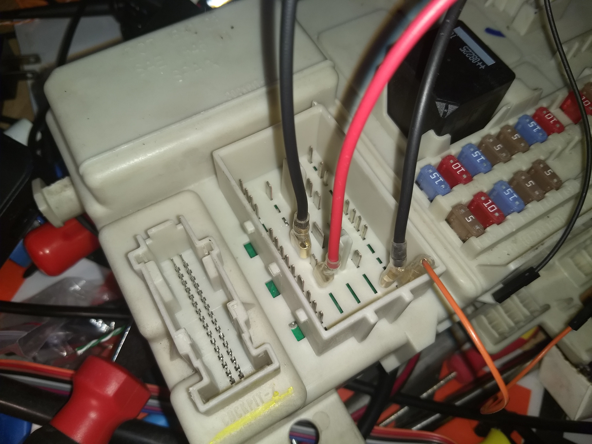

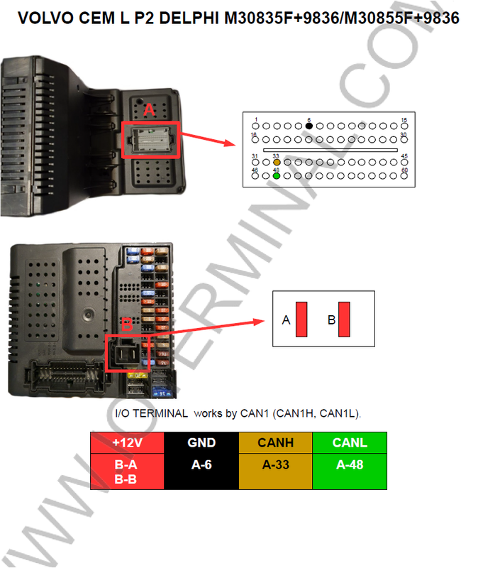

mikeak2001 wrote: 15 Jun 2021, 16:09 Is it possible for anyone testing this on P1 Cems to list the power and ground connections that they are using on this CEM. I have mine powered up and teensy trying to crack. However I never get any success.
P/N 31254903
ricked
Posts: 38
Joined: 24 May 2021, 06:03
Year and Model: xc90
Location: lowlands
Has thanked: 6 times
Been thanked: 2 times
Post by ricked »
vtl wrote: 15 Jun 2021, 17:47
P/N 31254903
use this connection and it will work, i did read 4 of them now, also i see cem-h/l on you bench this needs only 4 connections to read it

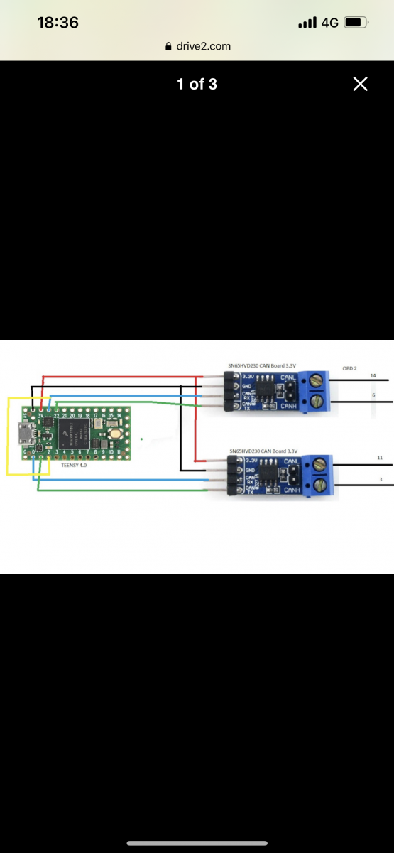

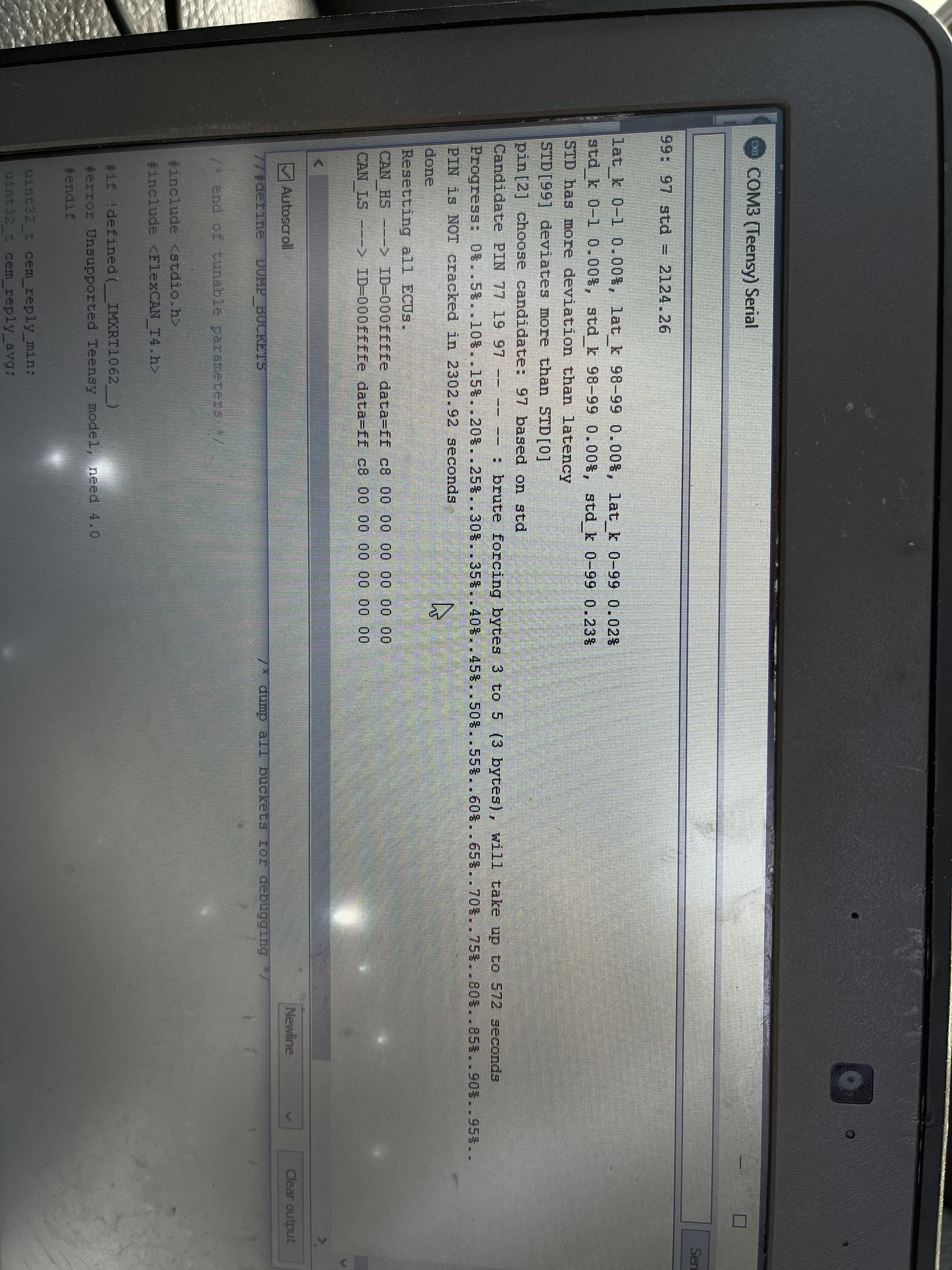

Hello, i followed the instructions and build the board as attached but i tried several times on P1 and P2 and have the same error.
Car key postion 0 on P2 when i tried, and on P1 i tried on postion 2.
I also tried with 100, 60 and 30 samples on P2 but still no results. Please help
