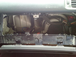

1) Start by using Ozark Lee's instructions to release the glovebox arms and remove the glovebox. Then you'll see this:
The two screws on the "face" where you'd just removed glovebox screws hold in the shelf/panel below. You *can* remove them without removing the glovebox door. But it may be easier to just remove the door -- 4 screws and they are torx 25 just like everything else. ( If you are female (I am), I HIGHLY recommend removing the glovebox door. Otherwise your...assets...will keep encountering it every time you try to shift around to look at something or tug on a panel or some such. Not as uncomfortable as a mammogram, but distracting, and taking the door off only took a minute!)
Once you have removed those screws, start to pull the panel down then out. It'll look like this: You may have to reach down and separate the panel and the carpet a bit -- mine was kind of wedged. (If you still have the glovebox door on, this will be much harder. Ask me how I know. Ouch.)
