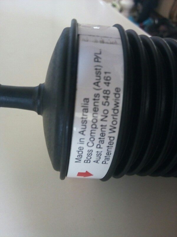

Can't believe nobody mentioned these Magnefines are made here!!
It arrived yesterday and will be fitted later today. Finally we have our tow car back as T5 is the only one with a hitch.
