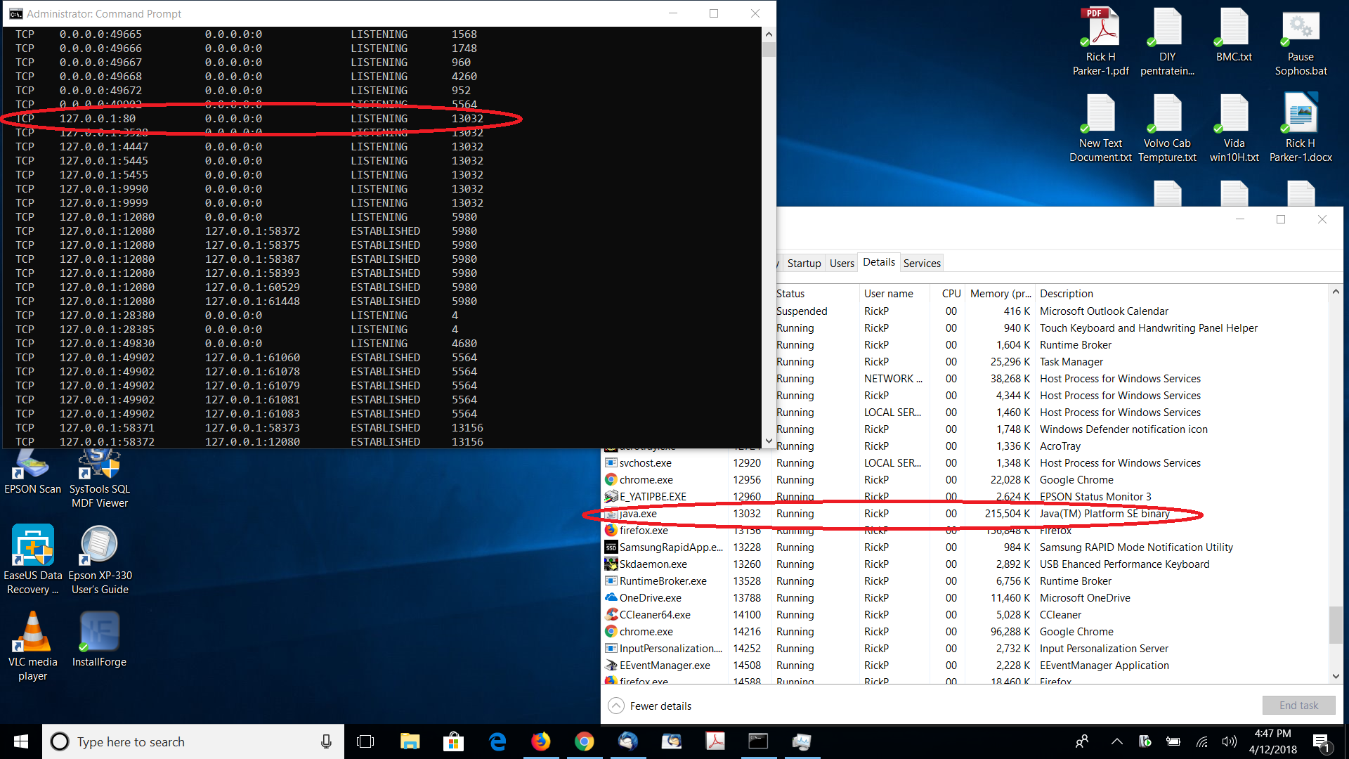

In Windows 10 it is often W3SVC (World Wide Web Publishing Service) service or Skype.

I checked that last week. With Vida disabled in the startup items the port is unused. With Vida running green it's in use by java. If I ever see that problem again I'll check port use instead of just reinstalling.RickHaleParker wrote: 12 Apr 2018, 00:46 In Windows 10 it is often W3SVC (World Wide Web Publishing Service) service or Skype.

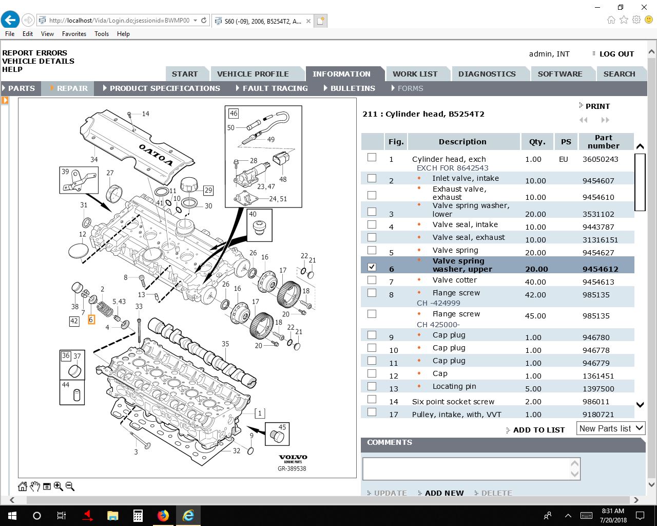

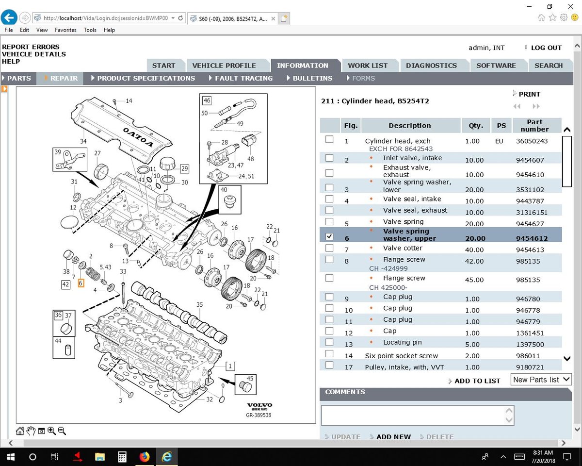

Mr Brain, My install with IsoView 7.3: In the parts section, the reference numbers do not show in the exploded diagrams. Is it the same on your install?

That looks to be working on mine. If you're talking about a different area/function in VIDA, please specify.RickHaleParker wrote: 20 Jul 2018, 03:53 Mr Brain, My install with IsoView 7.3: In the parts section, the reference numbers do not show in the exploded diagrams. Is it the same on your install?

That is the right area. Thanks that tells me it is something on my machine.
