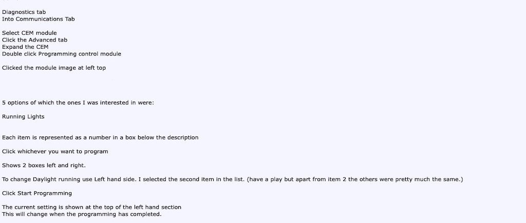

Does turning off DRL's involve some computer voodoo or a simpler way?

I think VIDA is required unfortunately.SOURDOUGHJIM wrote: ↑04 Oct 2023, 08:58 Does turning off DRL's involve some computer voodoo or a simpler way?

OK. Wrong section. There is a P2 video on Youtube. That shows a computer to switch off:

My 850 had the screw on the switch, the V70 needs diagnostics to turn off
There are several methods on Vida depending on year model, this is for the facelift cars

In P80 platform there are variations across markets amd even regions. I believe US gets the DRl switch on front plate,( actually technically, rear of switch, visible to driver) Canada gets it hidden switch under dash
P2 is all VIDA driven

A good scanner is required. I am able to do it with a foxwell scanner with the Volvo liscense. Does not require a software load or purchase, it’s just a configuration switch. A dealership should only charge you for the time to do it.bmdubya1198 wrote: ↑04 Oct 2023, 14:04I think VIDA is required unfortunately.SOURDOUGHJIM wrote: ↑04 Oct 2023, 08:58 Does turning off DRL's involve some computer voodoo or a simpler way?
