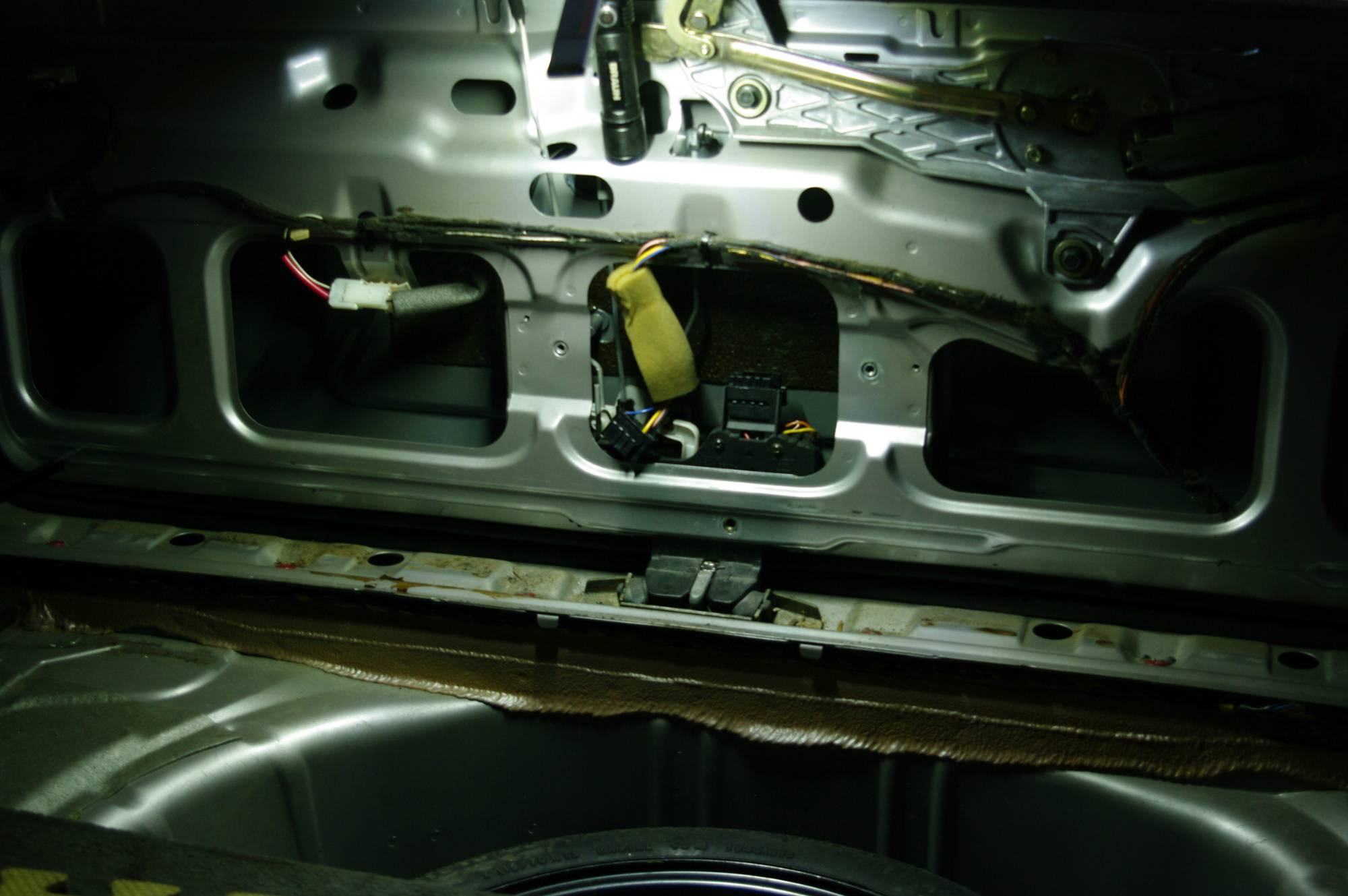

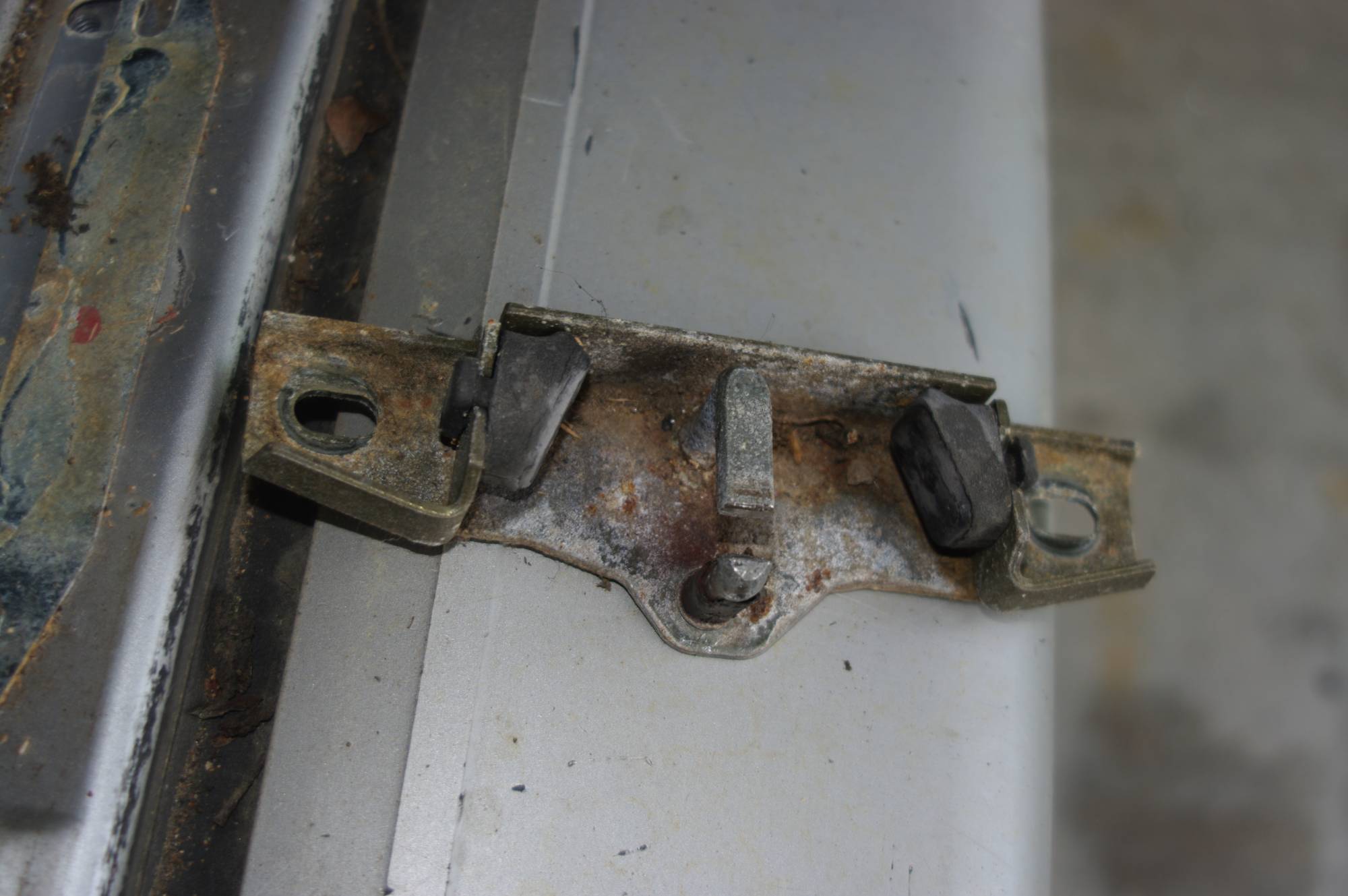

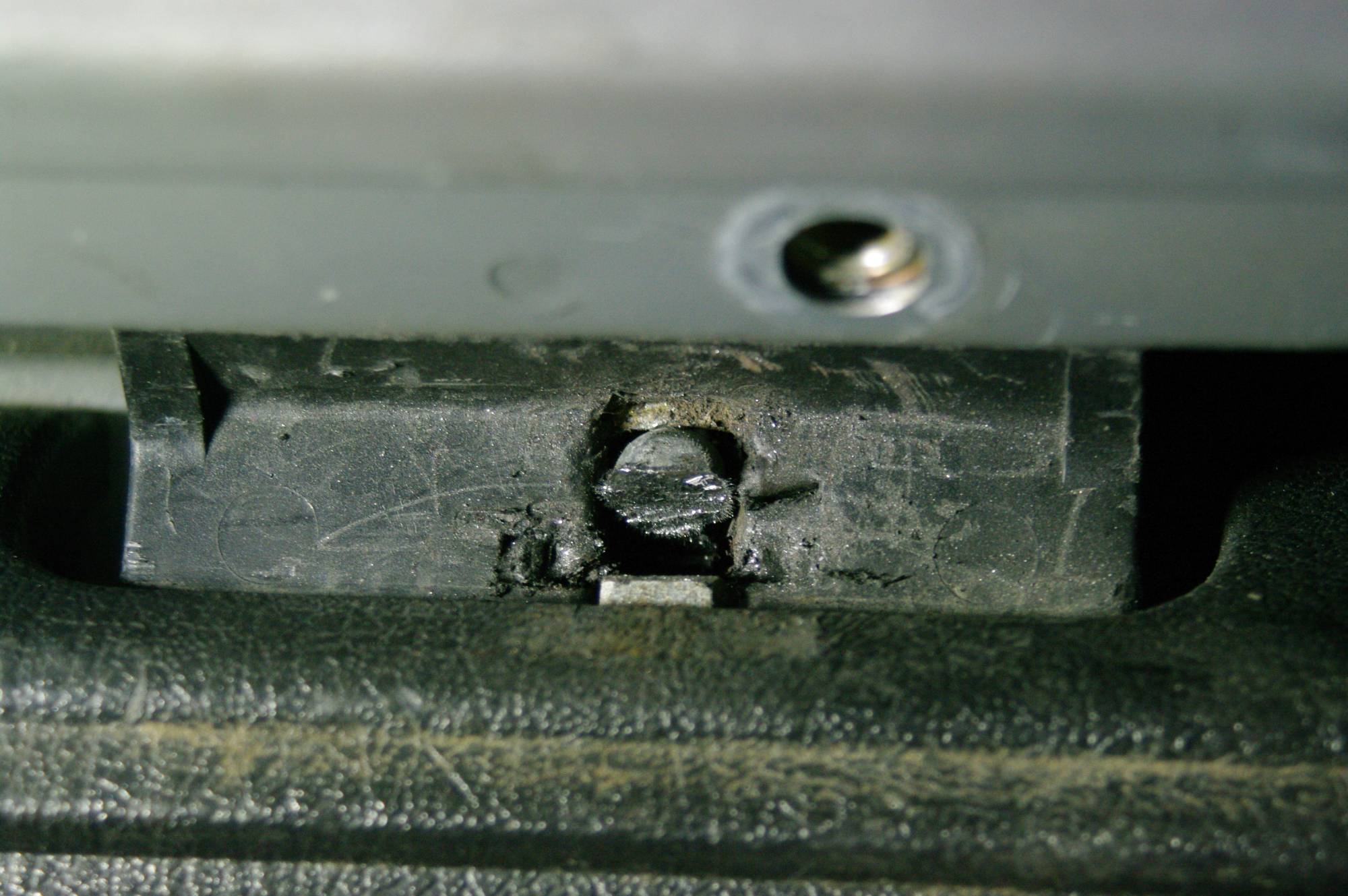

Just went through the very thing.
As Neil mentioned, the clips/brackets are likely already in various stages of failing, so once you get the latch surround mentioned off, you really do just have to start tugging on it. Mine was repaired by a previous Technician with 8 nice, long sheetmetal screws. It was an extra challenge. I took the rearmost floor panel all the way out, but left the middle one with some padding to lay on.
Then careful work with a Dremel. A stout straight blade screwdriver was sacrificed, using a medium hammer, to influence the latch post apart.
You can wrestle the plastic sill cover off and get to the torx screws holding the post down, but if you don't do the surgery with it still firmly attached to the car, you won't be able to get the latching mechanism out once the tailgate is finally open; I guess you could do it in mid-air, but that would be pretty awkward.
The should be no children nearby when you do this. There will be salty language.

Read the link(and link therein!) from Neil - you can do this without cutting or ruining anything (except old brittle plastic).
1 - unbolt "post" from body, no need to remove any trim for this step, open hatch
2 - remove the surround/cover from the hatch
3 - flip the levers on the latch to release the post, it is not difficult to do "in midair" you just need to figure out how the latch mechanism works

I don't understand which 'levers' you mentioned. Perhaps a picture would clarify.erikv11 wrote: 15 May 2022, 09:58 Read the link(and link therein!) from Neil - you can do this without cutting or ruining anything (except old brittle plastic).
The original poster seems to be saying that his latch has failed in the locked position, as did mine. There isn't a workaround that I know of, and even with the latch on my workbench, it will not budge. When I get some time to tinker, I will dissect it further, but stuck means stuck - in my case, anyway.

It was over 8 years ago and I didn't take pics and for sure have no detailed recollection, certainly no more detail than already in those linked threads. Or maybe you have the older style (-98) rather than the newer style (98-00), although your pic sure looks like 9187990 (newer).
But yes, in my post "figure out how the latch mechanism works" may be more relevant than "flip the levers." "Levers" refers generically to moving parts of the latch mechanism. You'd have to tinker. May be more challenging now that it is out of the car and disconnected from the linkages.

Happily (but sadly for those with similar issues), I was able to get the thing open one more time by repeatedly actuating the unlock lever on the driver's side door. The latch was falling the hell apart inside, it's no wonder nothing worked anymore; the parts making contact with the hatch open sensor microswitch were worn away and shredded, half the attachment points for various rods just snapped, and so on. It's a miracle the thing worked at all. New one's installed and working perfectly, though one of the big Torx bolts holding it to the tailgate was missing, so I'm gonna have to find another one at some point.
Thanks everyone for your help and input here.
- Posts: 15499
- Has thanked: 2205 times
Glad you were successful. Do get that Torx screw ASAP or it may break again!
