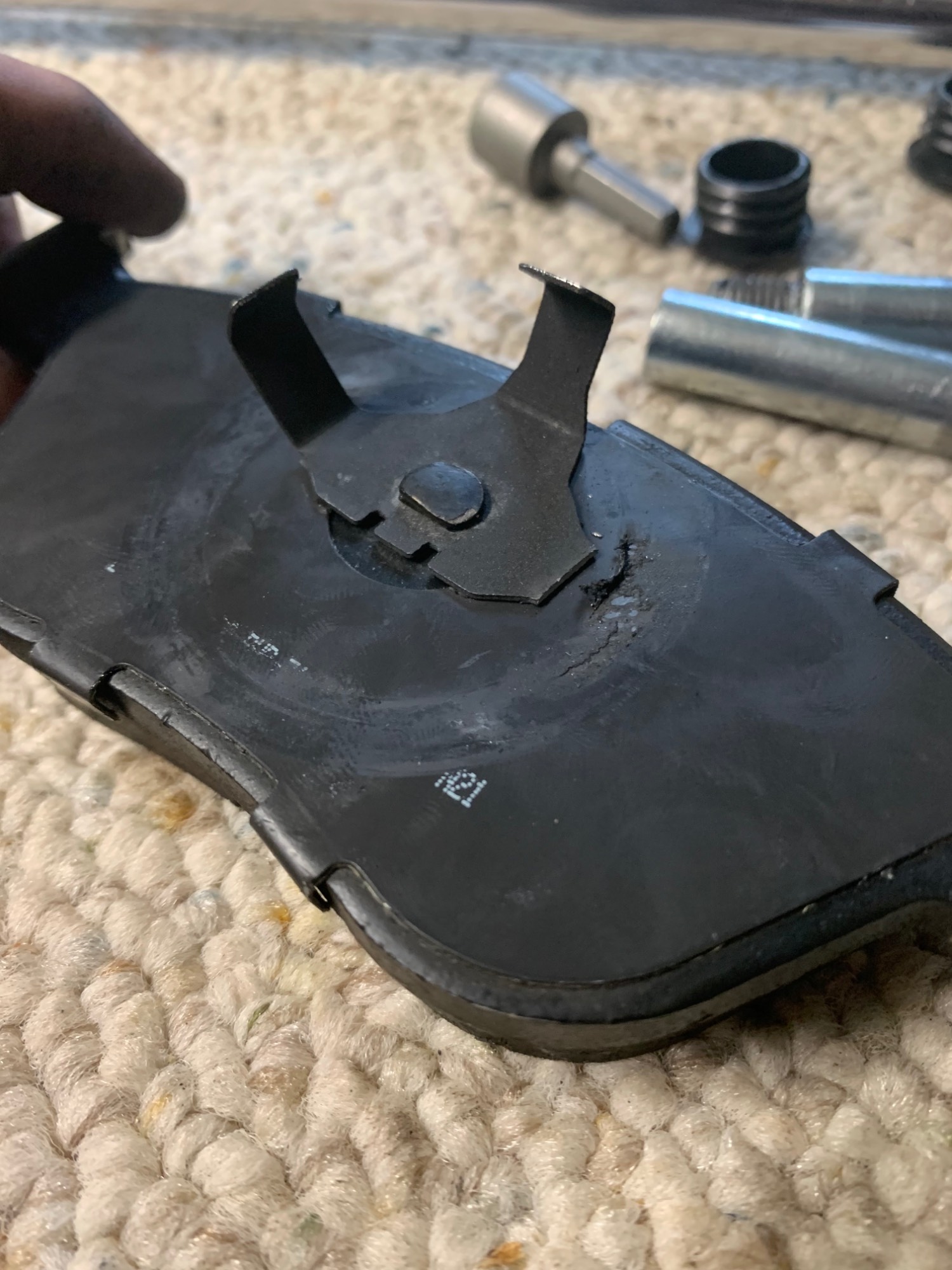

Looked at the inside pad and saw this, since one part of the clip was missing I think it would get stuck in reverse.
I took off the other clips so that it would work. Even after taking all the other clips out, the problem still occurs. I have next to brand new rotors, pads and calipers. I’m planning to just take out the pad tomorrow to see if it will still happen, then I will investigate the caliper.
Volvo 2000 S70 SE
- Posts: 15486
- Has thanked: 2199 times
Those clips are there for a very good reason to stop the pad floating. Those springs are to keep it in place flush with the caliper piston. You have to be careful installing those springs. I have never seen one break off before. If you swap that pad to the other side does the wheel lock up over there instead?
