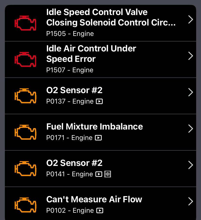

Hey guys, just picked up my first Volvo after riding around in my friends' for years. Runs great except for two things. I'm hoping for some help on here because after searching through every Volvo forum I can find I've come up blank. When I'm over about half throttle in 3rd gear, right at 4k RPM there's a power cut. It's very consistent with only happening at 4k RPM, but not about throttle. It drops maybe 100-200 RPM, then usually goes right through 4k, sometimes it stutters twice. Boost does not drop as far as I can tell (Automatic). Sometimes I'll be on it almost floored and it's fine, sometimes it happens at 1/3 throttle. Seems maybe to be dependent on engine load, as it generally happens under less acceleration when going uphill, but I also wonder if it could be fuel delivery.
My main question is, does anyone know what the car could be doing that makes it happen only at 4k RPM? Is it ECU related? Is that when more fuel is dumped in and I'm leaning out, and it cuts fuel because knock? The other thing that may be related is it rough idles and wants to die on a cold start. After warming up it's fine. I cleaned out the IAC really well, full can of cleaner and a compressor. Lot's of nasty stuff came out. Could this be MAF? The car starts up with it unplugged... I should have my hands on a new one in a few days but I'm wondering if there's something else I should order.

It was the plugs! Replaced cap, rotor, wires and plugs. The rest were needed, especially the wires since they fell apart during removal, but the plugs were the source of the issue. Now to deal with the fact that my turbo is underboosting now -_-. Thanks for the advice.
