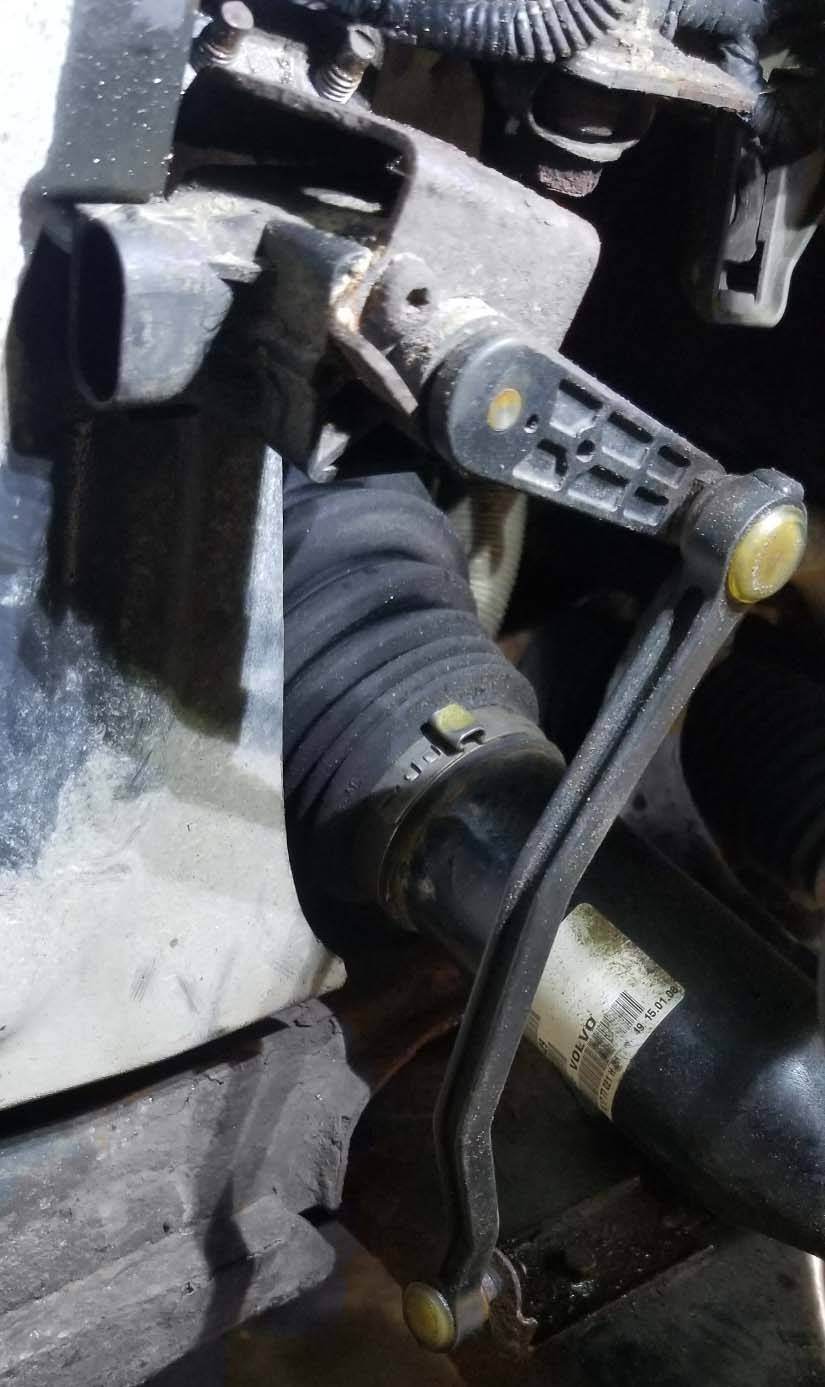

I have had a moaning and groaning issue from the front struts on my 2008 XC70 for a while now. From what I had read, this can be caused by the strut mounts. So, while I was taking the struts out to do the mounts, I figured that I may as well do the ball joints, tie rods and sway links. Needless to say, it was a fun Sunday for me. Got everything back together and much to my shock, the creaking was still there.
After a bit more investigation, I found that the headlight leveler linkages were seized and causing the issue. The way that they are mounted, amplifies the sound to make it seem a lost worse than it actually is. I pulled both sides out and spent an hour with penetrating fluid and white lithium lube getting them smoothish again. I would like to have put new ones in, but the linkages are not available alone and Volvo wants a car payment per side for new ones that include the sensors.
Now the car feels like brand new again.
