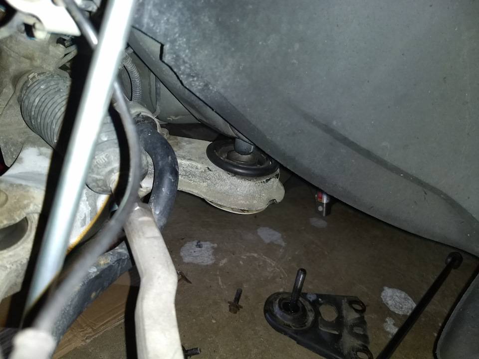

Post by vtl »
Between frame and subframe, around bushing.
vtl
Posts: 4728
Joined: 16 August 2012
Year and Model: 2005 XC70
Location: Boston
Has thanked: 114 times
Been thanked: 606 times
Post by vtl »
Here's the picture:
