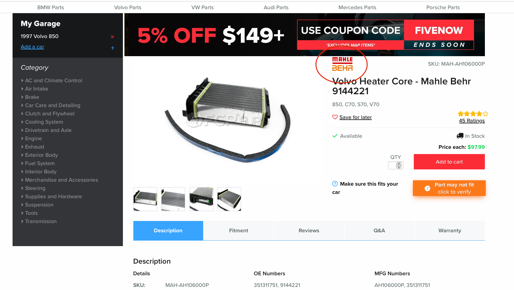

I put a Behr in in 2014 and it's been going along fine with no issues noted since then -- plenty of heat and no loss of coolant noticed. I see that FCP lists Mahle and Behr as the same company now:
https://www.fcpeuro.com/products/volvo- ... 70-s70-v70
- Posts: 36145
Behr made the original Volvo part, but that doesn’t mean todays Behr is the same. It’s a grizzly job on a polar cold day.
